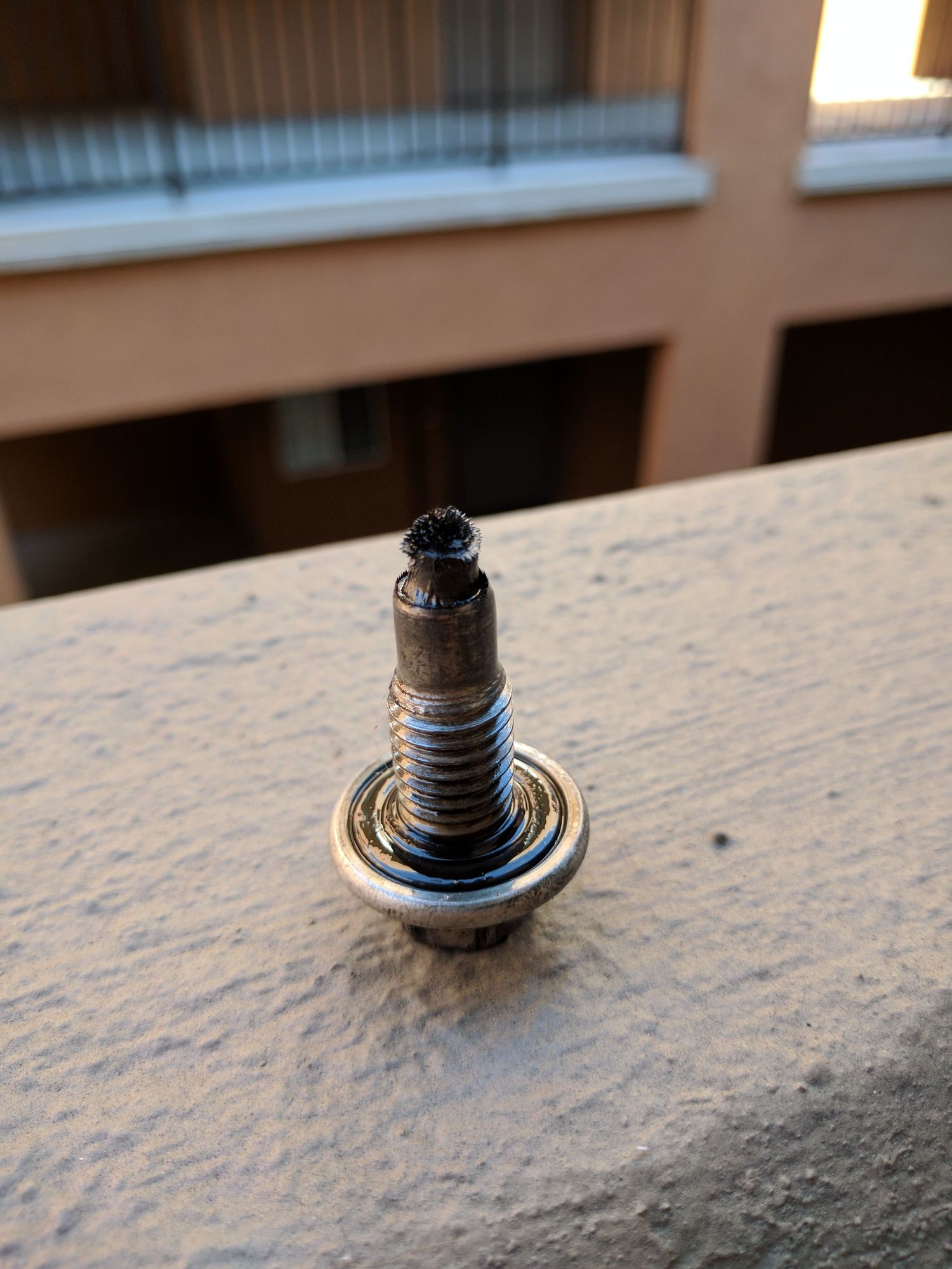

While doing an oil change today I found some oil shavings stuck on the filler plug magnet. I know some metal fuzz is normal but this is more than I've ever seen before. Besides the obligatory LS1 piston slap, there's no noise coming from the motor. Oil pressure is very healthy too: 40 PSI at idle and 60ish going down the road. 84000 miles on the clock.
Now the question is, do I go ahead with the 0w40 Mobil one I was going to use or should I use a heavier grade like 20w50 or 15w50 since these shavings could've come from the bearings?

looks normal to me, i get about that much shavings on my drain plug every oil change lol
mobil 0w40 is great stuff also!

This is normal and why the put the magnet there.

Don't change anything. I got almost that same amount on every oil change on my 427ci....the damn thing ran for 173,000 miles. Theres no engine that doesn't lose metal every time it runs.
If that much is on the magnet....there's 5 times that much everywhere else......

OK. Glad to hear this! This is my first oil change on my first LS1. Have had LT1, 2JZGTE, and 1UZ, all of which always had squeaky clean oil.

Looks like mine. Bought the car with 10,000 miles on it and the first oil change had me stumped. I'm glad to hear its normal.

They often look like this. I was shocked, at first, because I was used to cars without the magnet! Years of ignorance just flowed right by me.
These are the things you need to worry about...

Ah - I missed that text as it's right on top of the picture.
Shavings stuck to the magnet are not from bearings, Bearings are not magnetic. That's ALOT of material IMO most likely places that would come from is the cam-lifters-rockers-valve tips or timing chain-sprockets. I've owned many LS cars and never seen anything like that on my magnets.

I'll have to agree and say that my A4 car has 152k of which I've put on 120k. I've always changed my own oil but I've never seen anything like that. Same with our G8 at 50k.
The other two LS1 Firebirds I've owned have been occasional use cars, but I have not seen the likes of this in the 5-6 oil changes I've done on them.
