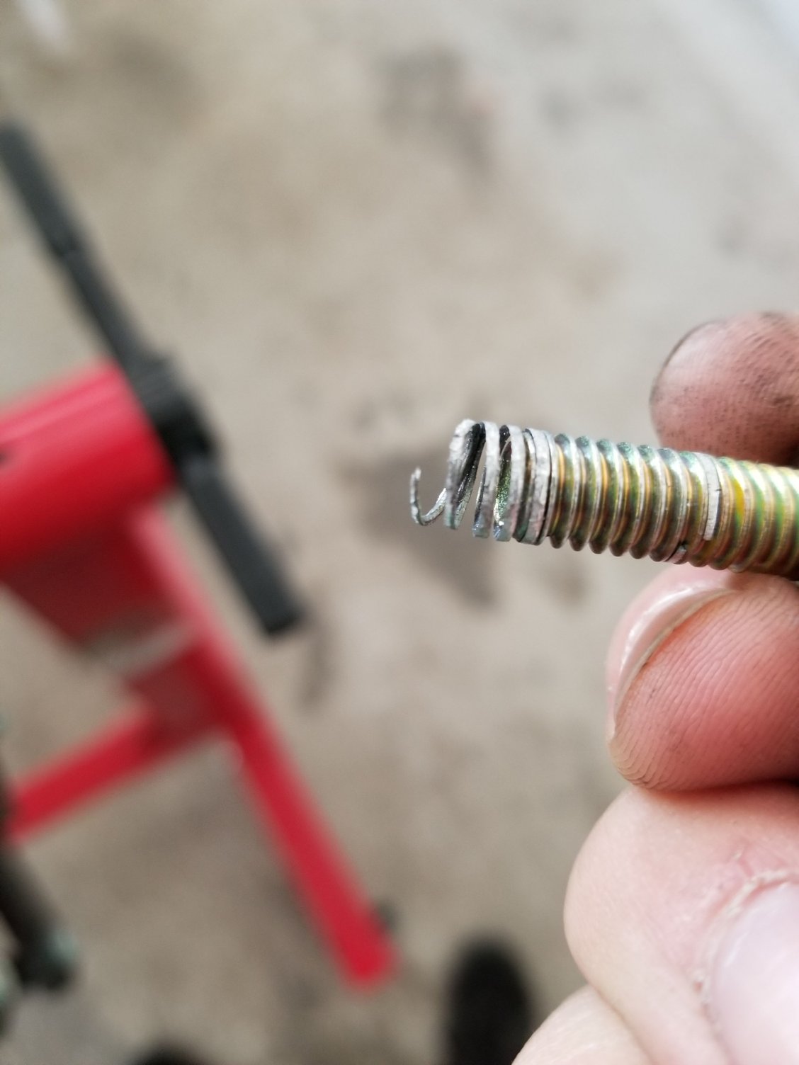

Hello everyone, im needing some advice i had a bolt hole strip out on my edelbrock super victor intake today where the tb bolts to it at , i followed the reccomend tq specs. The other 3 was fine just this one let go any advice what i can do i heard of helicoil but ive never done it i mean worse comes to worse i could take the manifold back off and take it to the machine shop. Thanks everyone.

Update! First off thanks everyone for the help, okay so originally what happen is i called the company i ordered it from (not saying the name) and there recommended tq was 18-22 grade 5 bolt 22-23 grade 8 bolt ft lbs if using forced induction as i felt that was way to much i tried 18 with the grade 8 well as we can see that was NOT ideal, the 4th one stripped out (bolts were correct length) and as of yesterday i had never used a helicoil, one of the maintenance guys at my work let me borrow one so today i put a helicoil in it and it (wasnt bad at all) it worked great, i probably could have just tapped the hole bigger but already had the kit so figured i would go for it this time though i didnt use a tq wrench i just tightened them up good with one hand with a wrench not going crazy on it. Thanks everyone for the advice.
