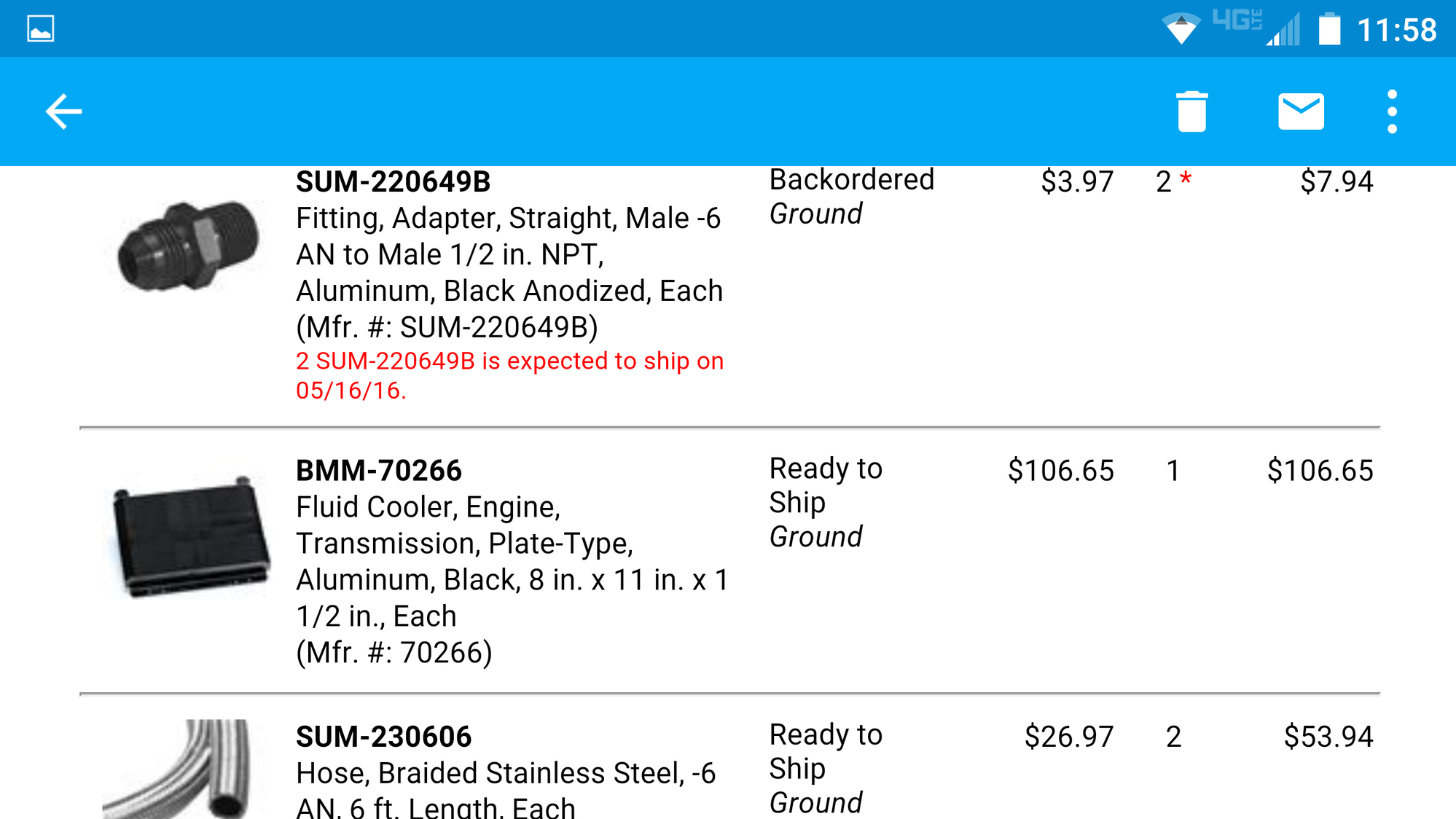

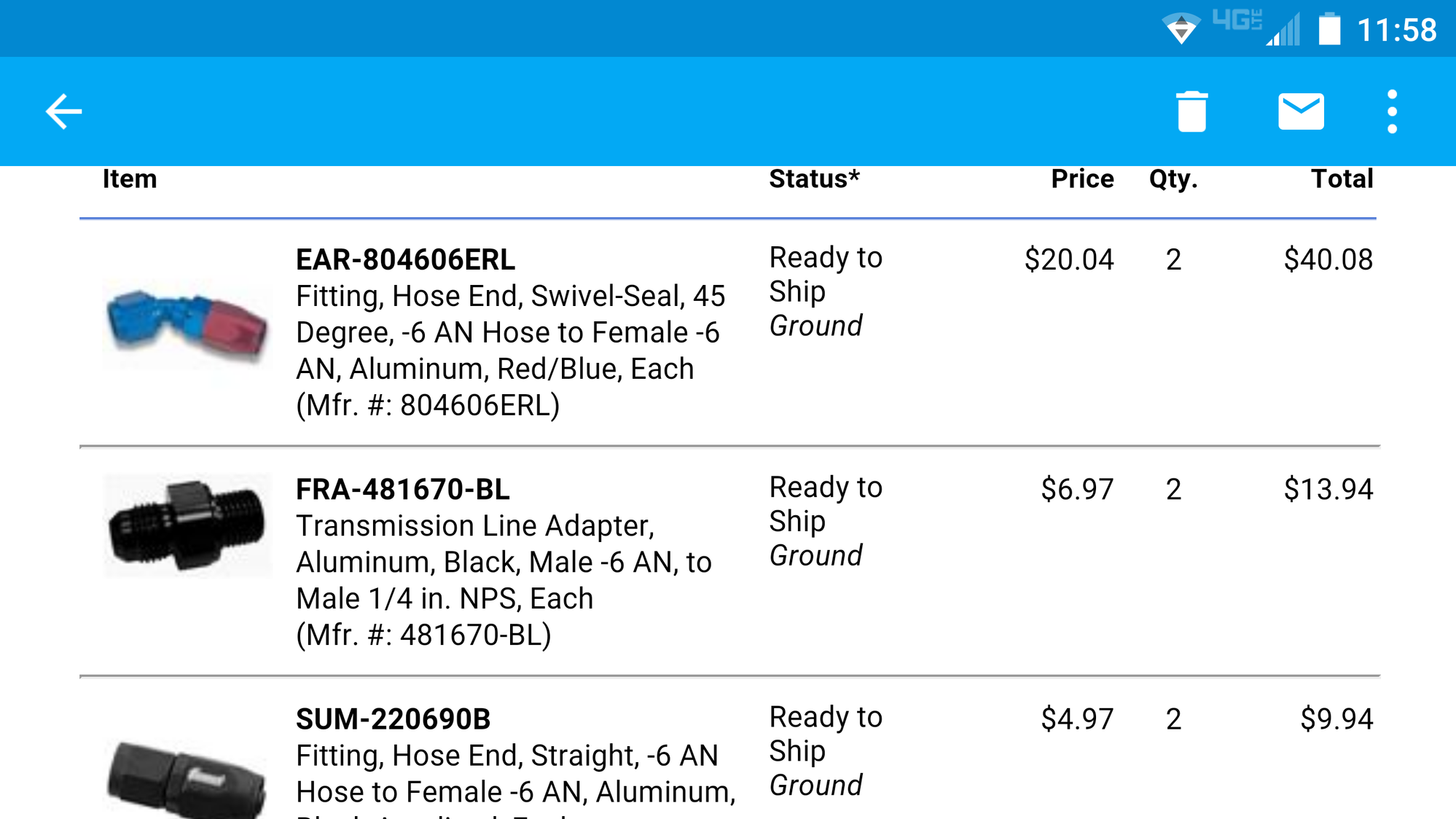

Originally Posted by LS1121
damn good idea! Thank You. Any suggestion for an affordable kit?
This is my setup parts list to give ya a idea. You could probably do it cheaper but that should give ya a direction.
