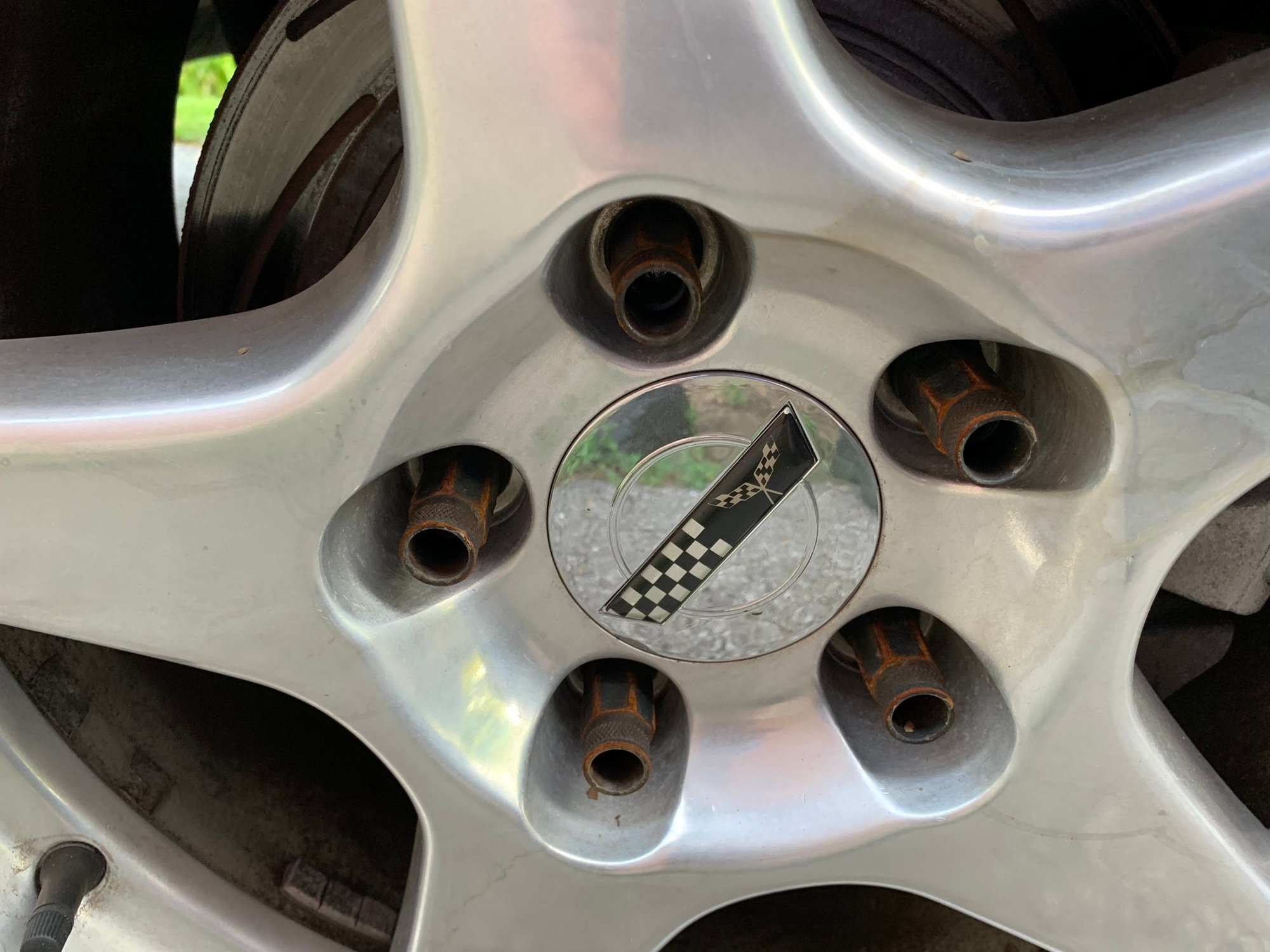

My question is this...the steering seems a bit tough/tight or slow in this car. Is that normal? There isn’t any whining like the pump is low on fluid or anything. I did notice that the last owner must have swapped out the factory 16” rims for 17” rims all around. I can’t tell if they are the factory SS rims, different Camaro rims or maybe Corvette rims. I’ve included a pic of the rear rim and a close up of the center. All of the rims and centers look like this.
However, I did notice two different sized tires on it. The fronts are 275/40ZR17, which would be the stock tire size for the 17” SS rims. The rears are 245/45R17. I don’t know why that size was chosen. That shouldn’t affect the turning of the front tires, right? I’m just wondering why it seems tough to turn compared to other cars I drive. Almost like the power steering is turned on like 80%.
Plus I’m curious if these are factory rims off another year Camaro or Corvette rims. Any way to tell?

Those look like corvette zr1's. The rear tires are Blizzak snow tires, which do not run wide. I run 275/40-17s on similar wheels and steering feels fine. I don't know how good those Blizzaks are at handling turns, etc, but I would get 275's for the rear to take that out of the equation.

I appreciate the info. Ironically the Blizzaks are on the rear rims. Those are the ones that are 245/45R17's. On the front are Sumitomo's that are 275/40ZR17. :-) I also thought that the rear tires (the Blizzaks) seemed to be a bit small (width wise) when I looked at them). Then I saw the size compared to the Sumitomo's on the front and it made sense. The Sumitomo's look normal compared to the Blizzaks. They seem to be "bowed out" to me, meaning they are too small of a tire on a wide rim. Plus, on looking up rims and such, they appear to possibly be 1997-1999 Camaro SS rims that are 17x9. I think they replaced the center caps to ones that look like a Vette. Or, as you said, they may be ZR1 rims with the factory inserts.
