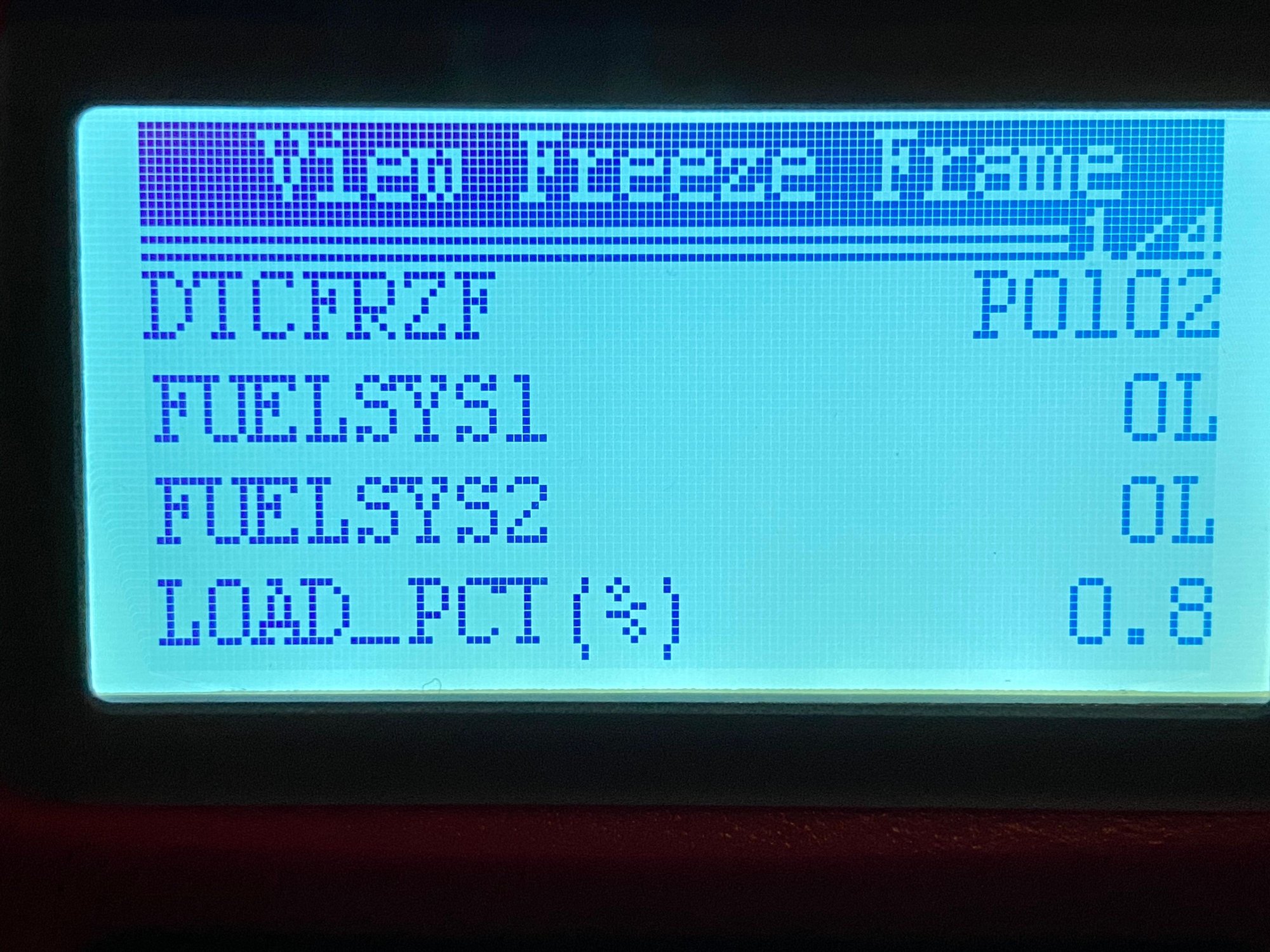

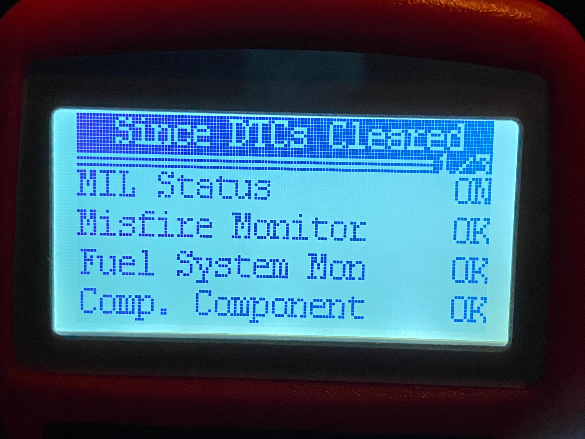

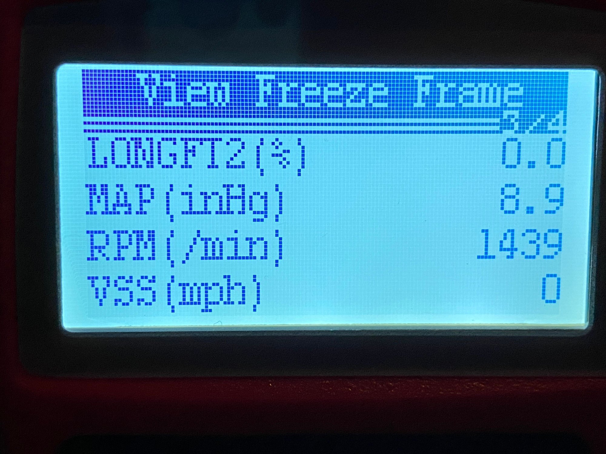

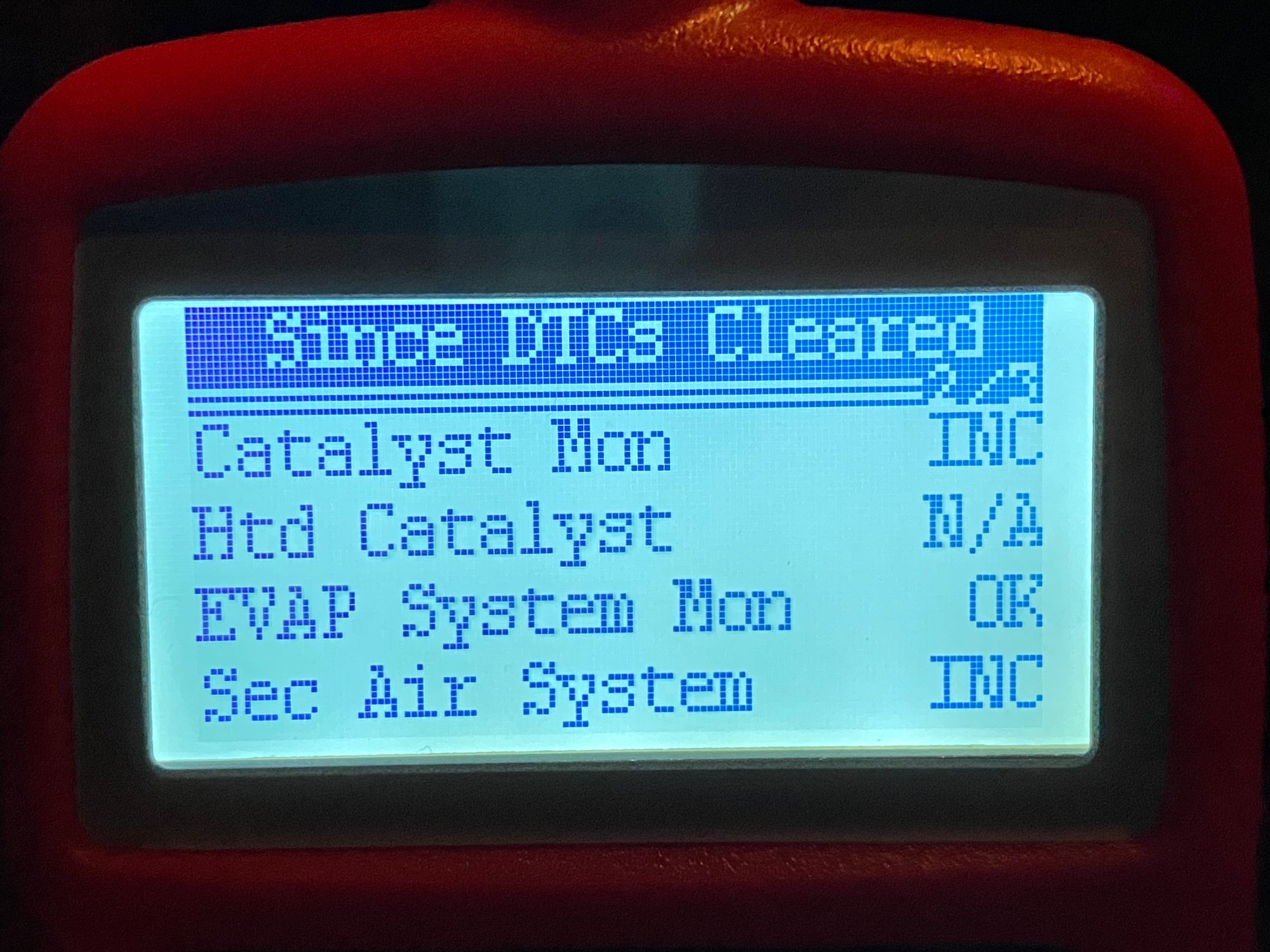

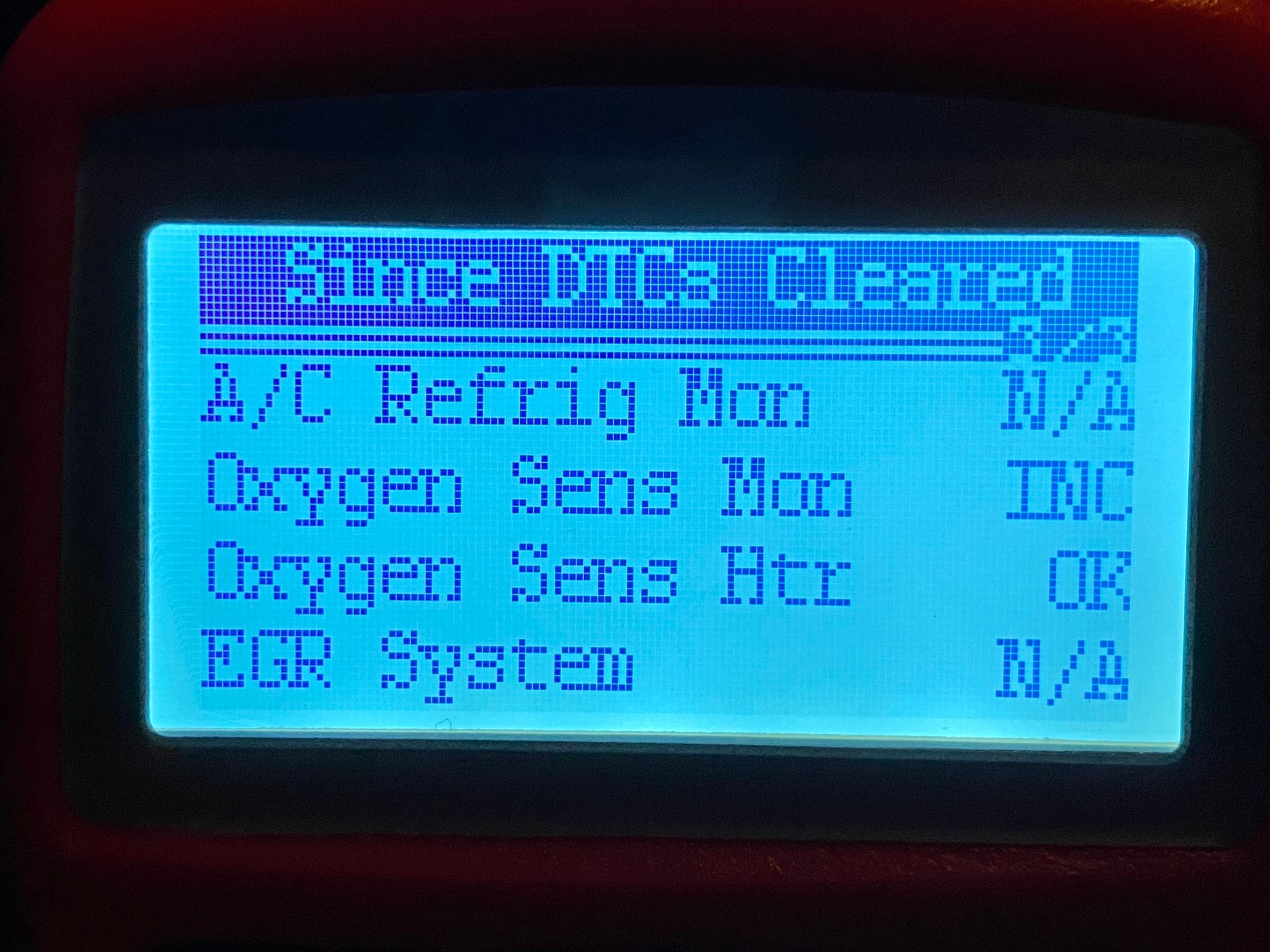

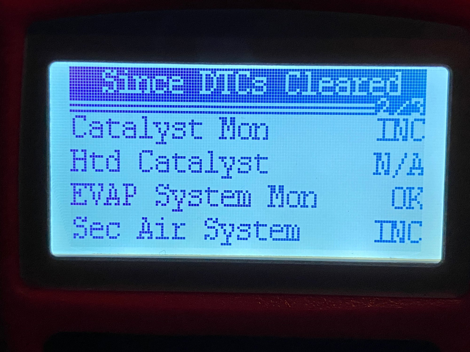

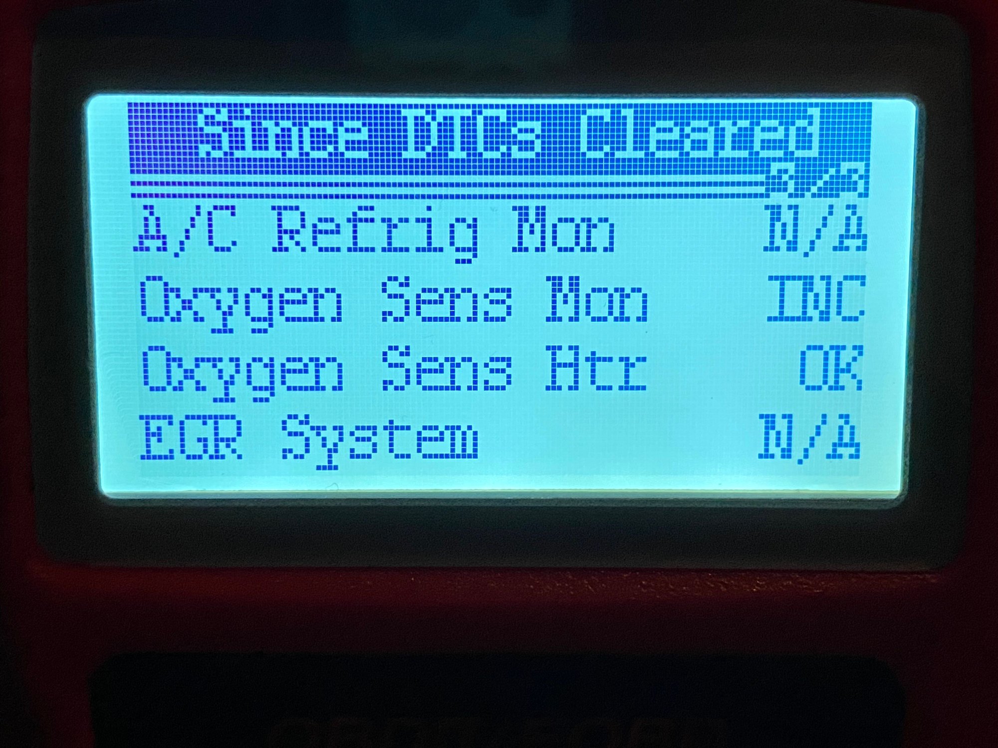

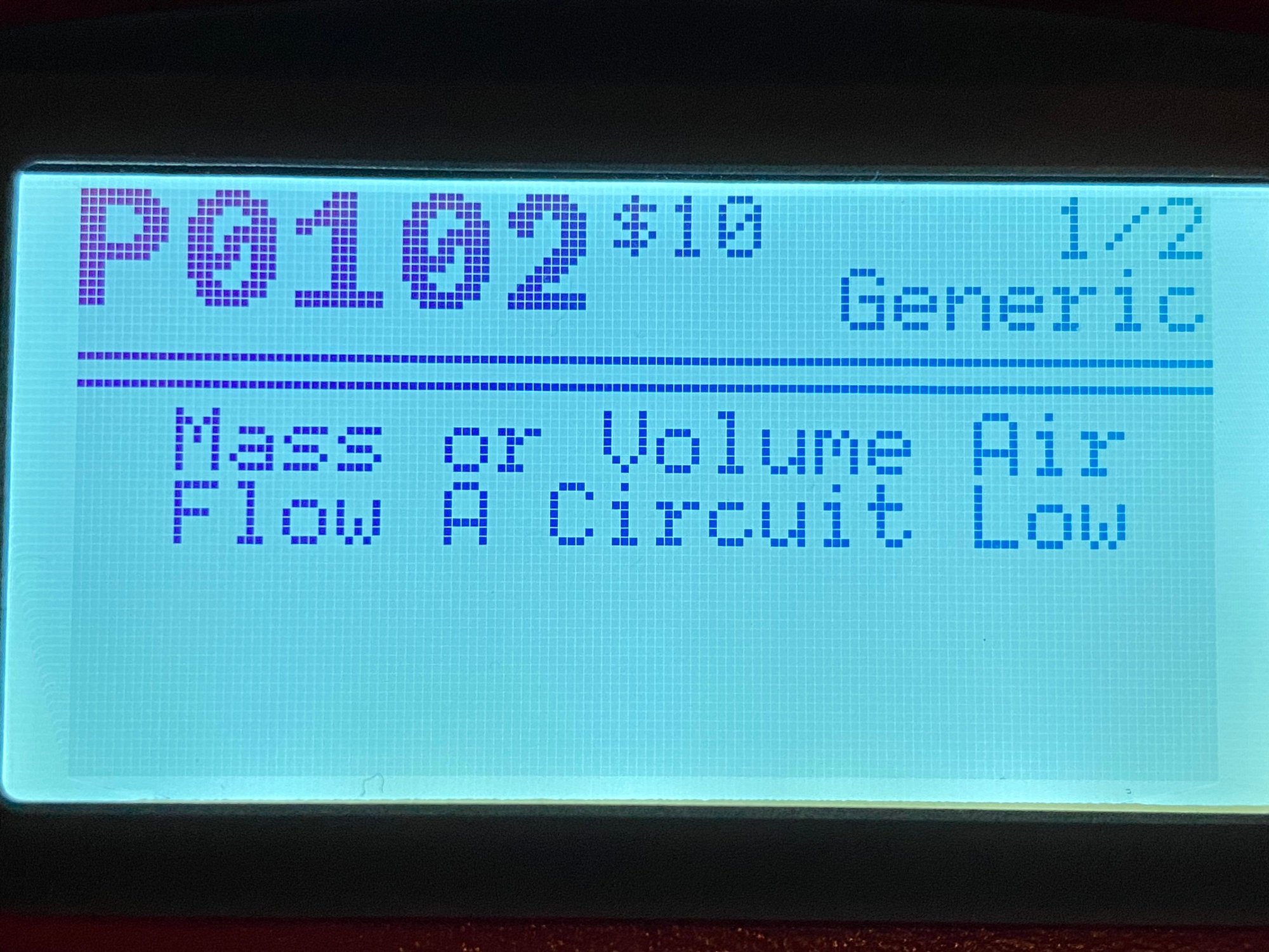

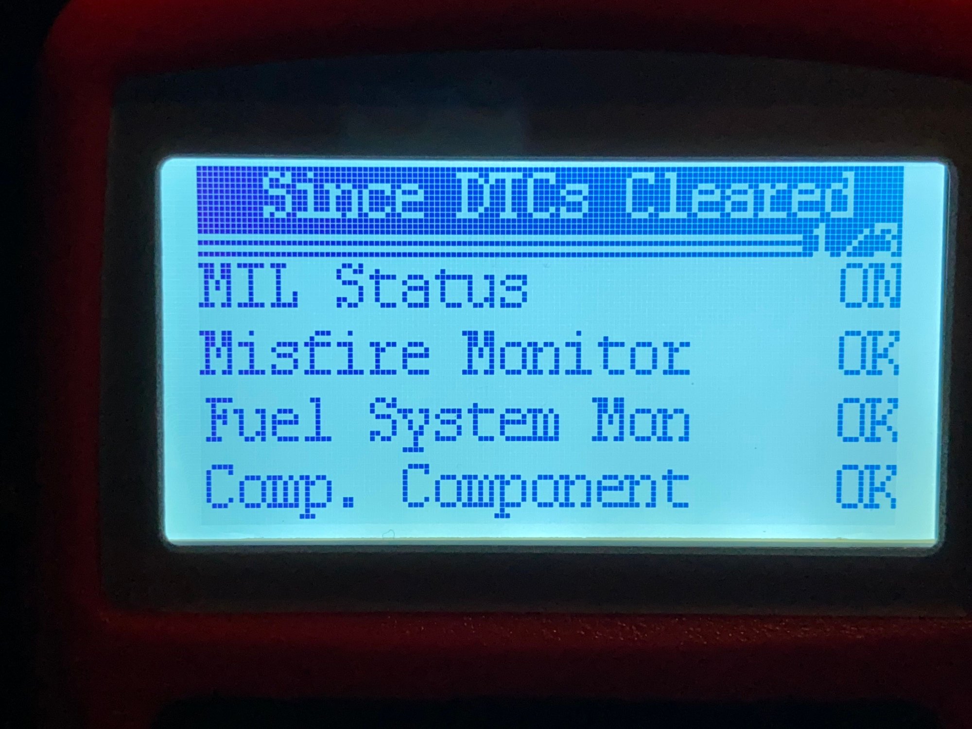

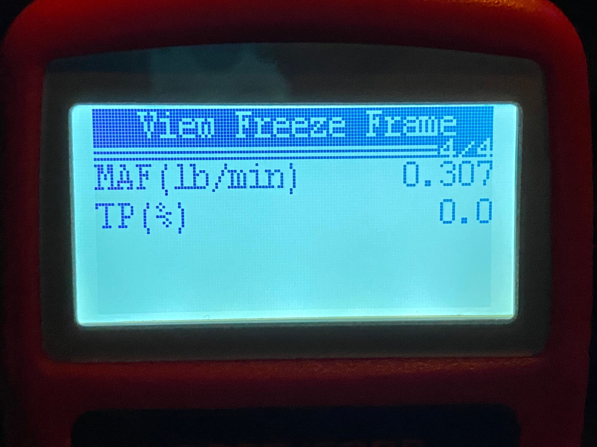

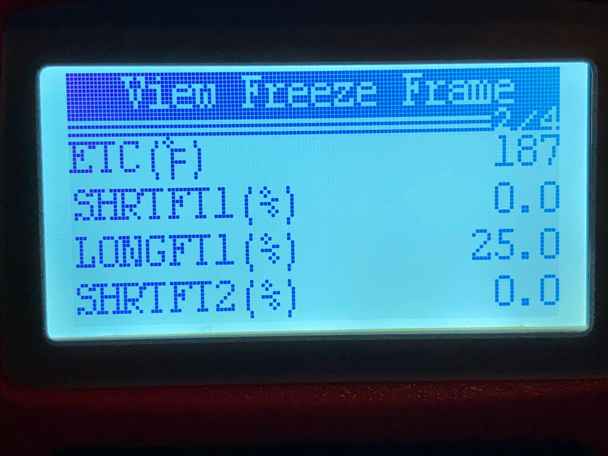

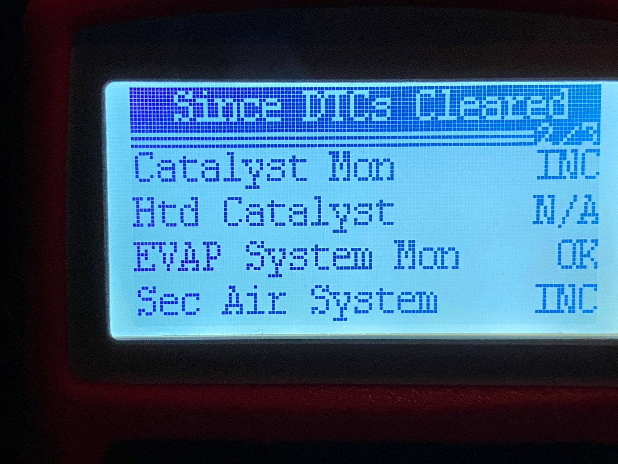

Here are pics of what’s on the code reader.

Originally Posted by fastertransam
Does any of that data from the code checker mean anything?
No, this code you are chasing is pretty simple. Once you have the code, you need to probe for voltages. https://www.obd-codes.com/p0102
The code just means that the voltage getting back to the PCM is low. This could be due to a contaminated sensor, high resistance in the circuit, or lack of power supply to the sensor.
