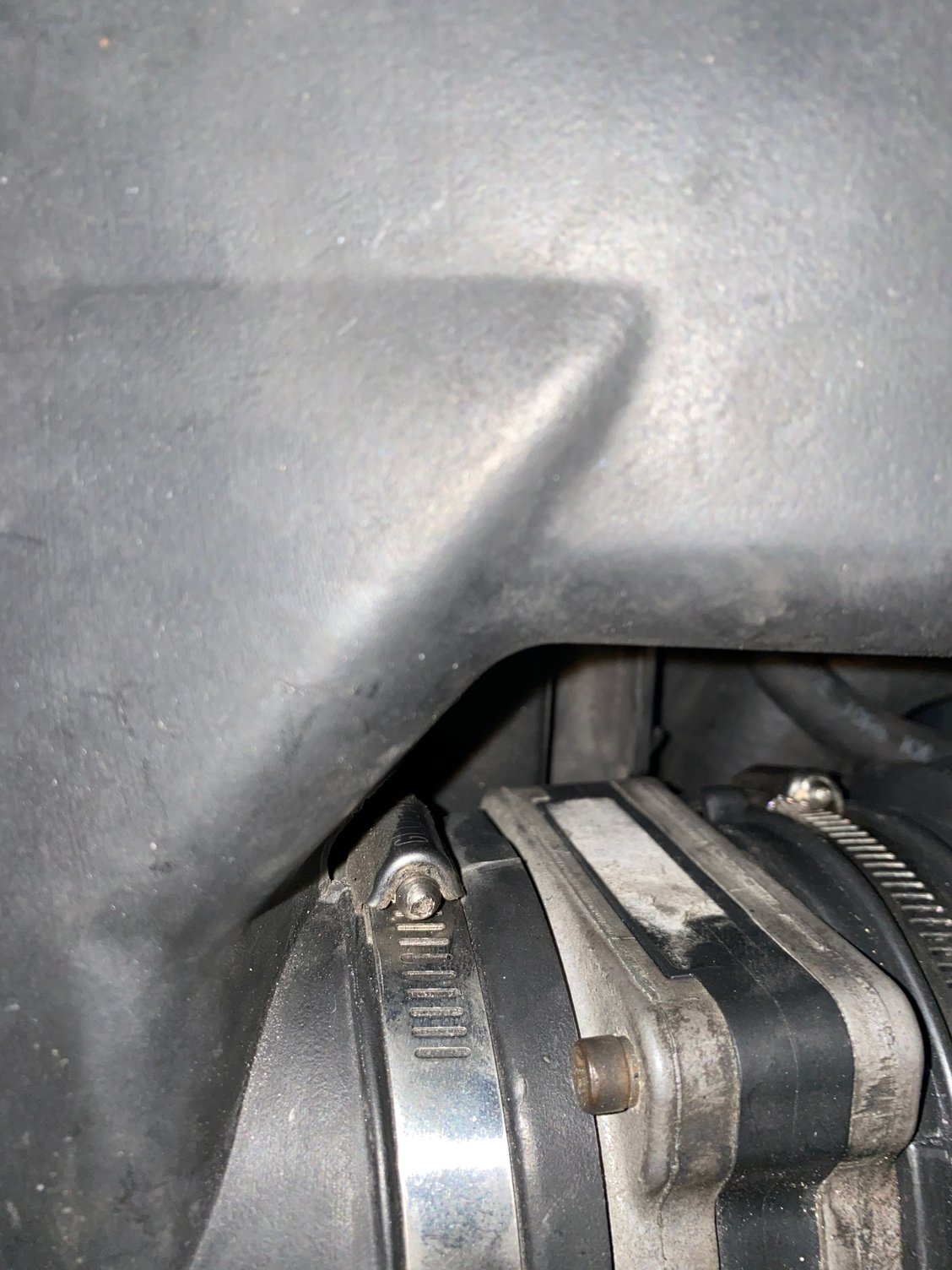

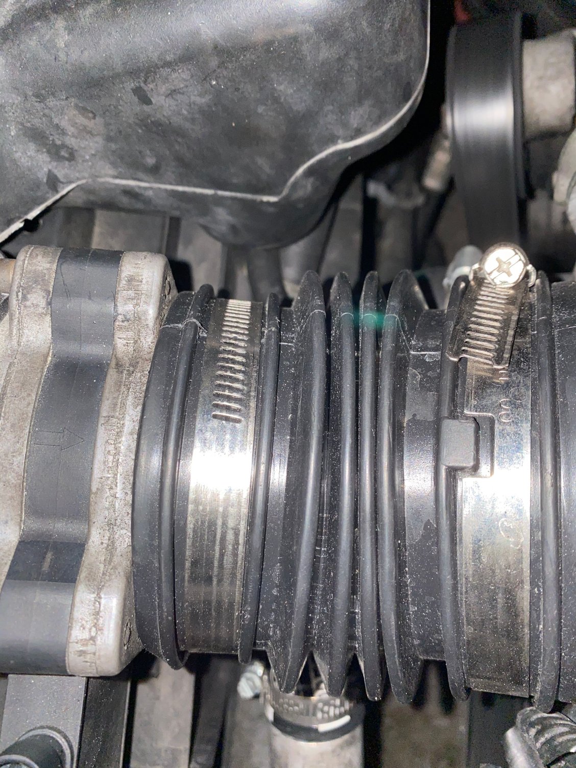

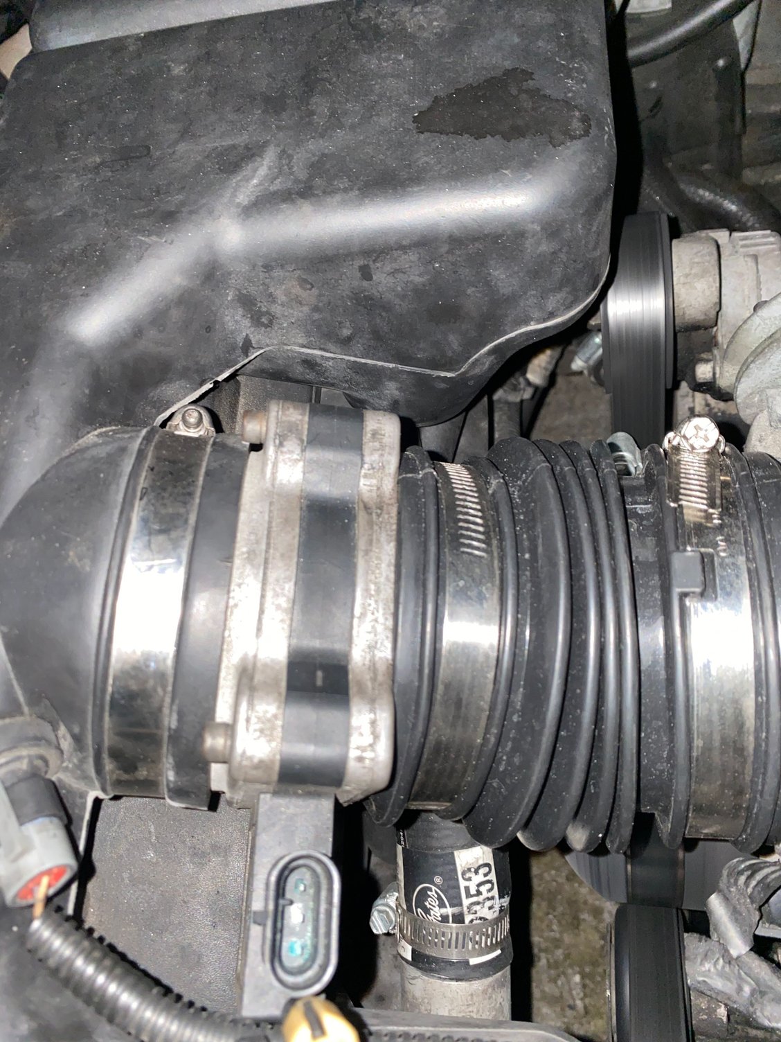

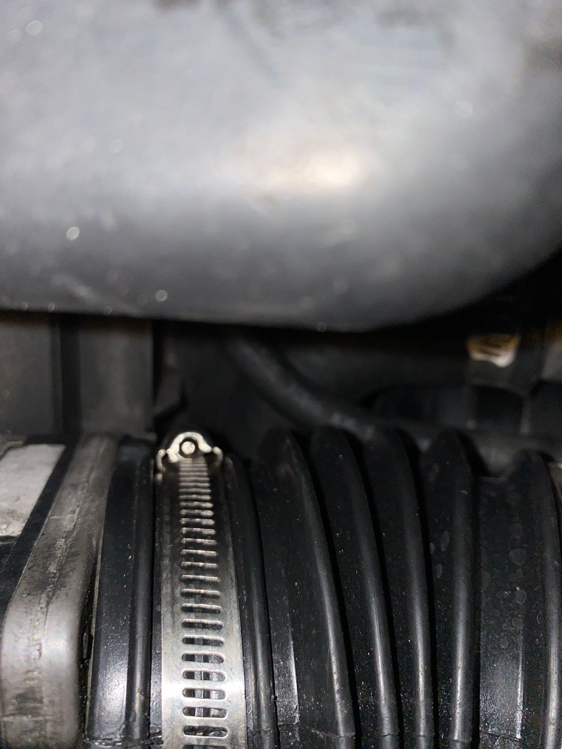

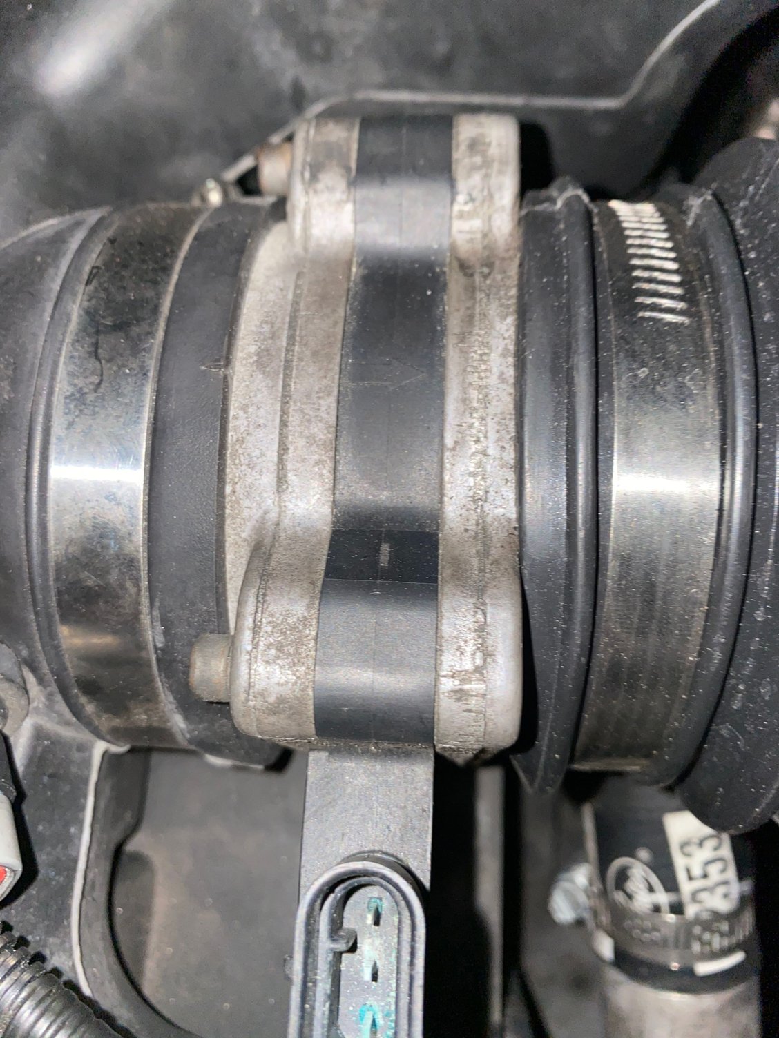

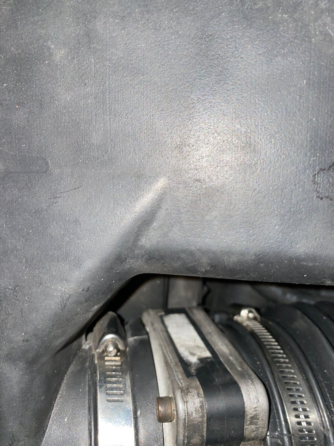

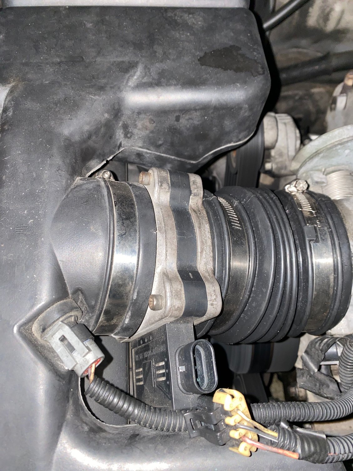

So I went to try and remove the MAF sensor to clean it, but clamps do not have flathead screws tightening them. Its some other thing that I don't believe I have ever seen, almost like a rivet. I have a a set with all kinds of "bits" [hex, torx, and so forth] and none of them fit. Anybody know what they are?
If anyone knows of a video showing how this is done, it would be appreciated. I could not find one.
Thanks,
fastertransam
Here's a video on the air box replacement, which will show getting down to the MAF. It's all flat head worm drive clamps. If you have something different, please post a picture.
