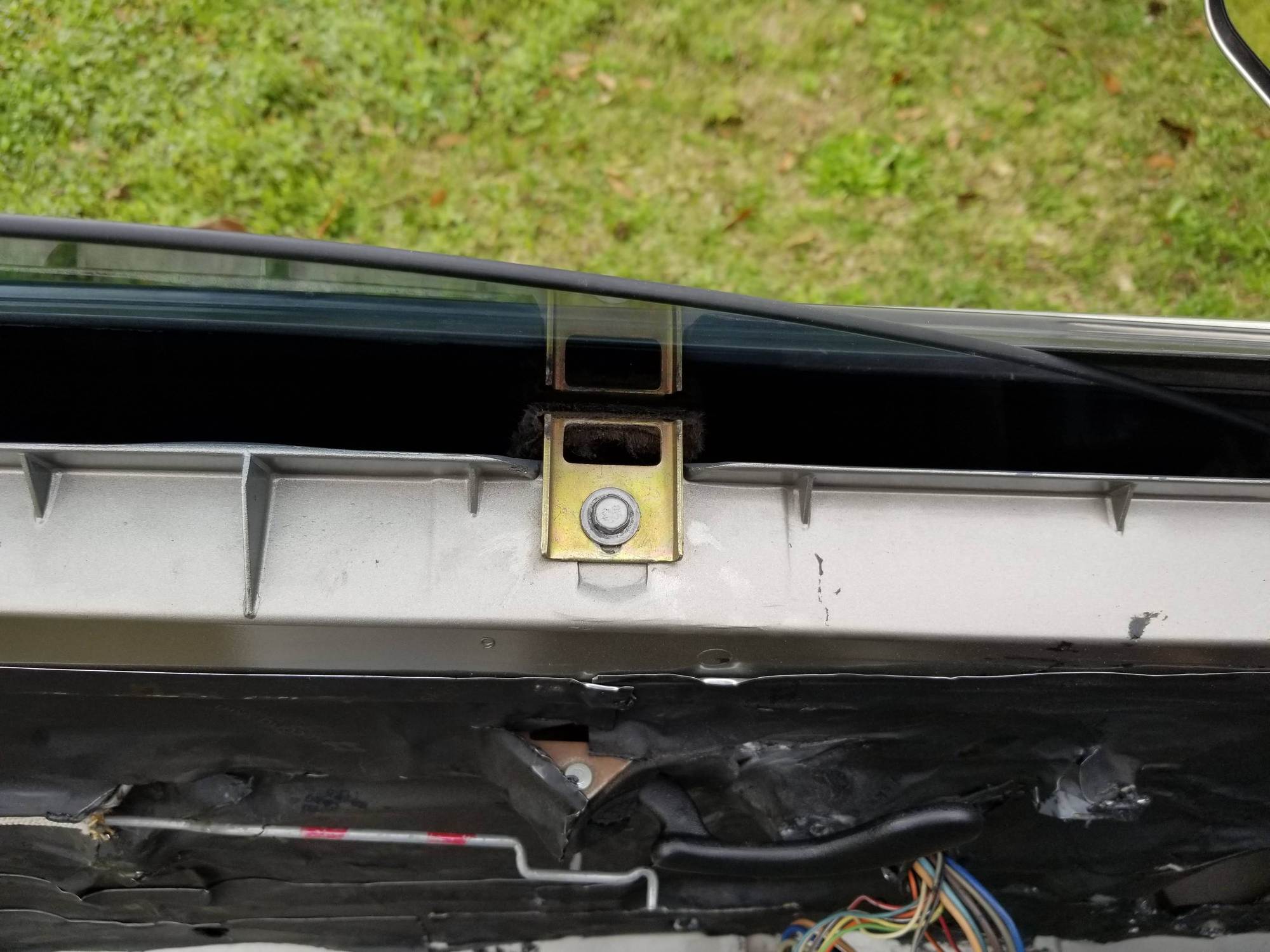

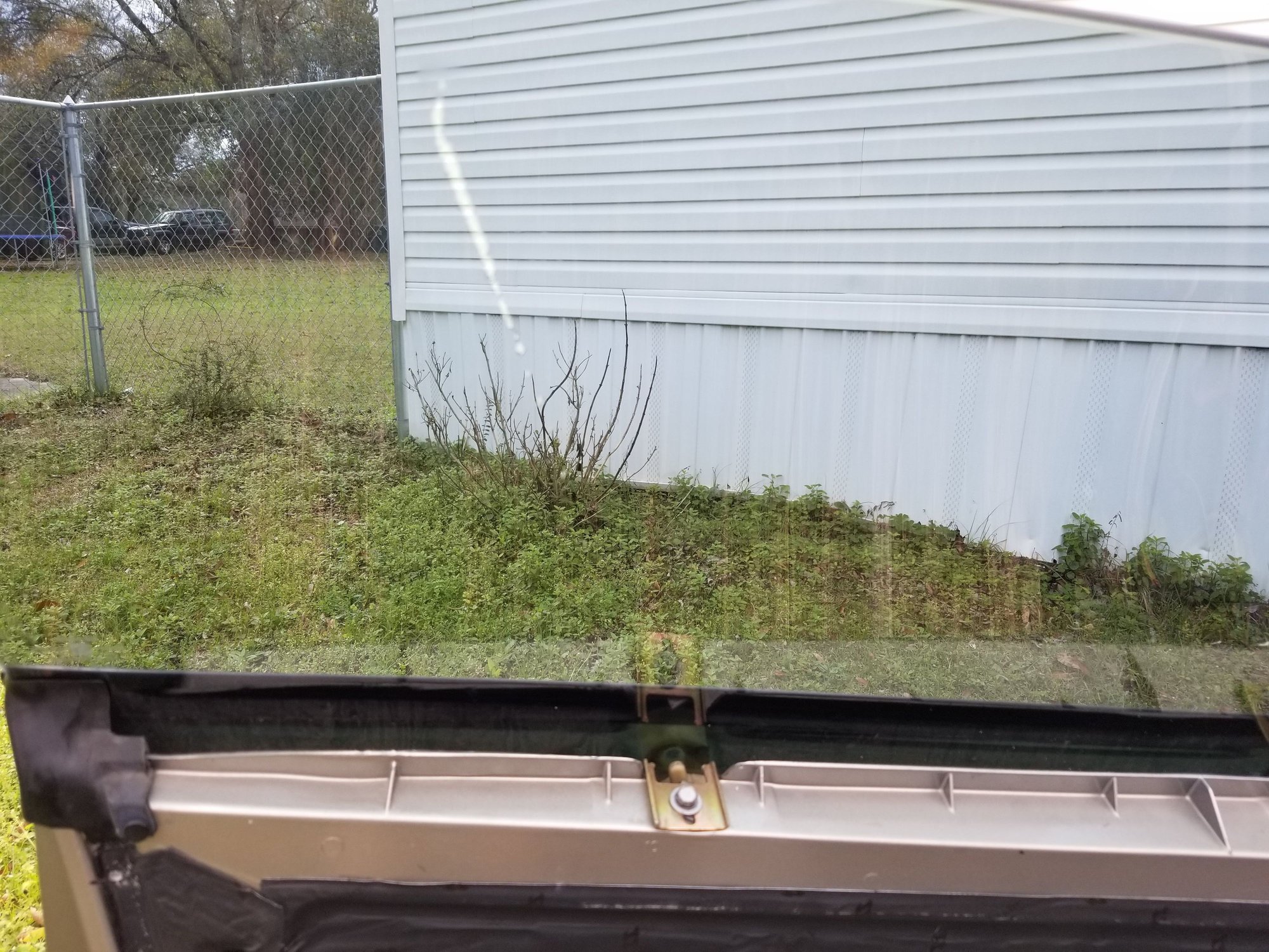

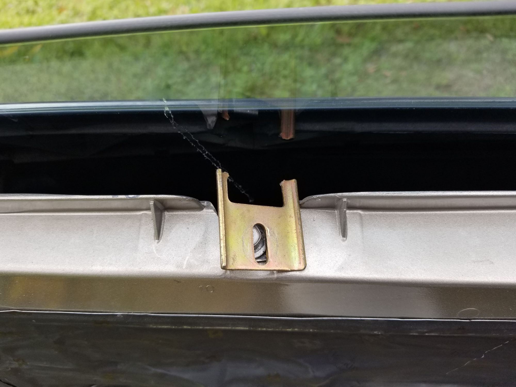

Thank you for your reply, I took the door panel off today to have a look at it, and this is what I found
this is the front one still doing its job
I was wondering how my tent got scratched so bad, And this is why.
looks like something's missing lol!!!

I checked all the rollers on the regulator and everything's still nice and greasy. Wssix99 was right, It's looking like the motor is saying good bye to me. Thanks for the heads up

That part that is broken is a window guide. We used to have to get them from junk yards but I think I recall hearing that they are available in the aftermarket now. You definitely need to get a new one!
You don't want to change the regulator. Doing so unnecessarily causes one to remove rivets in a process that puts bad wear on the door panel. As I posted above, go to the shbox site. Use his instructions for motor replacement. (You'll want to check that out now, before you get into this further.)
When you get the new window guide, you'll need to adjust it. To do this, you will also need to follow the instructions on the shbox site. WARNING - If you do not follow the shbox instructions for adjustment on your new guide, you will have big problems. These things do not contact the glass in an intuitive way or function like we would expect.

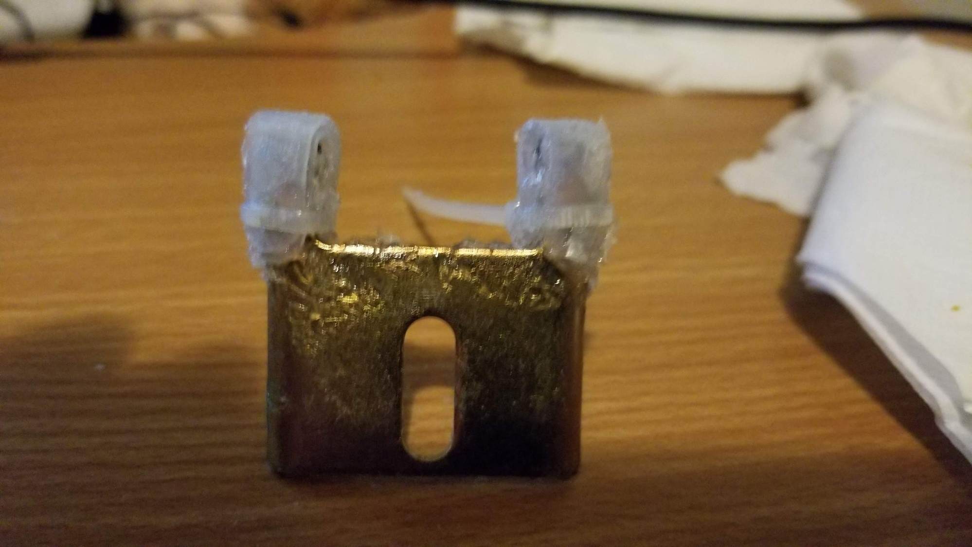

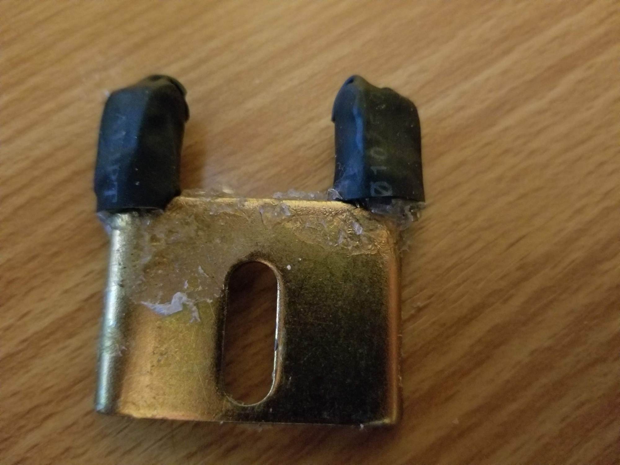

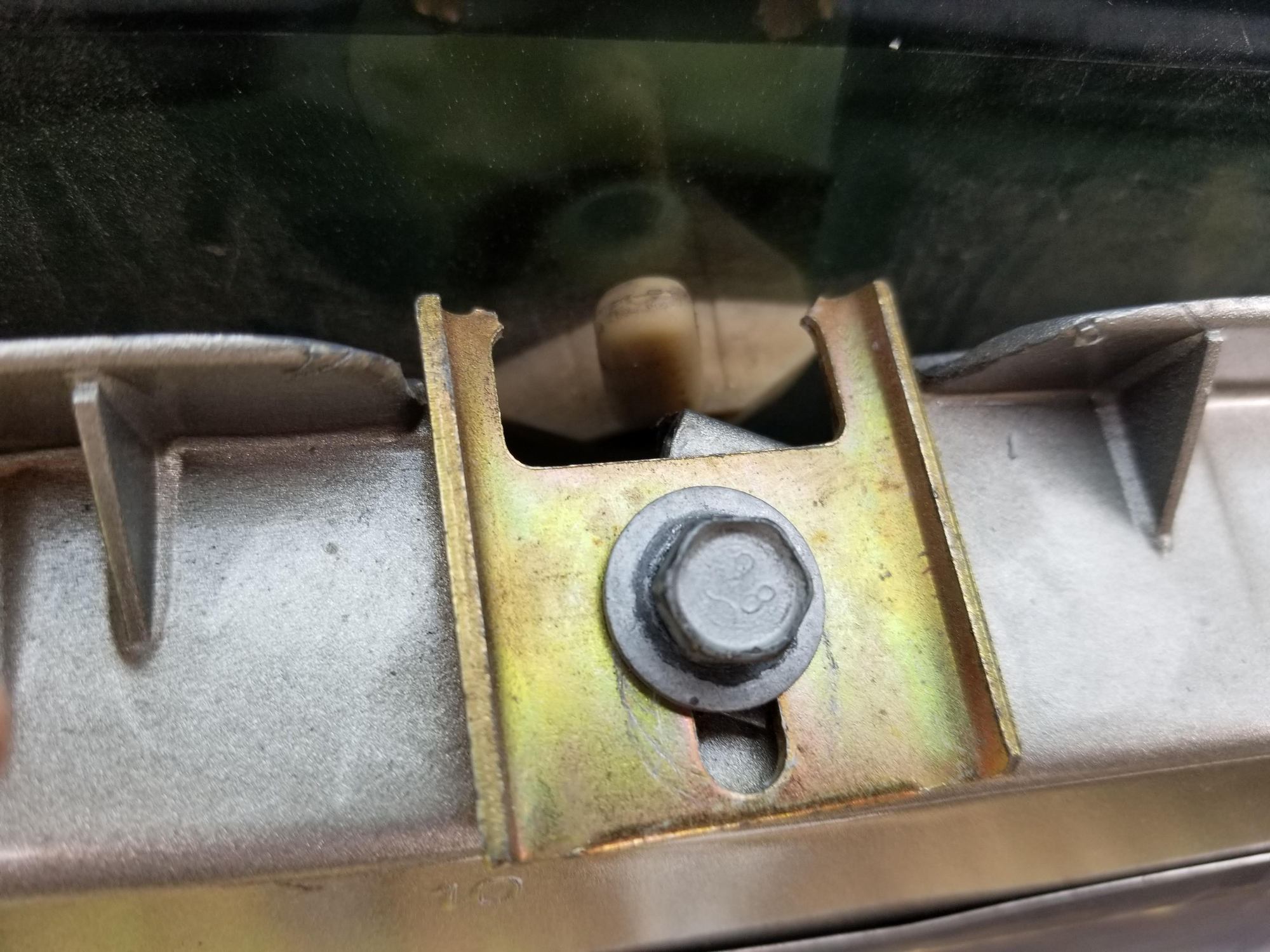

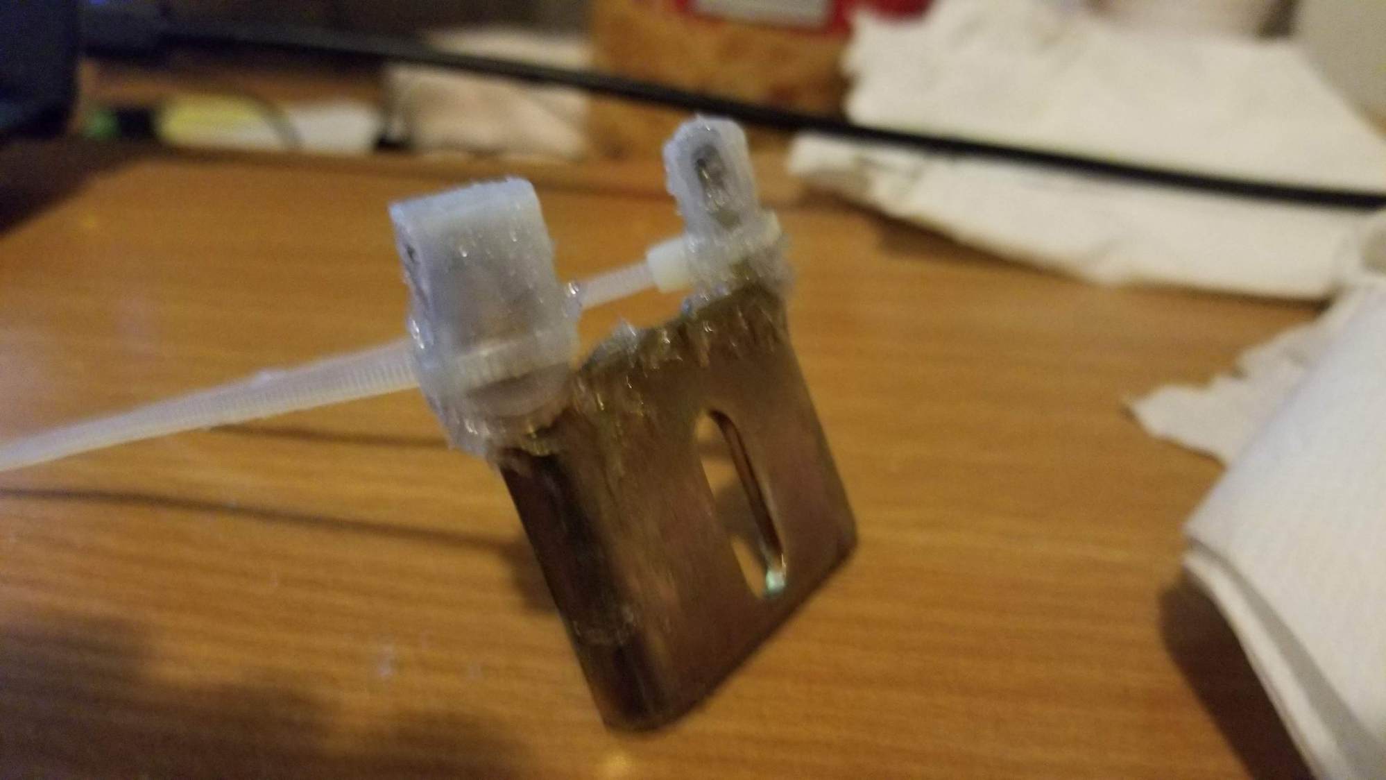

Thanks for the shbox tip, I bookmarked the website. That site is a goldmine of info for our cars! I did a little adjusting on both windows today and got them good and tight! The passenger side just needed some lithuim grease in the regulator tracks. I found a website that sells the window guides, I don't know if they are a sponsor,, but I did a little "patch job" on my broken on just so I could put my door panel back on,,,,
I put 2 plastic wire supports over the ends with lots of clear silicon then zip tied them tight to the bracket while drying.
The next day I removed the zip ties, and sealed them up with some heat shrink. this is temporary, I'll swap it out for the new one when it arrives.
