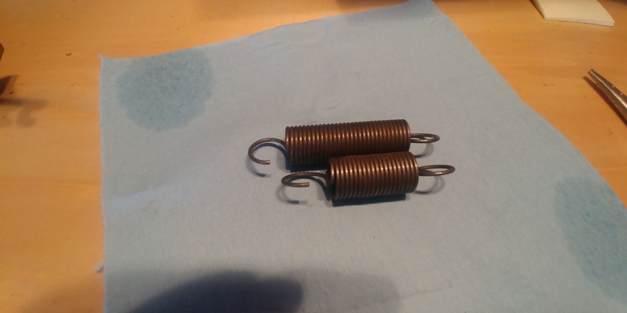

So I spent a lot of time recently trying to figure this out. Tension on the cable was fine, it was nice and tight. The rivets looked fine too. I was able to use one of those handheld back massagers to vibrate the assembly and I think the main offender is the see-saw lever that the button presses against to release the e-brake. Unfortunately after hammering and cutting and drilling to try and tighten up the hook on the back end of the button, I essentially destroyed the assembly haha. I ordered a new (used) one from Hawks Motorsports. I installed that one and it is totally silent. I'm very discouraged that I wasn't able to solve my noise issue but at least things are quiet again for now.
Another thing that maybe someone can shed some light on. I have no idea what year vehicle the new assembly came out of but the spring is significantly shorter. Mine is an early '94. Does anyone know when they started using these shorter springs? And why?
