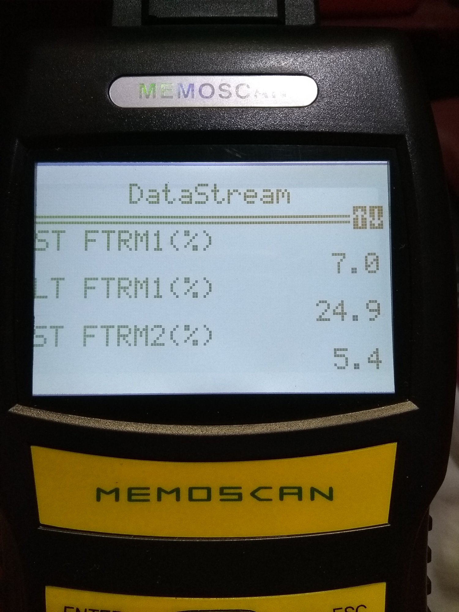

Sooooooo, after some scanner tool check, my "ltft" is up to 25% on both sides. If I increase rpm, it lowers to about 15%.
From what I understood, I have to check for vacuum leaks. Anything else I have to look for?

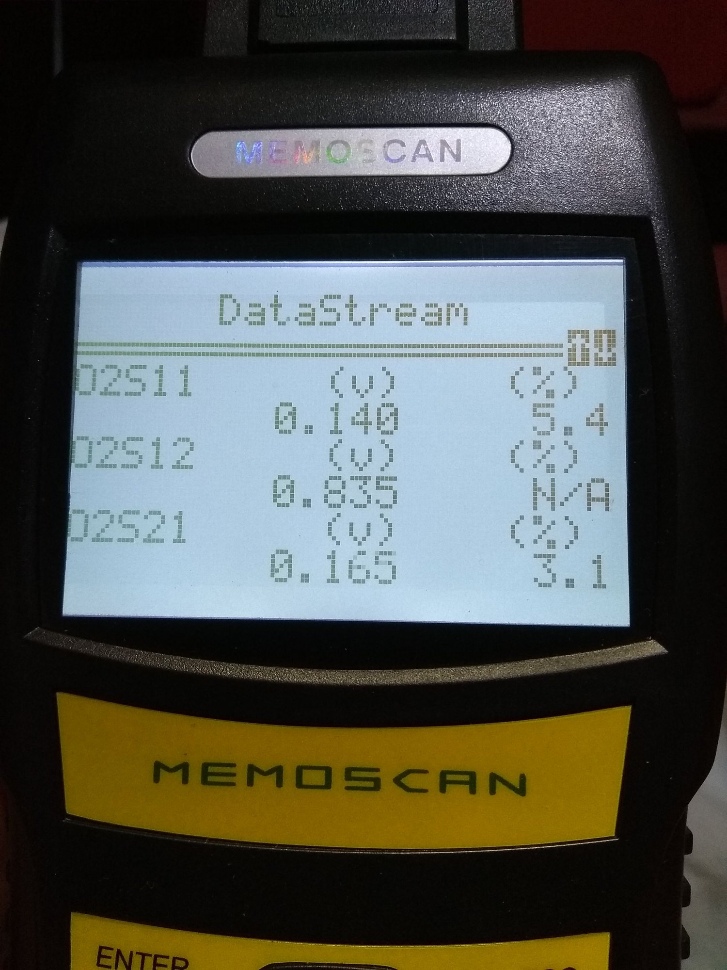

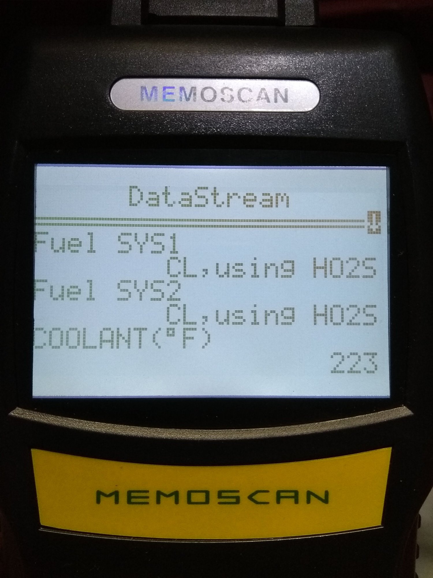

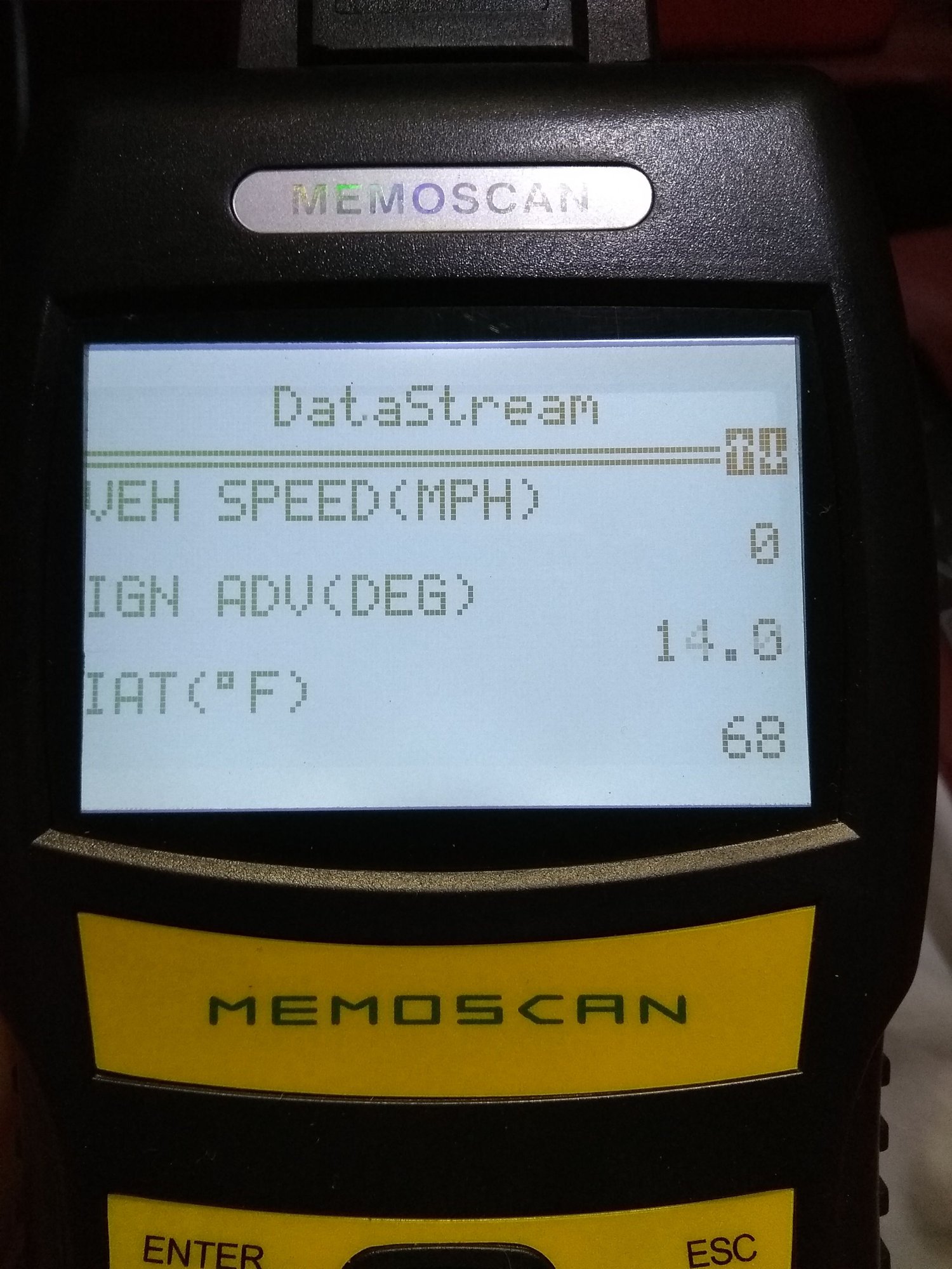

@wssix99 I used a MAF cleaner, and it's totally clean. But I will see to replace the K&N.
If someone is interested, here are some pictures of my scan numbers. Not on pictures, but LTFTs are dropping when I raise RPMs.
The MAF number looks low, but a proper curve will confirm.

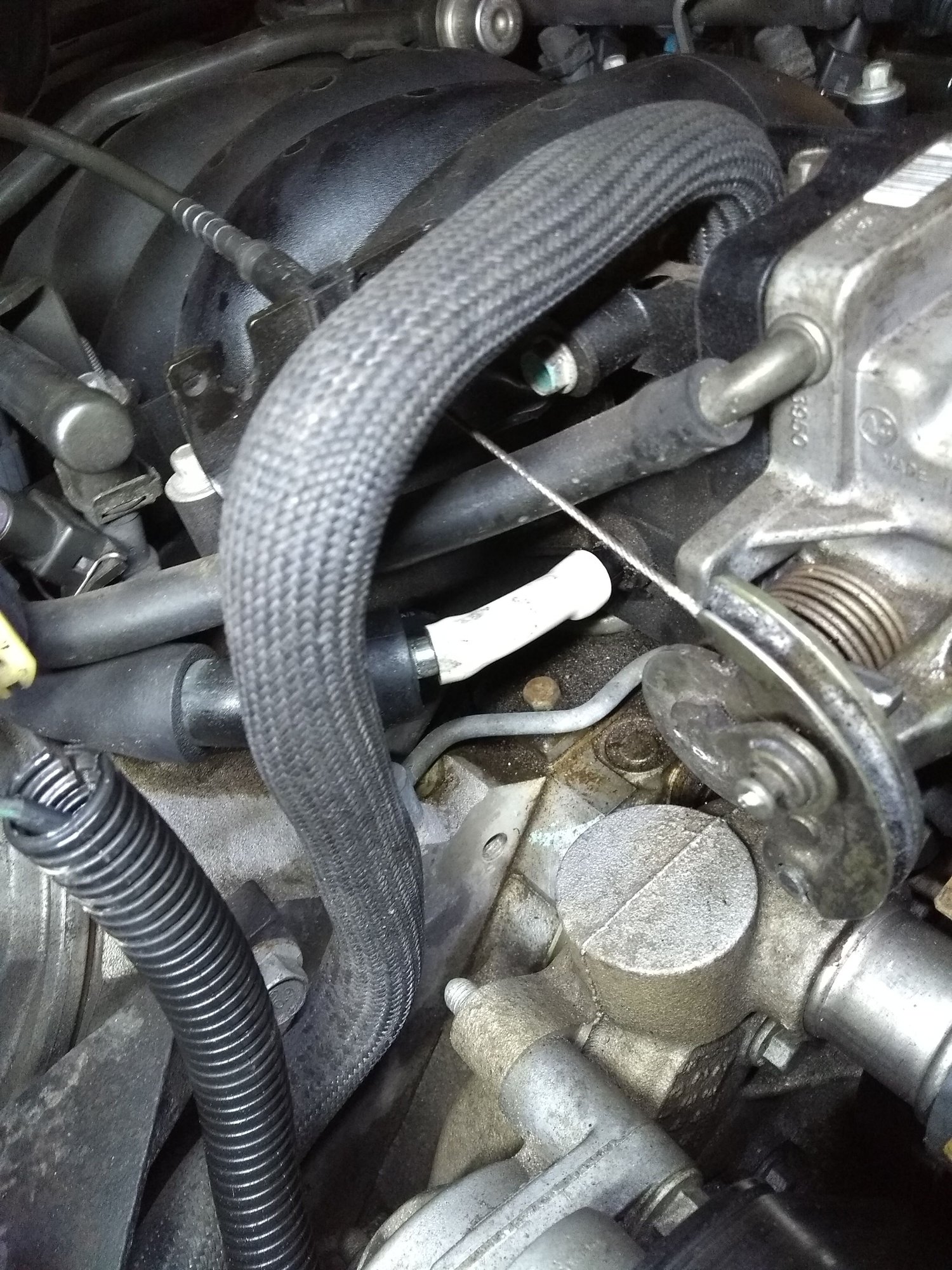

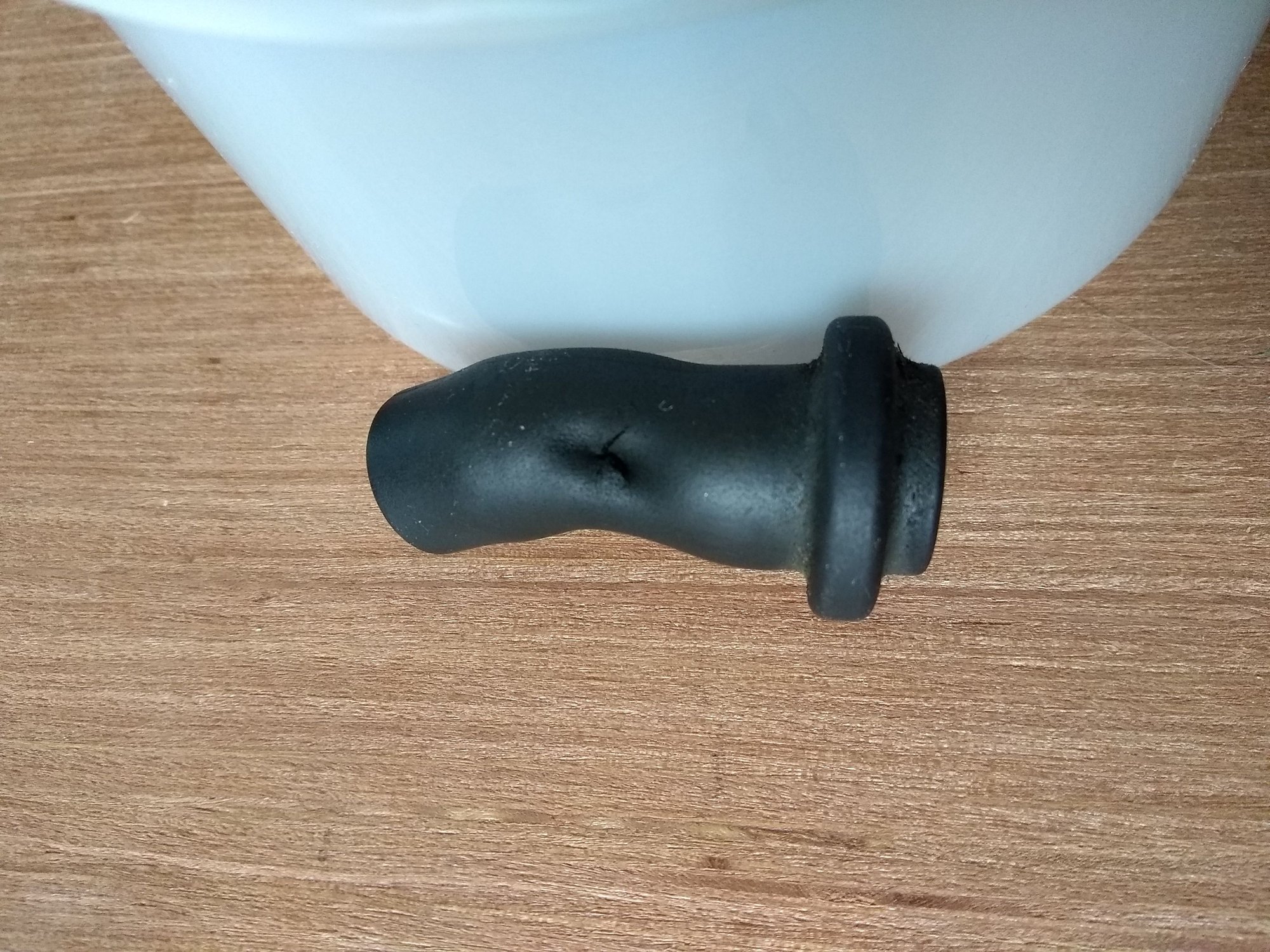

It was a vacuum leak. I don't know what's this hose, but it's cracked at the bottom and the inside is in a bad shape. Any thoughts?
Here are some pictures of the culprit and the white one I put for test:

That's the PCV hose. To the left of your white patch is the PCV valve, wrapped in the larger black hose. There's no vacuum there, but the Venturi effect could pull some air in at that point, behind the MAF but it should only be a small amount of air. The size of the MAF orafice is MUCH larger than that hole.
I'm pretty sure you still have a dirty MAF. I expect that MAF is still most of your problem. If your codes go away, maybe this leak is what is putting you over the top?

I also have to figure out why there is a hole in the hose and why it looks kinda burnt or dry inside.
These hoses wear out a lot. They can chafe and the removal/reinstall of the PCV valve can stress them out. That passage also gets a lot of oil in it.
Have you changed your PCV valve ever? If not, it could gum up and allow air to flow backwards and maybe oxidize some of that oil.
