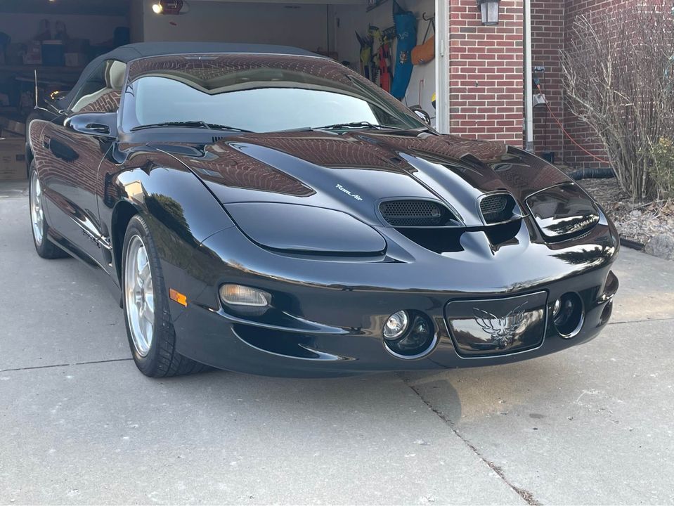

Car has been taken care of. Was owned by a collector who even changed the oil . I will be driving it on nice days so it will get some use. If anything I am overly careful when it comes to taking care of cars. It will spend the Wi winter in a car bubble and come spring it will be back on the road for more car shows and fun. Here is a picture of it.

^^^^ SWEET!!!!
