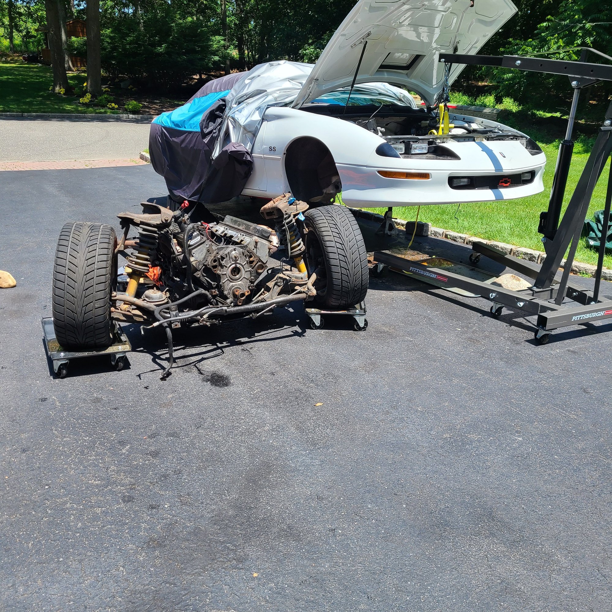

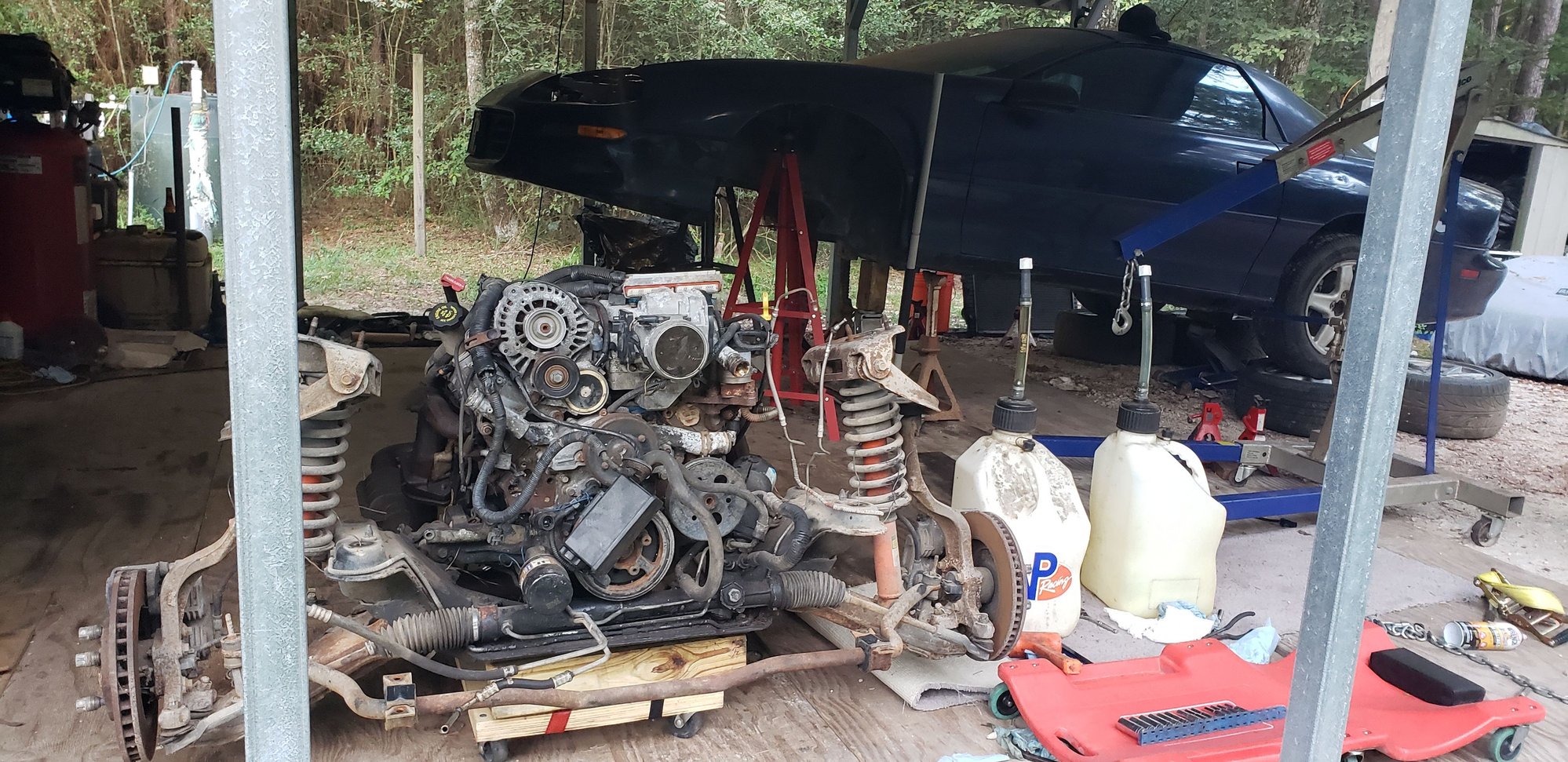

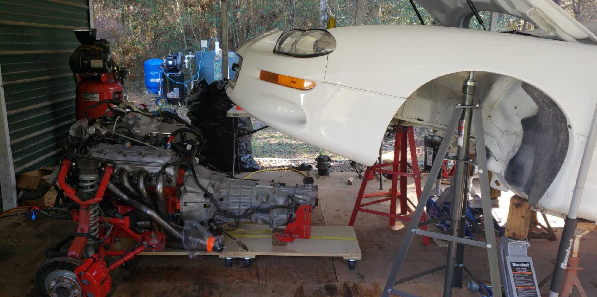

Old Jun 12, 2021 | 12:23 PM
01CamaroSSTx's Avatar
Joined: Feb 2015
Posts: 5,997
Likes: 2,286
From: Conroe, Texas
Floor jacks, 4x4 wooden blocks some tall jack stands, engine hoist and tow strap. Best way is a tow strap between the frame/front bumper support where the sway bar connects. I've also lifted from the front radiator support but it was little by little with the floor jacks and engine hoist as I didn't want to put all that weight on the nose of the car. If the car is going to be in a funny car state for any length of time then standing jack stands. I used the radiator support my first time and I wouldn't recommend jacking the car from that alone. My .02

Originally Posted by patSS/00
I am liking this, thanks
