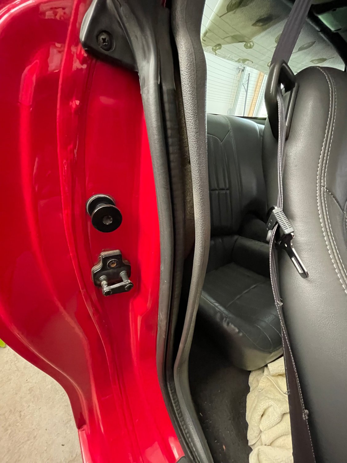

Speaker panel, passenger side
Here you can see the open space between panel with the interior foam cushioning sho

That gap is there pretty much fresh from the factory. The OEM Velcro can't hold it.

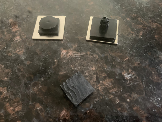

I'm actually working on a fix for the interior sail panel gap issue that doesn't involve a screw. I plan to use some relatively strong neodymium magnets.
Going to try it out this weekend. Will report back with results.
There are two types of fasteners with the factory Velcro pre-bonded to them. There are four fasteners total three of the one on the left and one on the right.
