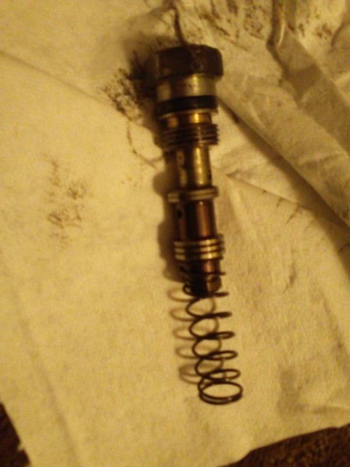

There is this bypass valve in the power steering pump. This is off an f-body ls1 mine is a 99 corvette but i expect it to be similar havent pulled the pump off yet requires alternator bracket removal. I think the pump pressure line is 400-500 psi or something in that range but if its clogged or whatever it will have this bypass valve and not pump fluid.

as you have pulled off the bypass valve you can see there is not much to it....you can remove yours and soak it in lacquer thinner to loosen any particles that may be in there
the valve can be adjusted for different pressures...what pressure the vettes are set at i have no clue
the outer rotor and vanes may be simply worn and unable to keep the required pressure needed....as well as the many internal seals no longer sealing

Check out sjsingle1's pump rebuild thread: https://ls1tech.com/forums/general-m...pair-pics.html It's very instructive on how these work.
You could have some bad vanes, but I would suspect a stuck bypass valve, as you are suspecting. I believe the C5/C6 use the same style pump.

Definitely the bypass valve, then. A bad rack is a bad rack 100% of the time.

So before purchasing a new pump is there anyway to confirm if this one is indeed just stuck with the bypass valve? A broken spring or clogged port in the bypass valve or what to look for when removing and dissassembling the pump to maybe see whats wrong. I think its the bypass valve and not just worn out veins as i think it wouldnt have worked the one time it did before going back into hard steering.

Just remove the valve, on mine its threaded in uses a regular socket.
I would bet its grunged up or the spring gave up.

You gotta drain the fluid, take the valve out, and then clean it. You could probably hook a bunch of pressure gauges up to the sytem, but it woud be easier to just clean the valve.
