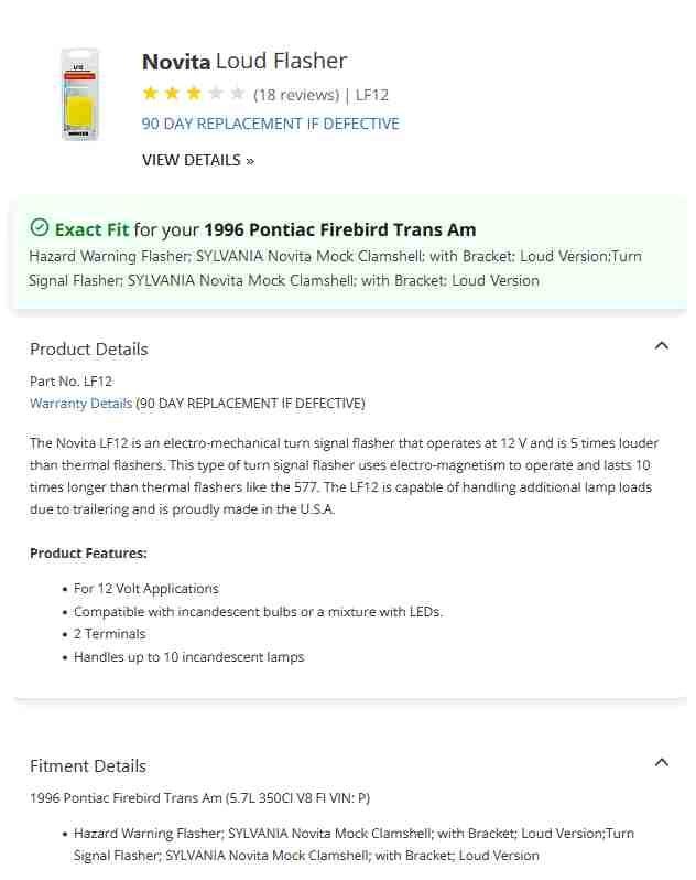

Unfortunately, aftermarket turn signal flashers (they're not relays) vary in loudness by brand and model but I don't think anyone has ever catalogued which are louder and which are quieter. You might try searching in the wiring section for someone complaining "flasher too loud" that might have some comments on relative volume. Metal can flashers tend to be somewhat louder than plastic ones. The other possibility is getting a motorcycle flasher - they are generally louder because of the environment they're used in.

If you really want loud, you can wire in a buzzer/chime/beeper. Many newer car's typically have something like that because their flashers are electronic modules without a loud audible click.

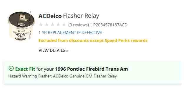

I actually just found this on Advance Auto's website!
WHO KNEW??? Ha Ha Ha

Originally Posted by paluszak
I thought so too on the name, but why are they often listed this way?
This is a common expression even though it's not accurate. It's sort of like calling turn signals "blinkers" or automatic headlights "DRLs". A relay has a low current circuit which controls a high current main circuit. A flasher has a similar high current main circuit but it's not controlled by a separate low current circuit. The old fashioned thermo-mechanical flashers that came with f-bodies work much like a thermostat... the current flow heats up the bimetal switching strip which bends and interrupts the current flow, letting it cool off and close the circuit again. Electronic flashers use a portion of the input current to run a timer that opens and closes the main circuit.
