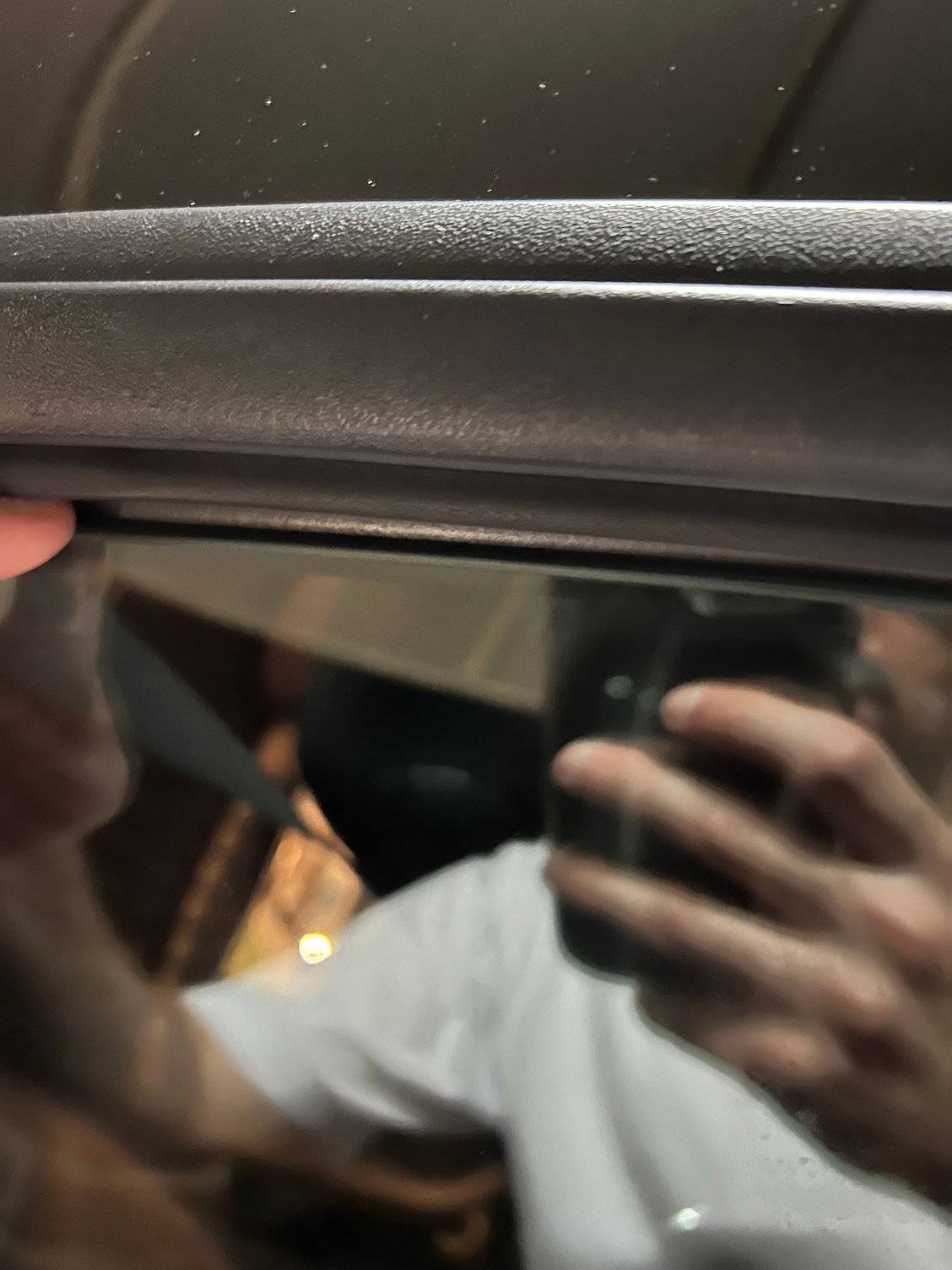

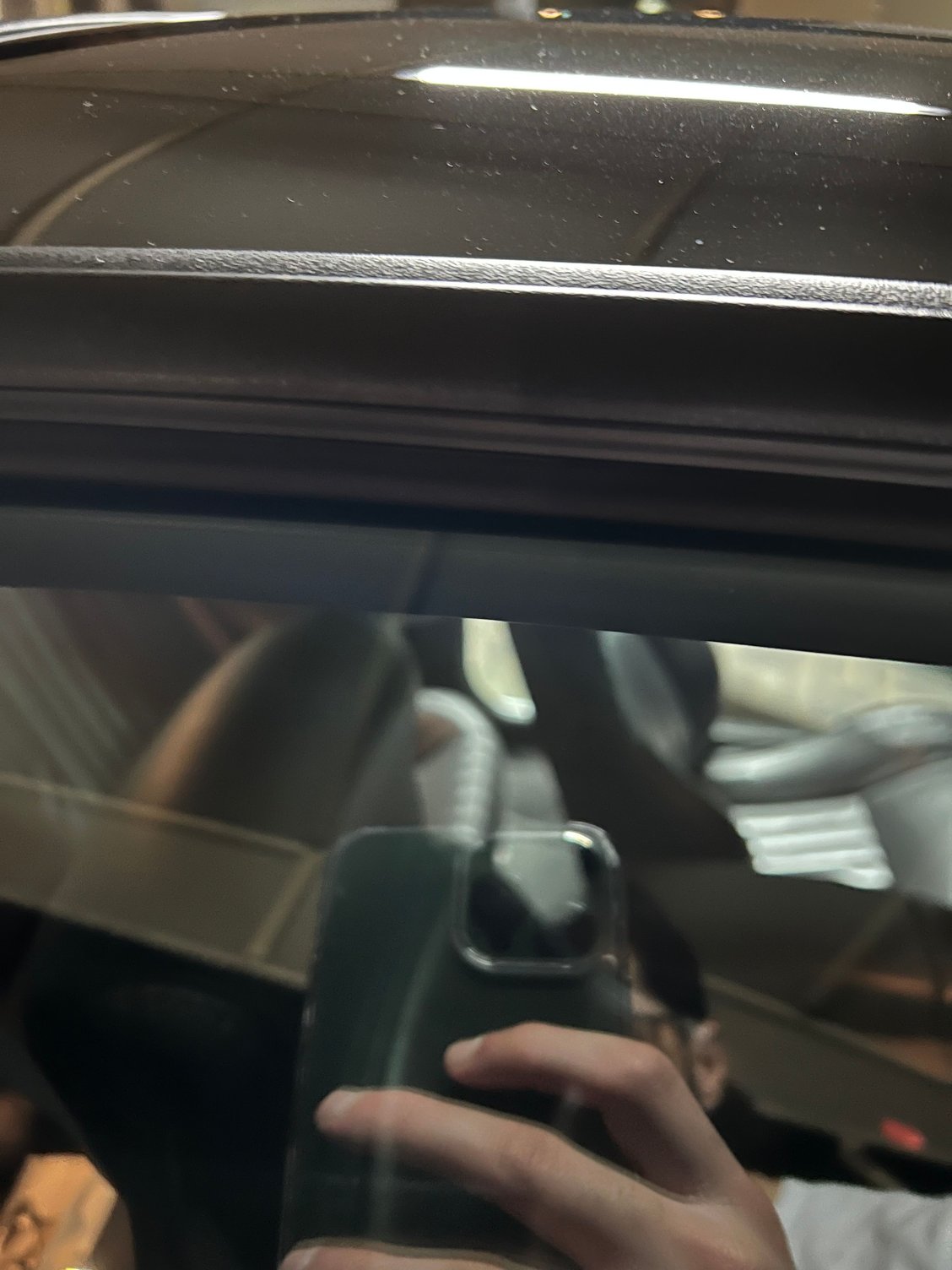

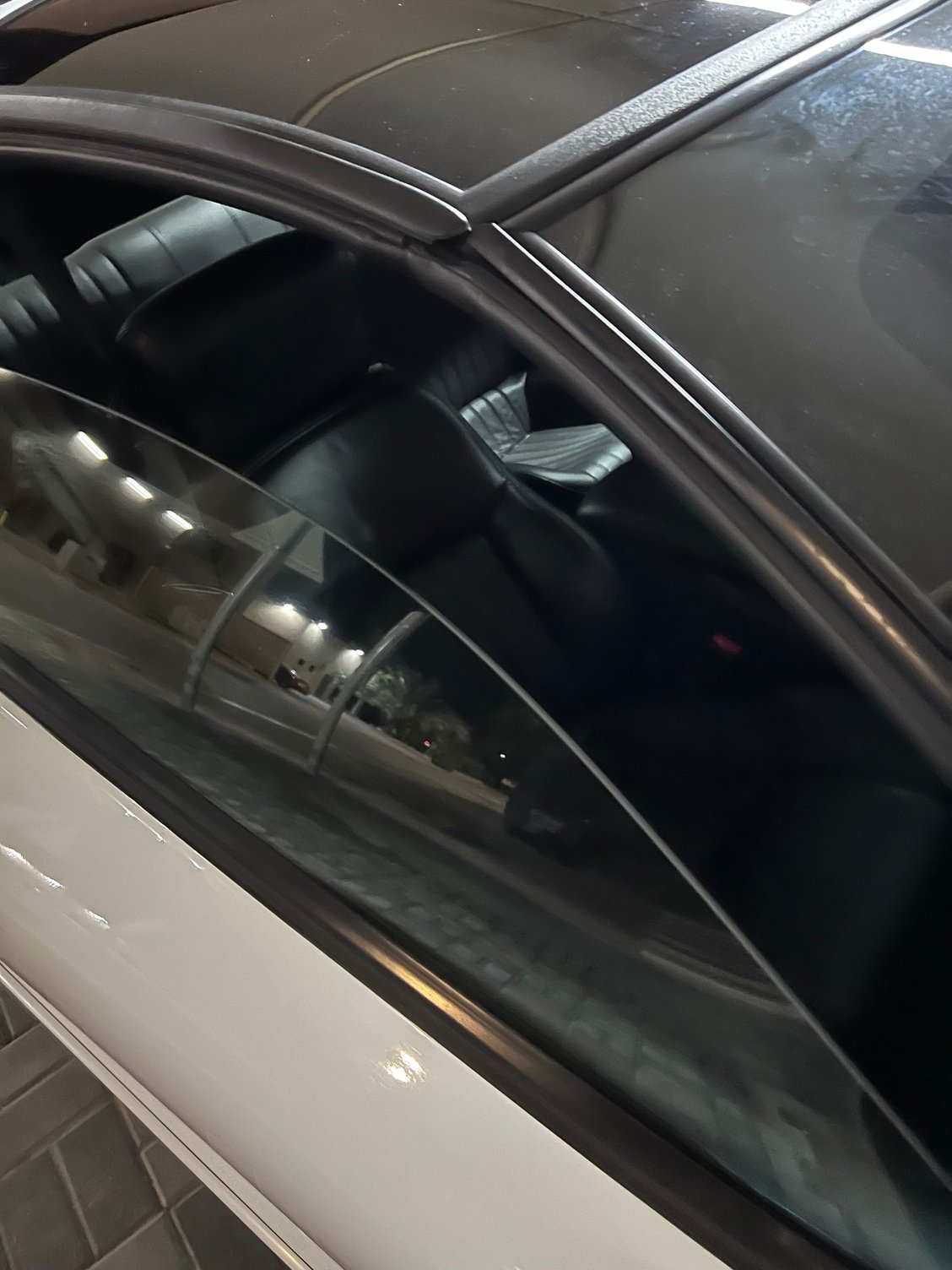

Hello, I know that there’s a ton of window threads but please hear me out. I just opened the T-top for the first time on my 2002 ws6, I cleaned it up and installed it back without any issues. Right after that the passenger side window stopped responding, it was slow at first then suddenly it just got stuck midway. I had to wait for a few moments before trying to slowly raise it up again, after a few tries it finally went up all the way.
Earlier that day I had the car cleaned and I thought it might be just moisture or from the water, because I noticed that in the last few days whenever I washed the car the passenger side window would get more water inside not just a few drops from the side, then now when I wanted to move the window up from the driver’s side switch it doesn’t go all the way up it leaves just a tiny bit of space which explains why the water would enter more.I had to use the passenger side switch to raise it all the way up again before calling it a night. I just tried it again for the last time and it just stops midway going up. It went down fine at first.
does anyone have any suggestions on what I should do? Do I wait till tomorrow before trying it again as it might be from the water and moisture?
thank you all
Stops midway going up
The tiny space left after using the driver’s side switch to put the passenger side window up.
The space is gone after using the passenger side window switch to turn it up.

Sounds the the typical failing window motor on these cars.

thank you for your reply, what’s boggling me is that the window goes all the way up when using the passenger side switch, not the driver’s side. And the window stops midway going up now, I thought it might be due to the fact that there’s water or moisture I guess🤷
I have noticed that both the driver’s side and passenger side windows go up and down slower than any other car I’ve owned, since I had it shipped from USA .
what do you think is the solution ? and if there’s a part I need to buy please inform me.
I live overseas in UAE and there’s not much I could do in regards to spare parts unless I buy online and have it installed at home.
Guys, how do I know if this issue is caused by the window motor or regulator?
Much appreciated

This is a classic and textbook failure of the window motor. Specifically it is the thermal cutoff switch inside the motor failing. This is why the motor works after letting it sit for a while. The switch cools down for a while and will work for short bit. The switch is designed to shut off the motor when the window finishes its normal travel. When the window is all the way up or down, the glass stops heating, the circuit heats up, and the switch cuts off power to the motor. When this switch goes bad, it heats up prematurely and cuts off power prematurely.
This problem will get progressively worse (quickly) until the motor doesn't work at all. Your best course of action is to NOT use the window once you get it all the way back up, until you can replace the motor.
You can also open the door and pull up on the glass while you try to raise the window and that might help you get it to the full-up position before the motor cuts out on you again.
There are many many threads on this site about these issues, but the best method (we won't cover them here again) for you and the car is to replace the motor using the shbox method: http://shbox.com/page/windowmotor.html
