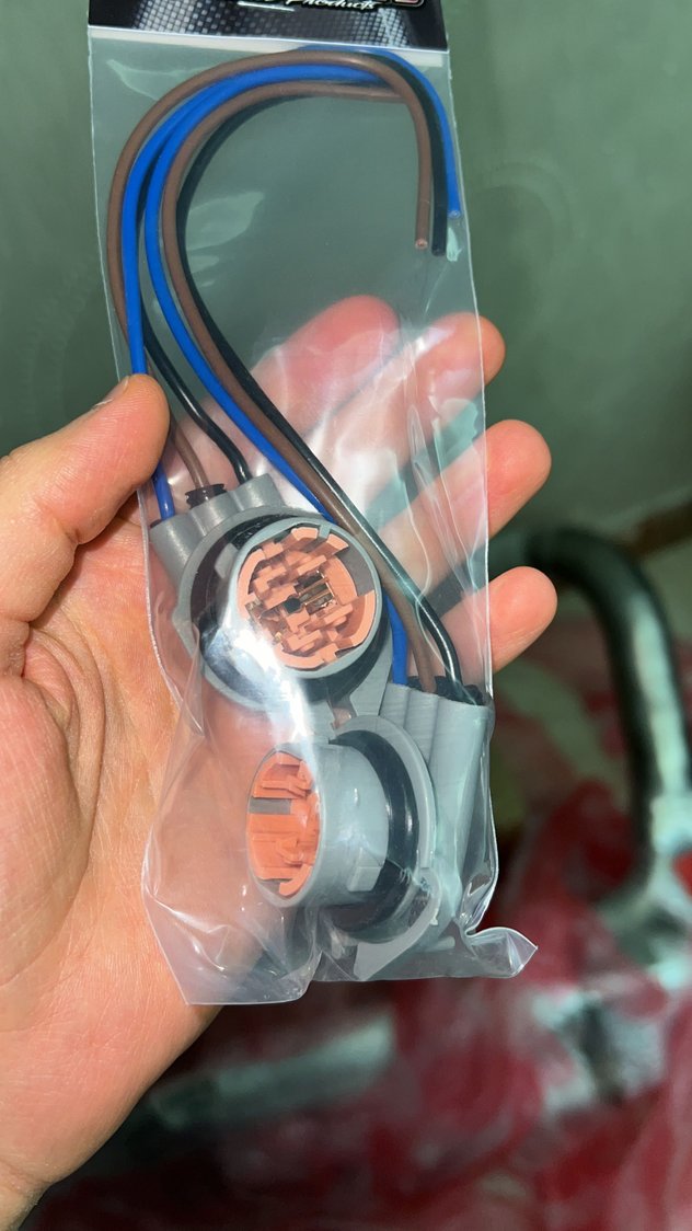

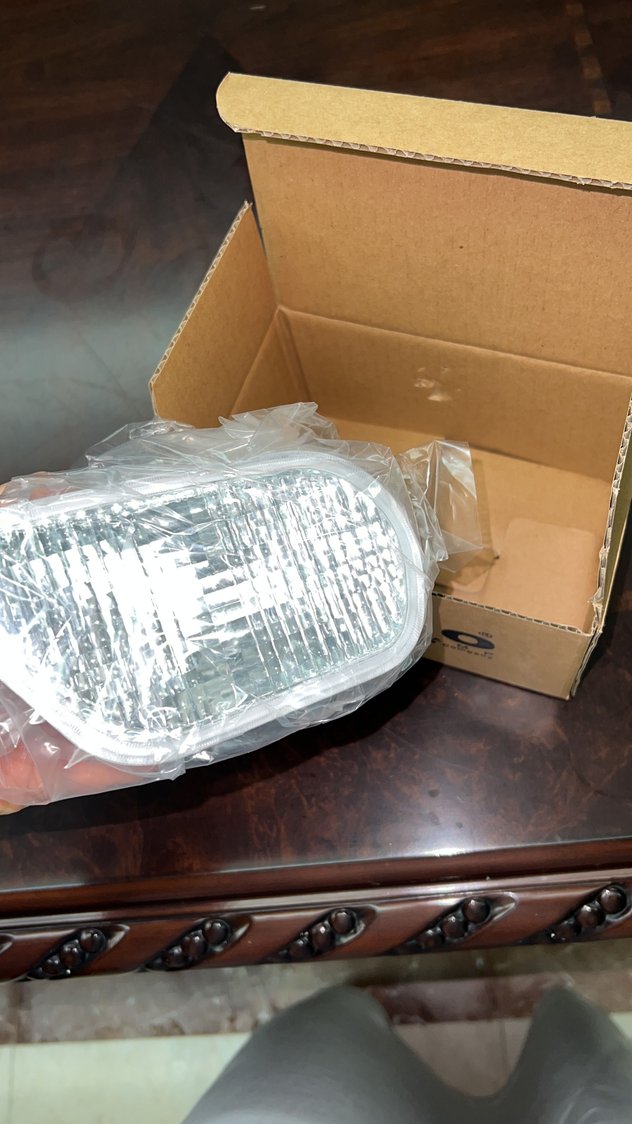

I also have both DRLs out (no turn signals either) and I just received both sockets and lenses for both sides. Not sure if this is something related to the E-brake problem but thought I’d mention it either way. Perhaps it’s a wiring issue? What do you guys think I should do?

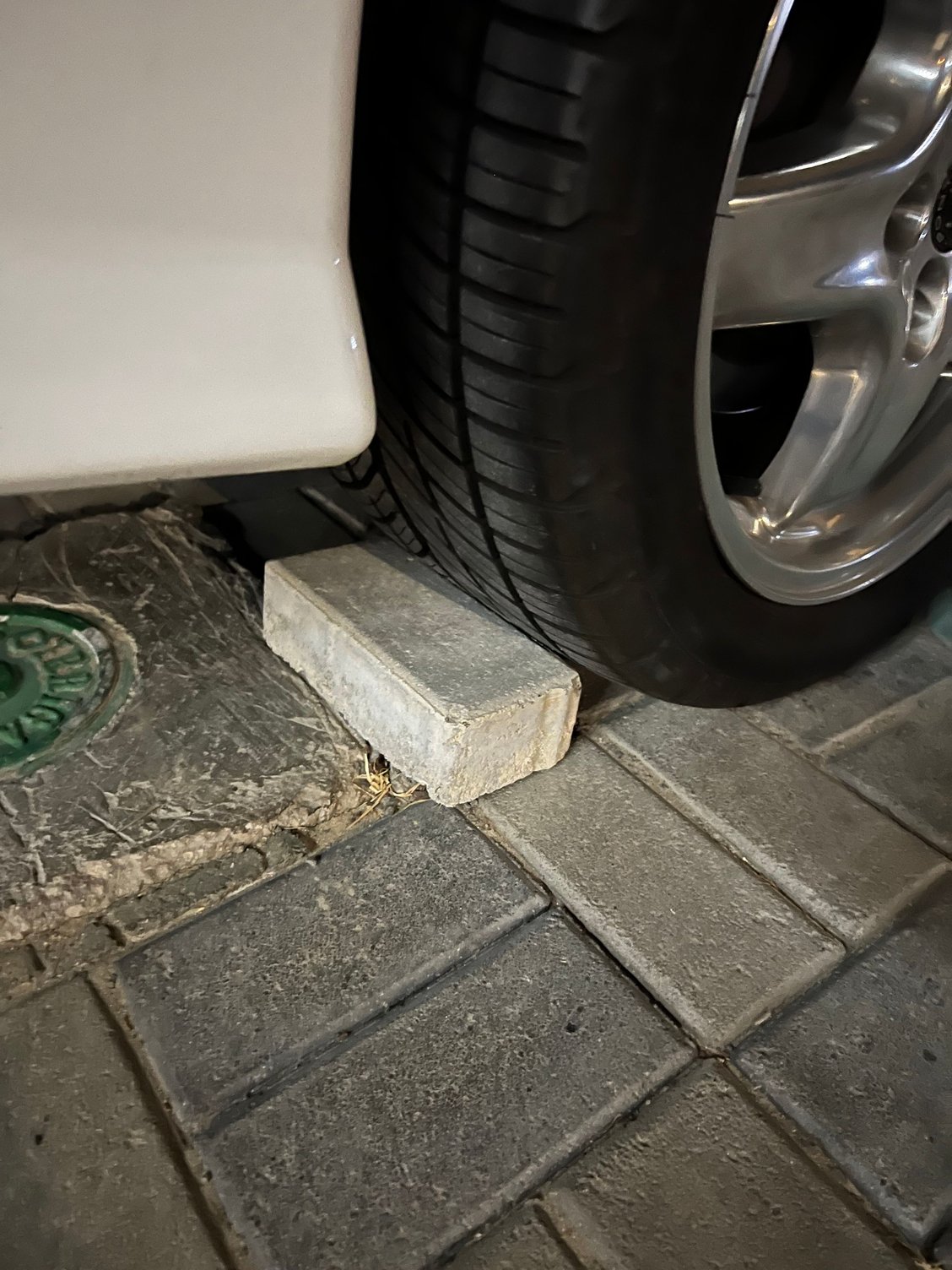

Just as a precaution, I put these behind the rear tires.

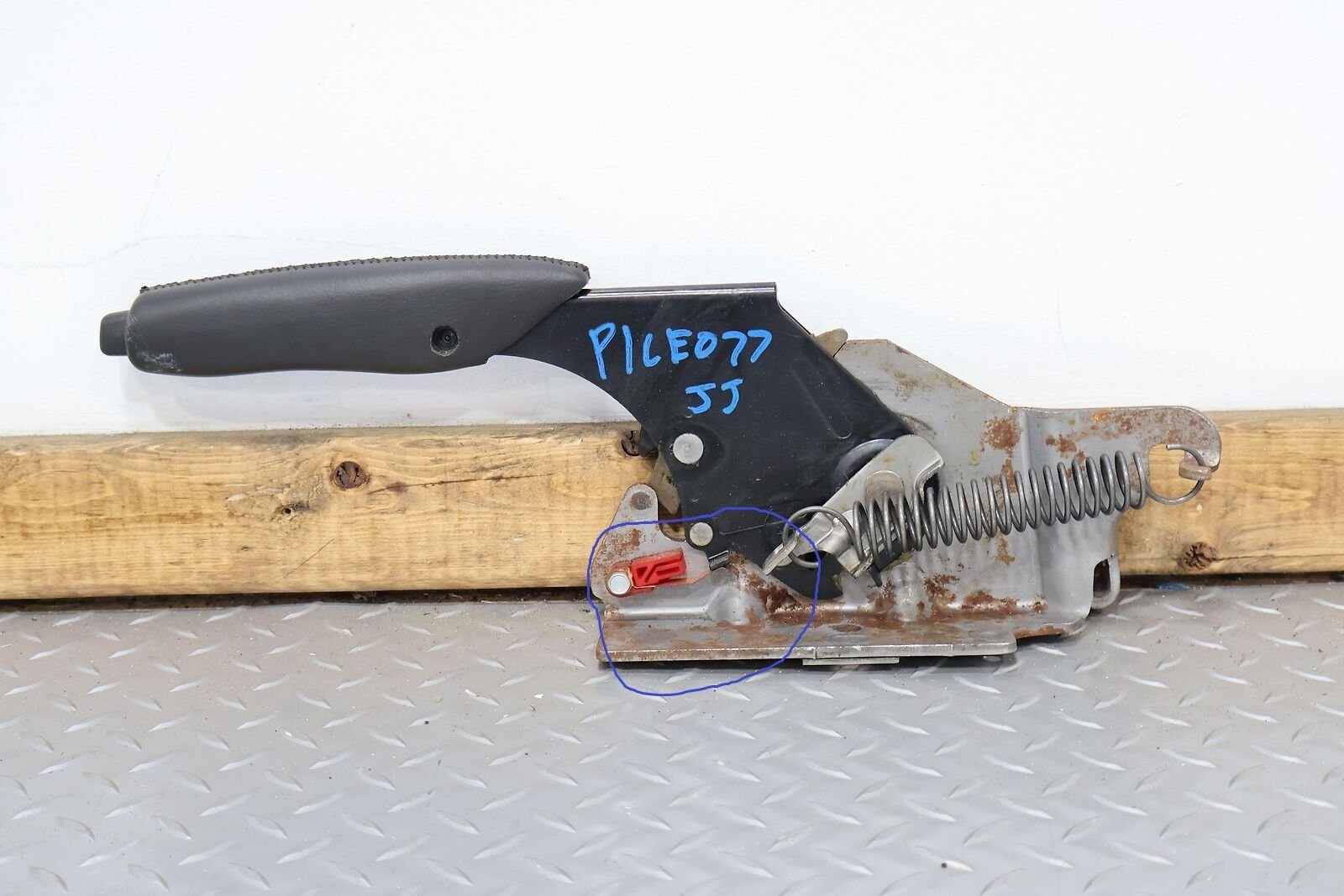

As mentioned above, the common cause for the dash light is a dirty switch under the center console. The red piece circled above is a grounding switch and it collects hairballs and other dirt that connect the switch circuit regardless of handle position. Just unscrew the hex bolt that holds the switch to the handle assembly and you can take the coper contact out and clean it.
The common physical problem with the parking brakes is NOT adjusting them after a brake job. The F-Body parking brakes are not self-adjusting and need to be set for the exact I.D. of the rear rotor when its installed on the car. The procedure is in this thread: https://ls1tech.com/forums/suspensio...ightening.html

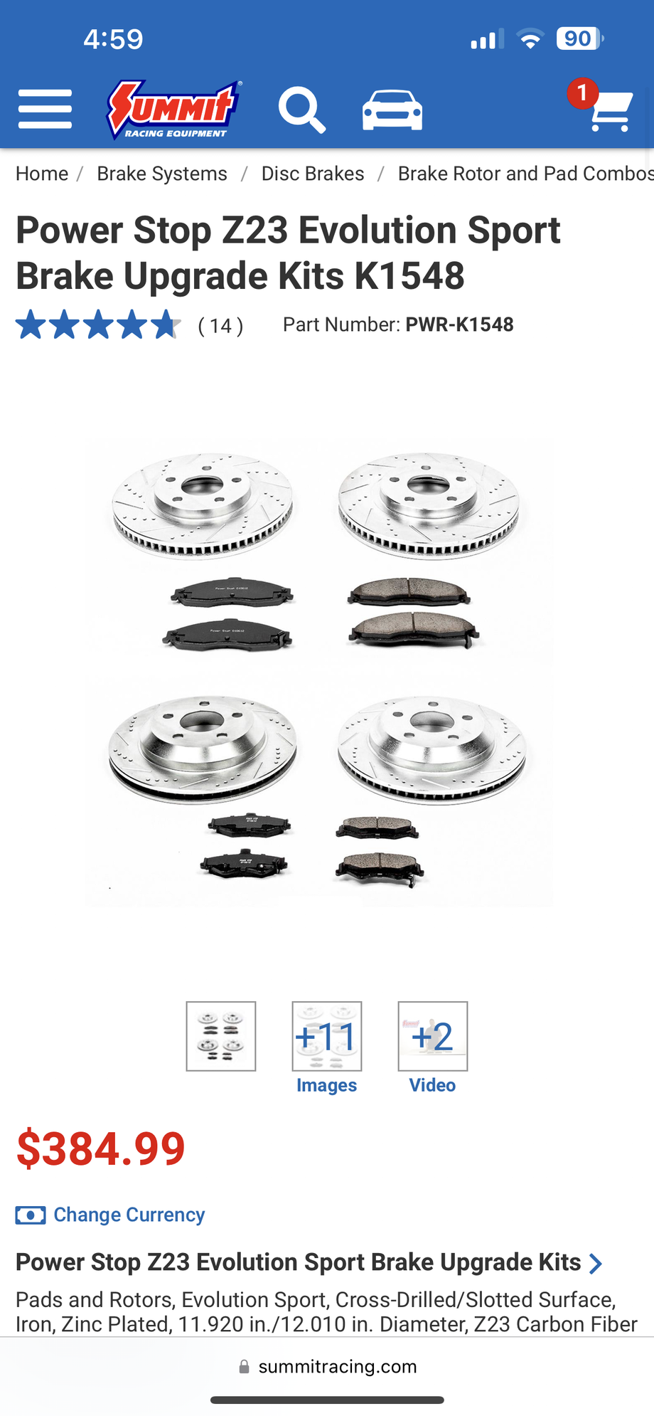

I’m planning to order the below brake kit too and powder coating the stock calipers red, so might as well let them clean up the whole parking brake assembly and re-lube it again. Or worst case scenario, there’s a suspension and brake shop near them that will be able to do the job in case they couldn’t.
