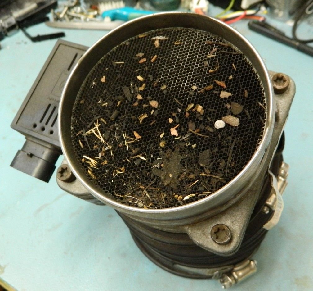

Many thanks to all for the help. I found the problem because of your good advice. I would have never suspected the MAF. Look at this photo of all the garbage in the screen. The reason: The last time the air filter was replaced was at the local GM dealership about a year ago and the tech evidently did not install it right. The tabs at the rear of the upper filter cover were not captured in the base slots, so it was up about 1/2" at the rear and not sealed at all. Hence the large particles in the screen. Runs like new again.

were you pushing a mower deck in front of your ride? LOL

And probably some CRC Mass Air Flow Sensor Cleaner wouldn't be a bad idea at this point.
I would definitely clean the sensor after finding the screen in that condition. Personally, I would disassemble the housing (it's just 4 Torx bits to remove the ends) and clean the sensor element by hand, very gently, with rubbing alcohol and Q-tips - but if you're not comfortable with that then at least using the spray cleaner mentioned above would be a good idea.
You are a very kind person. I would have taken the MAF back to the dealership and forced everyone in the service department to lick it clean.
