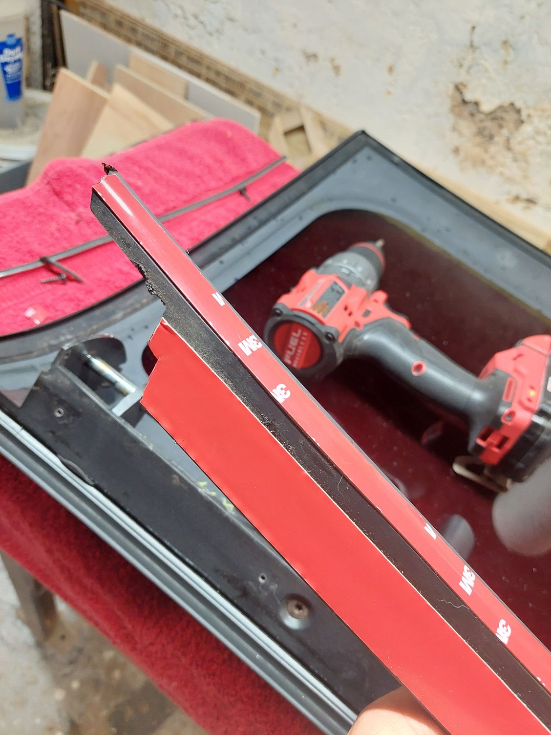

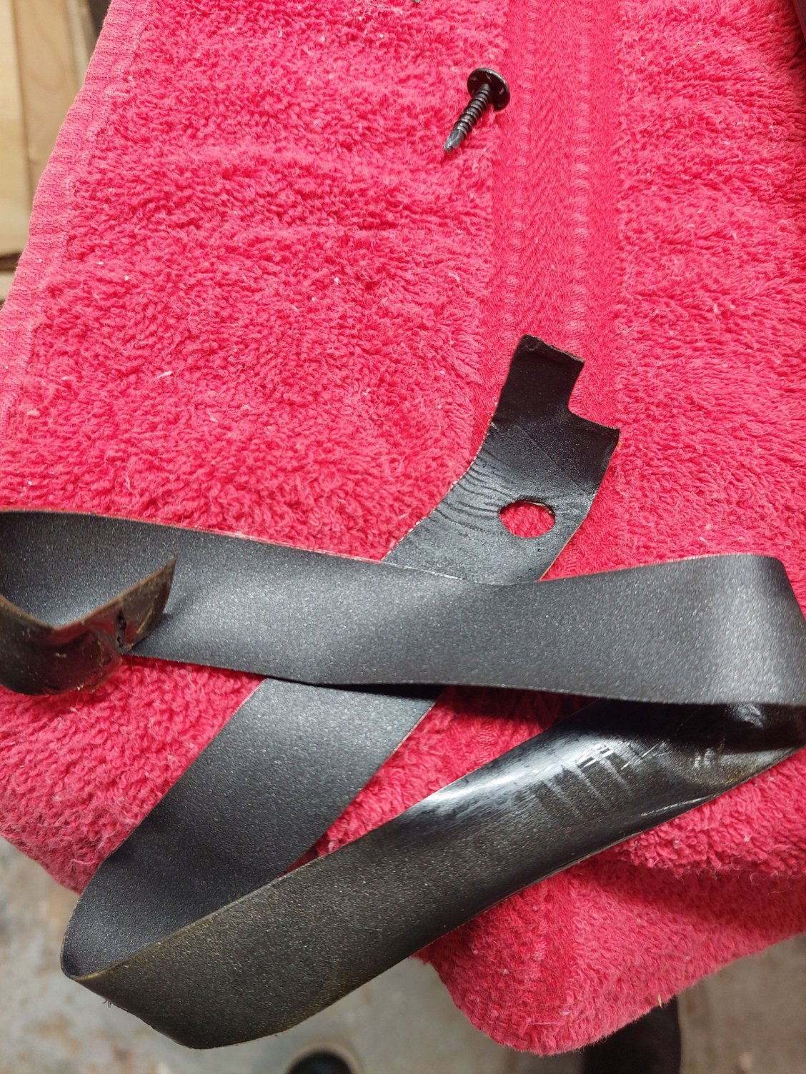

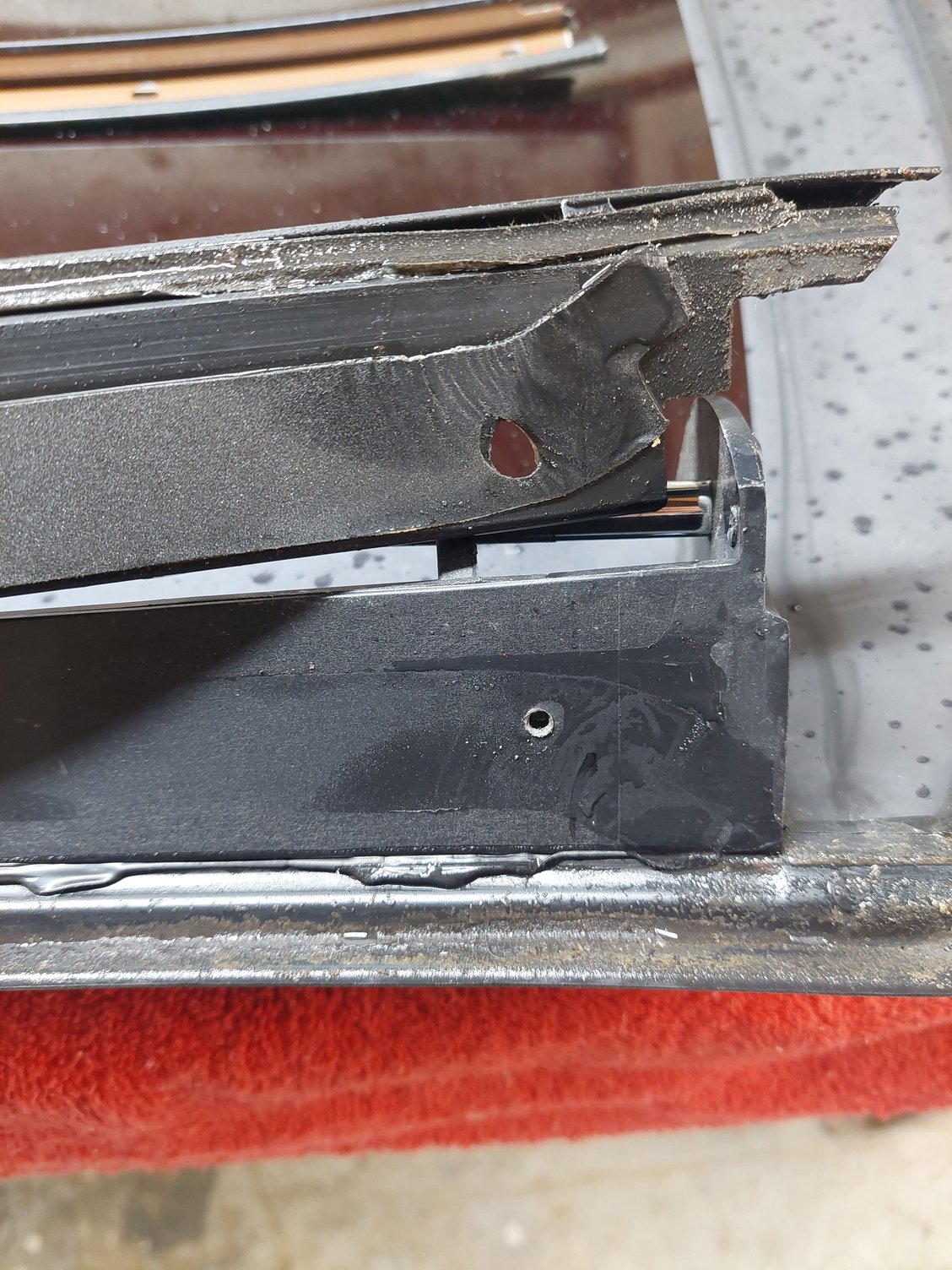

I just fixed a leak in one of my t-tops, turns out all I needed was some wide 3m double sided tape. Hopefully the pictures are enough to show what I did.
I pulled the top off while it was raining and actively leaking so I could find the wet locations and find the leak.
I wish I took more/better photos. But this 100% cured my leak.
You can see the wet spots where the seal failed.
The old foam seal I pulled off
New 3m tape applied. This is the trim piece held on by 4 philips head screws behind the larger foam seal thats held in by two 7mm screws.
