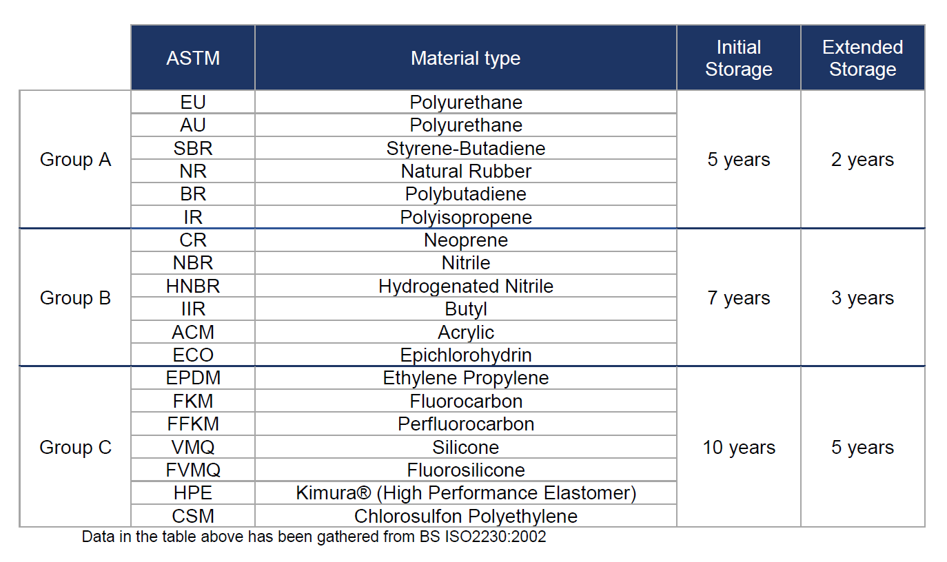

I have been doing (probably too much) reading about rubber bushings lately as I gear up for bushing replacements on my truck. I have seen articles, which I cannot substantiate, that imply that repeated use helps re-distribute preservatives in the rubber and wards off some of the natural aging that will inevitably happen. I have also read numerous articles that point to loss of plasticizer chemicals over time as the reason bushings become hard and squeak. There are some interesting videos and articles that provide home remedies for restoring plasticizers. (AT-205 Reseal, Wintergreen Oil, etc.) I won't link them because I can't substantiate them, but they are interesting to watch. I'd probably experiment with them if I had the time. I can't afford a 2nd shot at these repairs, so I'll probably bite the bullet and press out my bushings.
