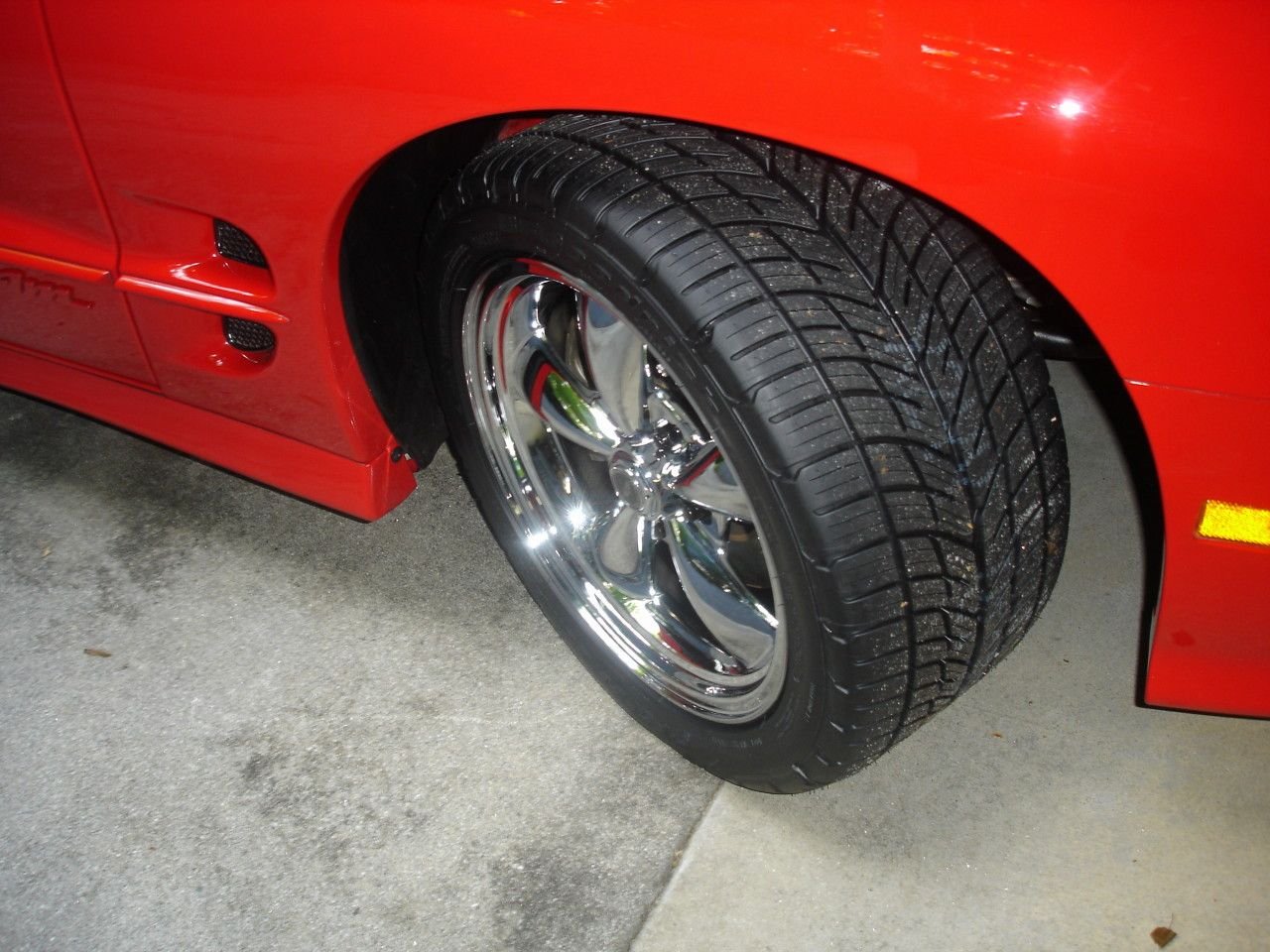

Yes, replace those 10+ year old tires. Looking good means nothing. Interior belt failure, especially at highway speeds, can be serious. Your life is more important than cranking out a few more miles. The BFG G-Force have been very good for me the last two times I have purchased them. They certainly don't break the bank either, plus MADE IN USA.
Enjoy your new ride. You are doing everything right so far. I've been down your path many times, from old Monte Carlos to modern sports/ .muscle cars.
Please post some photos when you can.
These are the BFG's on my T/A. Taken June 2022.
