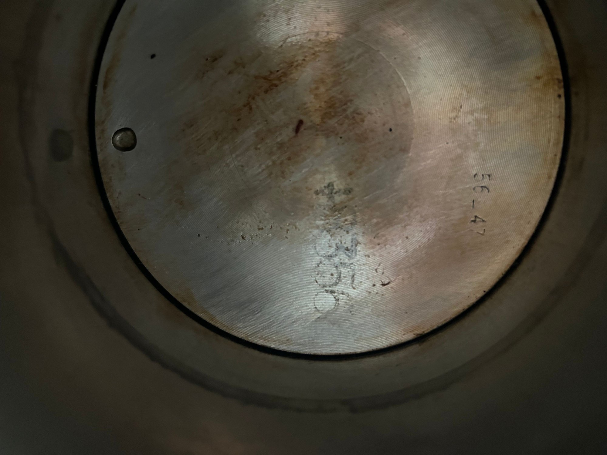

I dont really know what mods are done to the engine other than what I found online. I did not do anything to it an thought it was stock but ow it looks like it has a Stage 3 Vengeance cam. I did pull the heads and oil pan prior to install to make sure it looked good and it has Comp Cam 7796 7.425 .080 push rods. The pistons are stamped 56-47
