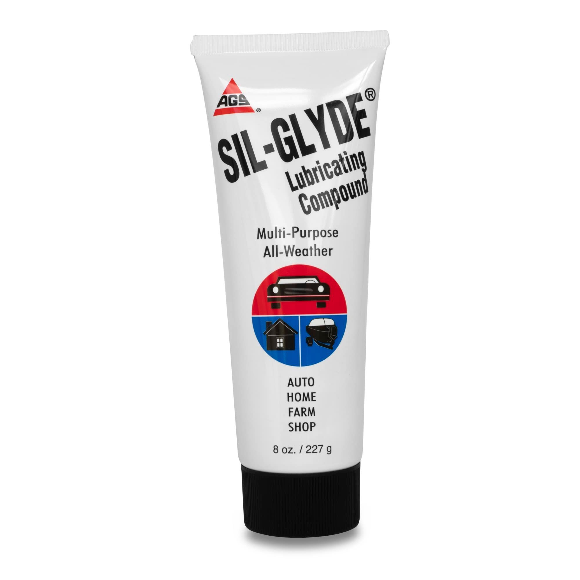

I agree with everything posted by wssix99 above. Also, the best lube choice for this purpose is this:
