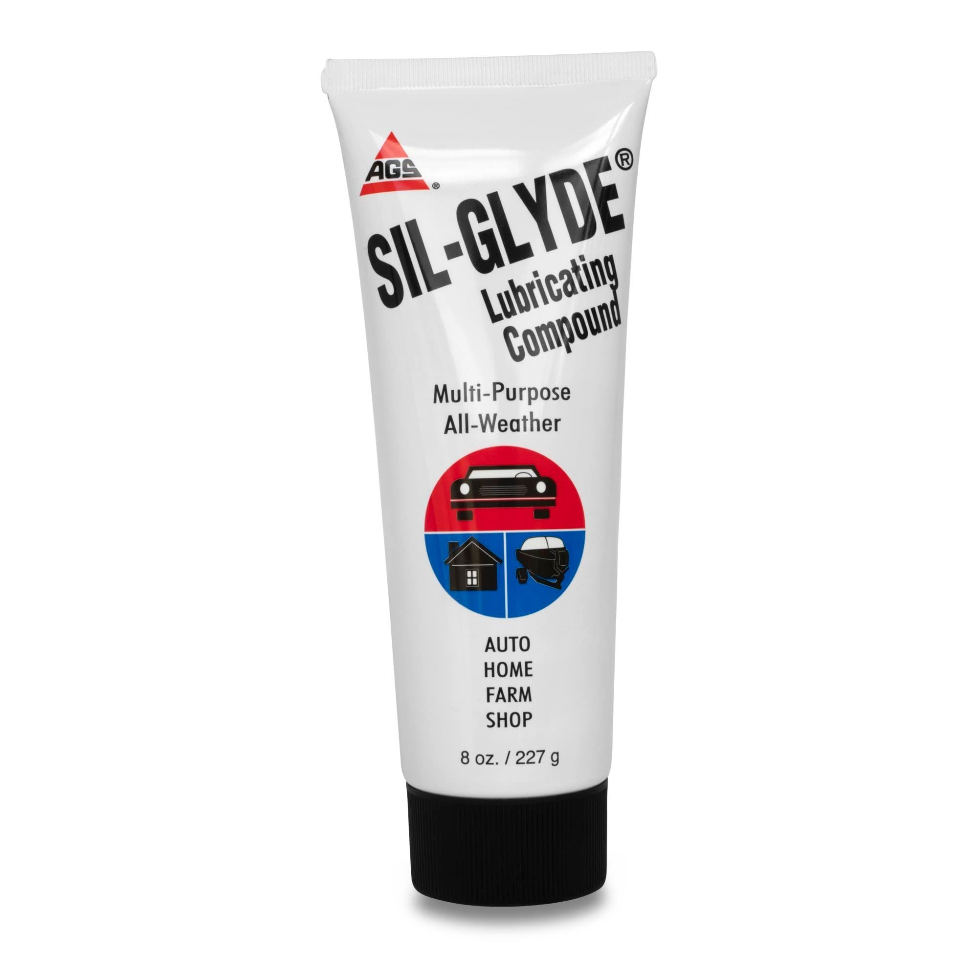

I've used this method myself, it is BY FAR the best way to do it - and makes future replacements easier. Also, while you are in there, consider lubricating the window tracks, etc, with this product:
