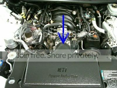

Originally Posted by Funkster
If you are talking about the MAF sensor foil, then no you don't need it.
Is that that one that sits here?

Yes, someone has de-screened the MAF on your car. There normally would be a screen in the metal piece that your air lid fits to. Some people take out the screen hoping for better air flow. The down side is that if you suck anything past the filter it will probably destroy the MAF sensor.
