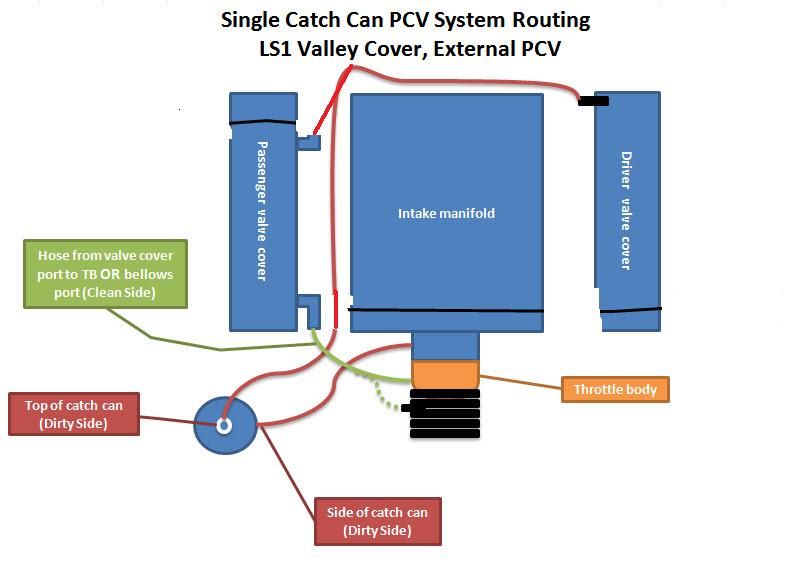

OK Guys this is how I have my current catch can run. I installed it how TLewis told me too when I called him when I was confused. At least I think I installed it right.
Now my question is why in the diagram in post 70 is the rear passenger side port blocked off?
If it's not blocked off, does that make the hose from the front passenger port to the intake manifold dirty?
If I do block off the rear passenger port, do I also need to block that hose I disconnected from it? I assume I would because then the system would be open.

I believe it would interfere with the clean side.
Just for everyones information, I got a whole assortment (a box with dividers) of rubber caps from Advance Auto Parts for like $5. It's got all KINDS of caps to block stuff off.
