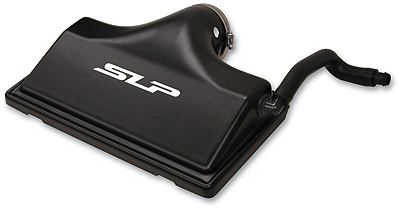

Here's another newbie question. The new lid came with a big hole drilled in the side of it and a hose. I think the directions said it's supposed to hook up with my AIR pump or something? My old lid (which was the same brand, SLP) didn't come with this. What is it for? And do I need to do anything with it, or just plug the hole?
looks like this:

Just plug the hole and youll be good to go!

here's my temporary solution lol
yes, that's a cork
