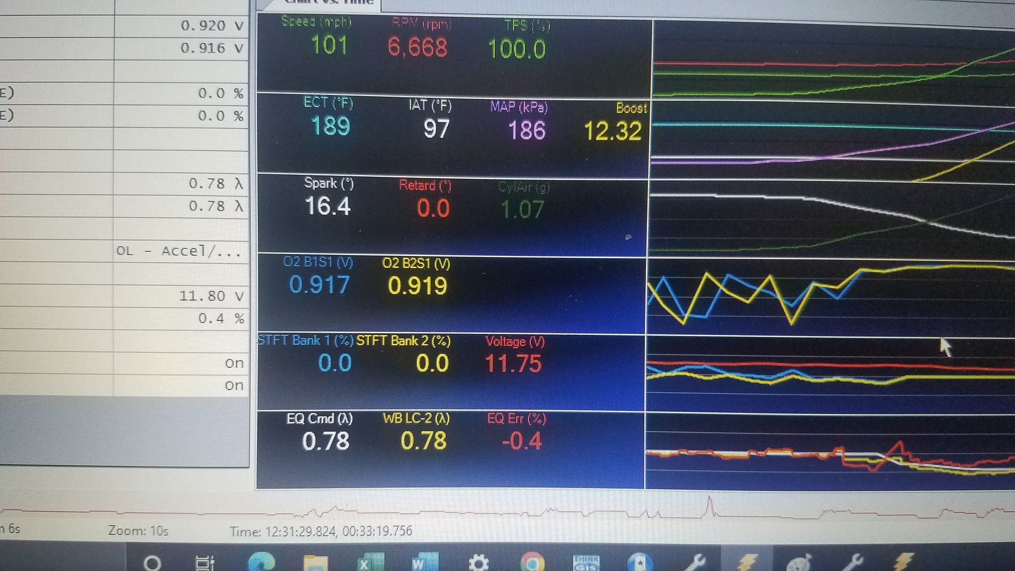

I wanted to post in here to get some idea's.
I have a 2000 Firehawk and have this problem for a long time. I just did the 145amp DR44 alternator swap last night and I'm still having the same issue.
When I first start the car the voltage is about 14.00v at the battery and HPtuners shows module voltage 13.6v
After the car runs for a while the voltage is about 13.7 at the battery and HPTuners shows module voltage 12.9-13.0v
I've replace the factory alternator several years ago due to the regulator doing strange things.
I bought a DR44 145 alternator at a local alternator/starter shop that we use a lot. The guy has been doing it for about 40 years and I've always been really happy with his stuff. When I bought the alternator he put it on his alternator tester and showed me it puts out 140+ amps under load.
Since I'm having the exact same issue with a bigger alternator, it's obviously not the alternator.
When I did the alternator swap I installed a new 4 pin connector. It has a NAPA/Gates belt with a Katech manual tensioner. I am 100% there's no belt slippage.
I'm kinda lost on where to go next.

After doing some reading last night, it looks like I need to do the big 3 upgrade. I logged voltage last night at WOT and my voltage problem is worse than I thought. Dual hellcat pumps, both fans running, a stereo and everything else, 11.7v is bad. It dropped to 11.5v a few times.

Sorry I haven't been around much so I didn't see this.
It falling to 13.7 is not a problem, and the modules reading a bit lower is likely not an issue either.
Are you having a problem with it? Or just wondering about the disparity in voltage between the battery voltage and HP tuners module?
Edit: I read your post saying it's dropping to 11.x
Your alternator is bad or being over worked and can't keep up. With all the add on electronics I would recommend going to a high power aftermarket alternator, doing the big 3, and making sure you have 8 or so gauge high quality OFC wiring going to your fuel pumps. No cheap CCA crap. If you go to a stereo shop they will know the difference between cca and ofc, one stands for copper clad aluminum, the other stands for oxygen free copper. You want ofc
