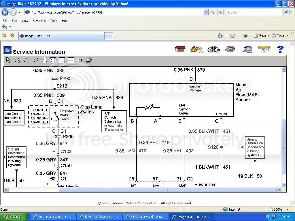

I haven't heard of anyone doing this, but I noticed the 85mm MAF has an IAT built in. I can get some pins off my uncle and rewire my harness up front to use the IAT in the MAF and eliminate me having a separate sensor.
Here's what I found.. I still have to find the schematics for the Camaro, but I found the ones for the Vette.
Purple and Tan wires are for the IAT (Vette)
5pin MAF

Done.. Got some pins and a crimper from my uncle.
