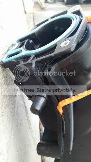

Originally Posted by DietCoke
(not mine so dont ask any dumbass questions)
Wouldn't recommend boosting, for obvious reasons.
What PSI did it crack at?
About 15 lbs per YB thread

Broke at the sonic welds..I would of epoxied it together an ran it
