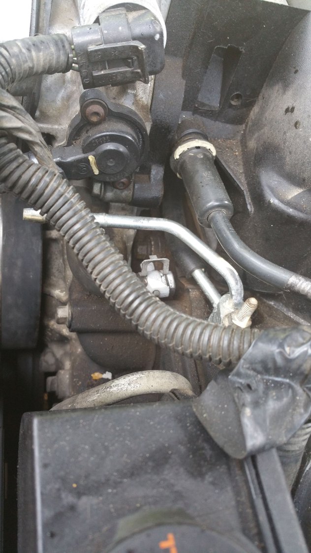

How does this hook up? I maybe think the company I ordered from sent the wrong one. Too late to send back because im just now installing it. It didnt come with the small hose attached.

There's a small line that runs from the crossover tube directly to the port under the radiator cap

yep, attach a rubber hose to that and then run that rubber hose to the fitting underneath the rad cap

what ever you do, do not cap off this line, make sure it has a route back to the radiator. It is the high point vent in your engine block cooling system.

If you are working on a F body, Do Not connect the hose from the crossover to the port directly under the radiator cap. That port goes to the over flow tank. There should be another port about an inch and a half under the radiator cap that goes directly into the radiator. That is the port that you attach the crossover hose to. Also, that is not an LS 6 crossover tube. The LS 6 and the LS 1 tube have a short tube coming out of it that would connect into the rubber hose that has the spring clamp on it.

Are you sure? That's how it's been hooked up. I'm about to go outside and take a quick pic. I hope I didn't damage anything

Ok I just looked outside. It's hooked up correctly. But would running the wrong crossover such as the one I have on it cause the cooling system to not have pressure?

shouldn't cause it to not hold pressure, but it can cause it to not vent steam and leave you with a good air pocket in the engine.

I'll order the correct crossover tube.that's exactly what it's doing.It seems to try to run hot but it doesn't.The needle good a tad too the right from the middle then settles back down to the middle.
