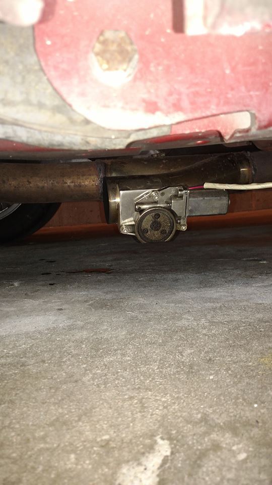

This is what I would do and what I did. Lt's into your y pipe then into a electric cutout and leave the catback stock for now. Who knows you may like the sound of the stock cat back after adding Lt's and have fun with the cutout. Then down the line pick out a cat back if you want

The stock I pipe in the cat back is 2.75 inches so a decent exhaust welder should have no problem welding in a 3 in. cutout in there

Quick picture of mine
