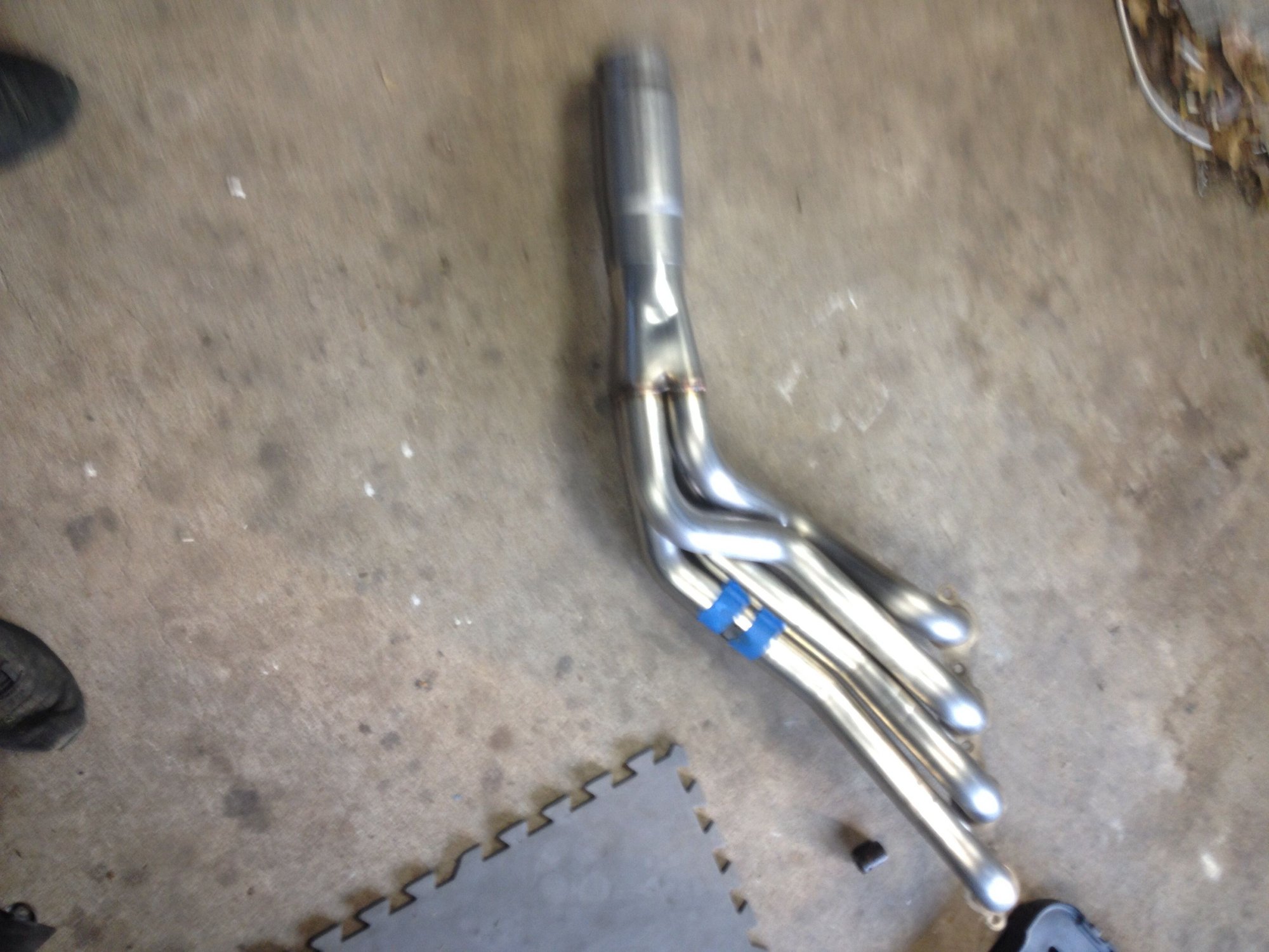

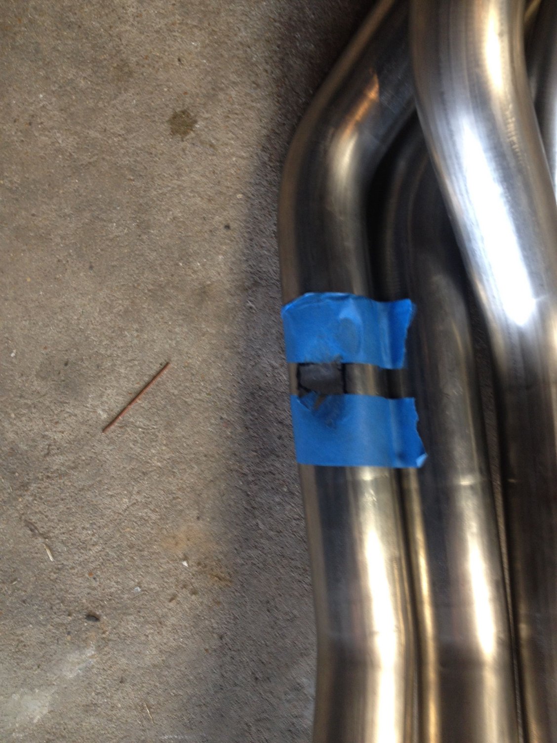

Little update. Tonight removed the passenger header and my fix and one I was comfortable with was putting a slight dent in the header. About 3 hits and was done.

I just had same problem with the passenger side hitting my bmr k-member in the exact same spot
Did you fix it like me
Not yet. That's my last resort lol

Originally Posted by Fullblast
My old long tube headers got a leak in them. I'm gonna get these 2" headers and a custom 3" exhaust with x pipe through some bullets.
What size tick cam are you running man? Are you using slicks?
Be prepared to have to modify k-member or headers. This is the second aftermarket k-member that hits in the exact same place
I have a grinder lol. It doesn't seem like you have to take too much.out of the k member that will hurt anything.
