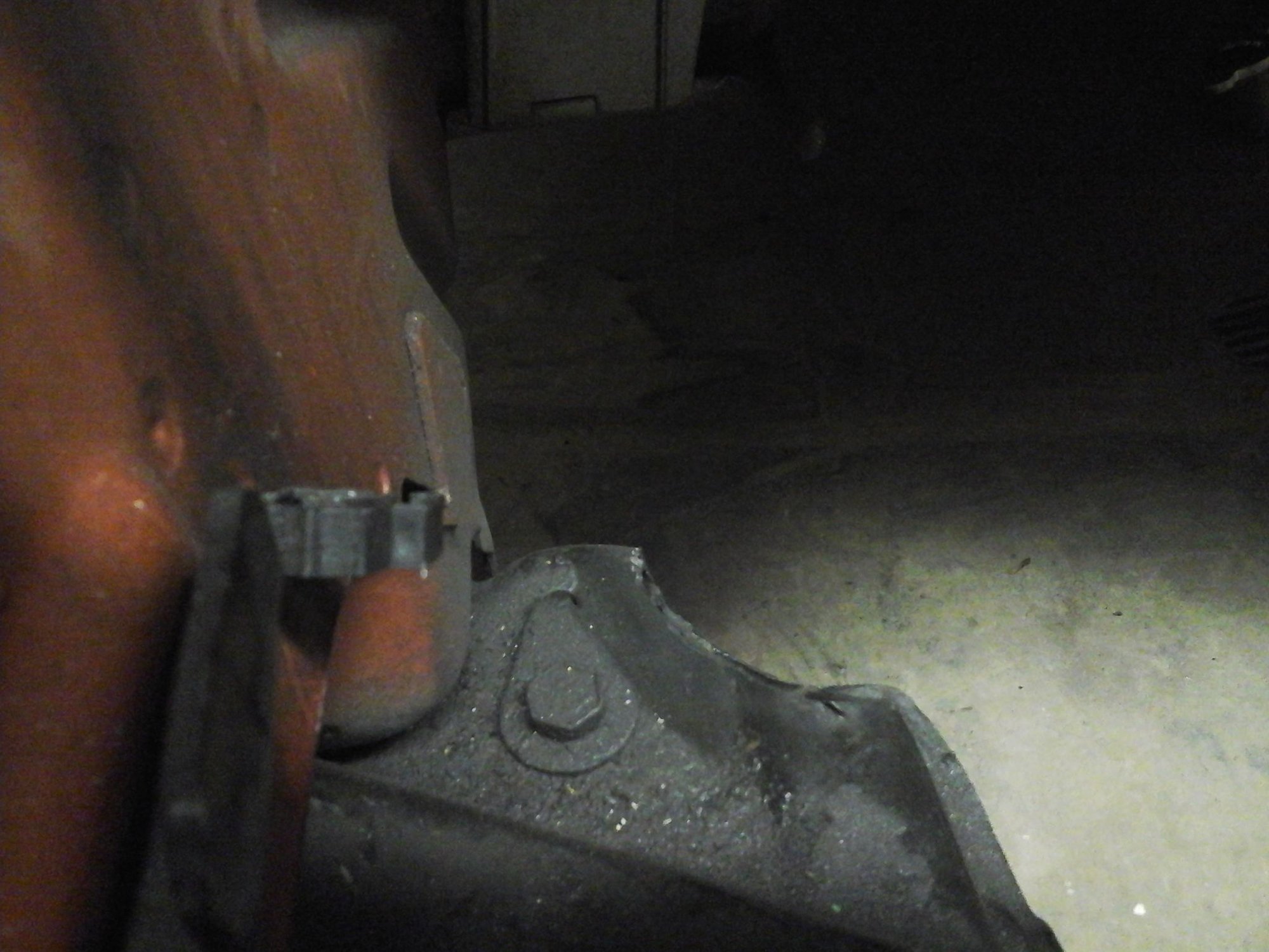

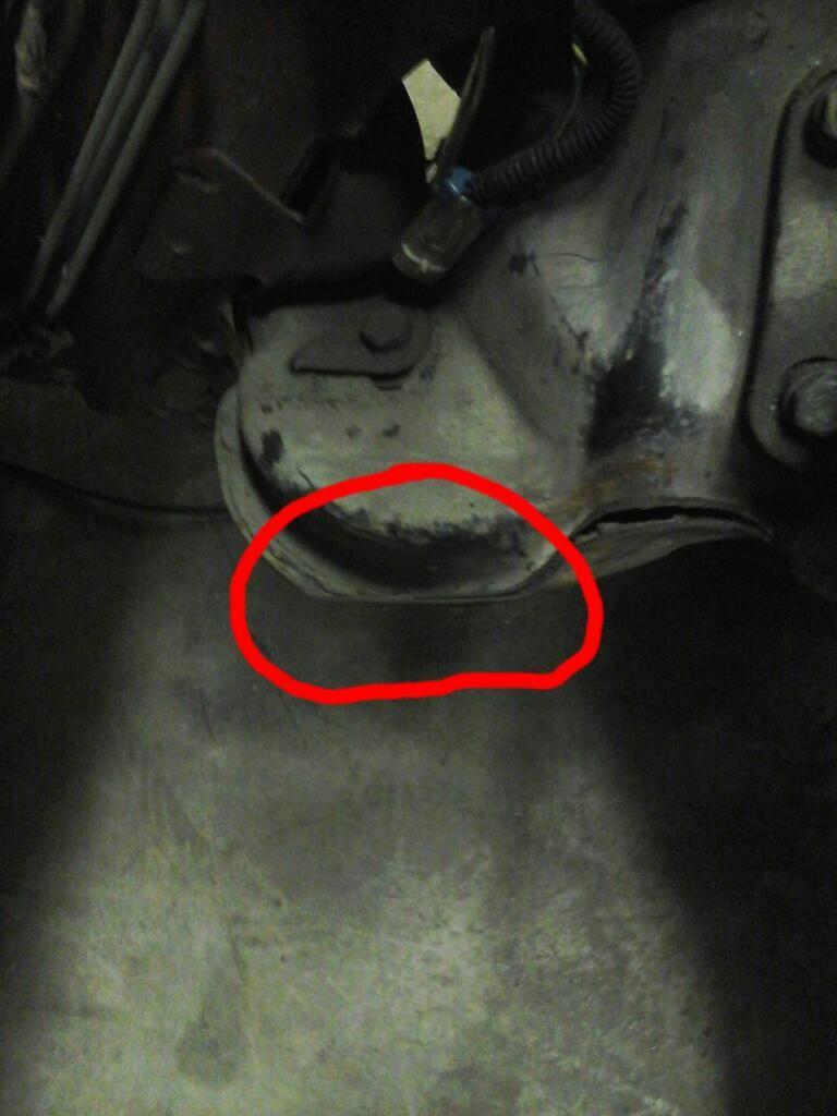

Stock k-member with poly motor mounts. This is passanger side.
Drivers side. Justthe seam in the circle needed trimmed flush. The other spot yo see cut out was for the previous headers on the car.

The headers on car prior were LSXPerformance. They were the first ebay type headers without emissions about 6-7 years ago. Cant comment on performance gains because I changed the whole drive line. On the passanger side though I plated the cut with 1/8" and still have over 1/4" clearance so you could get away with cutting less out. Drivers side was just barely touching that seam so I cut it back flush for goos clearance.

Im sure it definitely was. I have a bare block and heads i use for mock up on cars. Im sure its possible to do with motor in car but it would be tough. If you have the AC completely removed you might be able to get a 4" angle grinder down there from the top but Im betting most work on passanger side will be done with a die grinder. In all honesty I think the interference was less than a 1/4" on passanger side, but I'm going to be throwing some good power at this girl and wanted the wiggle room.

Im sure it can be done with driveline in car. Make sure you have access to prpoer tools before starting though. On drivers side a reciprocating saw would easily cut the folded seam off ( I used a cut off wheel on angle grinder ). On passanger side it could all be ground out with a die grinder with carbide bits ( this will take a bit), I used cut off wheel, gringer and die grinder. The real question to ask yourself is, is a 2" header required? If not is it worth the hassle when a 1-7/8" header will bolt right in? Not trying to stear you away but I'm trying for 800+ to the wheels when I spray this car so I feel the 2" are worth it.
