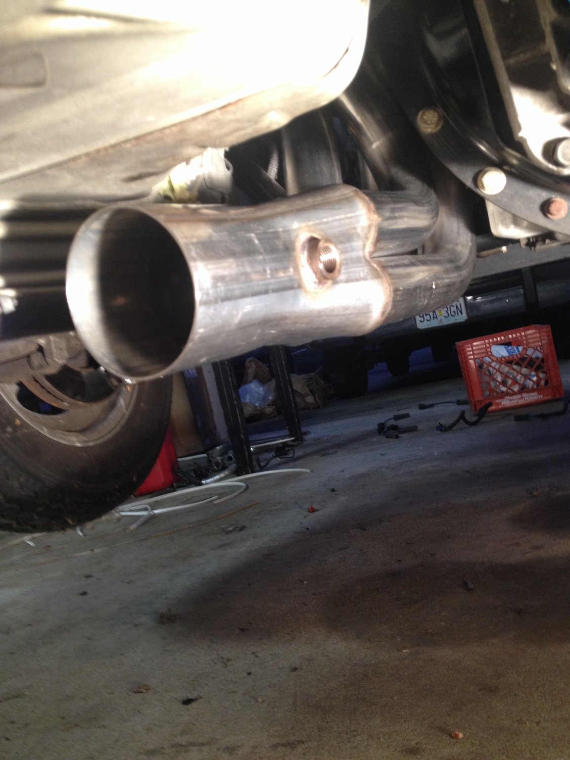

Well received my headers today. Removed them from the box and look great so went straight to installing them. Sunday I removed my old tsp ceramic coated mild steel 1 7/8 headers and custom y-pipe flowmaster merge and dump which all is for sale cheap.
My car is more street strip and has a MWC K member, hvac delete, cowl is mostly cut out all this aids in the install. Got underneath the car with drivers side header and slip right up with out issues did not remove oil filter or plugs or steering shaft just went in! Tighten bolts and all clears great. Passenger header just like drivers side slid right up and bolted it up! Found one spot where the header hits the K member really is just resting on it and will rattle if not fixed. May try and pry it a bit or will put a very small "dent" in the tube. Bottom line they fit great, look quality. The one tube resting on the k member is a tiny problem to me when you have a header this size and other aftermarket parts and shall rectify that issue.

Yes. Only the one tube on the passenger side. Driver side was perfect. It's more like resting on the k member and would cause a rattle. I will play with that side tonight.

If you come pick them up 200 bucks. Overall they are in good condition and slight rust is starting. As far as stock K member I am sure it would be a pain like any header install with stock k member. If someone is going to try it be prepared to modify and grind I am sure just like TSP stated. These went in about 45 minutes with a tube K member and like I said it's just resting on part of the member. I can pull on the header collector and it doesn't touch it's just right there lol. No complaints from me, if it hit in 3 or 4 spots I would say something. But this is hot rodding and slight "dent" or bend will not affect anything or think less of these headers. Great quality and we ask and Texas speed provided at a good price.
