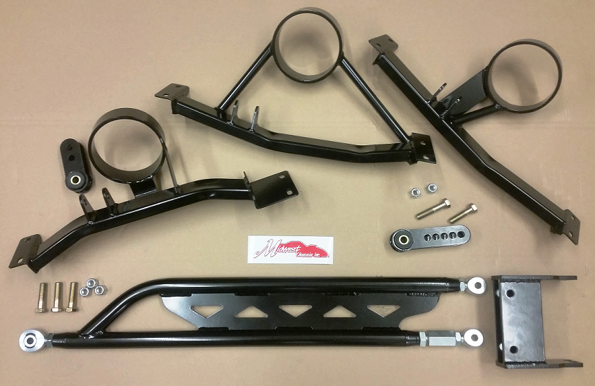

Our Double Drop is the only one on the market that I'm aware of that fits the bigger Y-Pipe exhaust systems with a tunnel mount or a crossmember for a true dual or X-Pipe system.
Here is a picture of all our different crossmembers. We do now offer what we call a turbo crossmember for forward facing exhaust. It gives the most ground clarence over anything else available.
Thats some slick hardware! It looks like you guys made a wider more gradual drop down brace. Thats the ticket! I know its still tight but this is the best design possible to accommodate a big merge given the constraints of the car.
