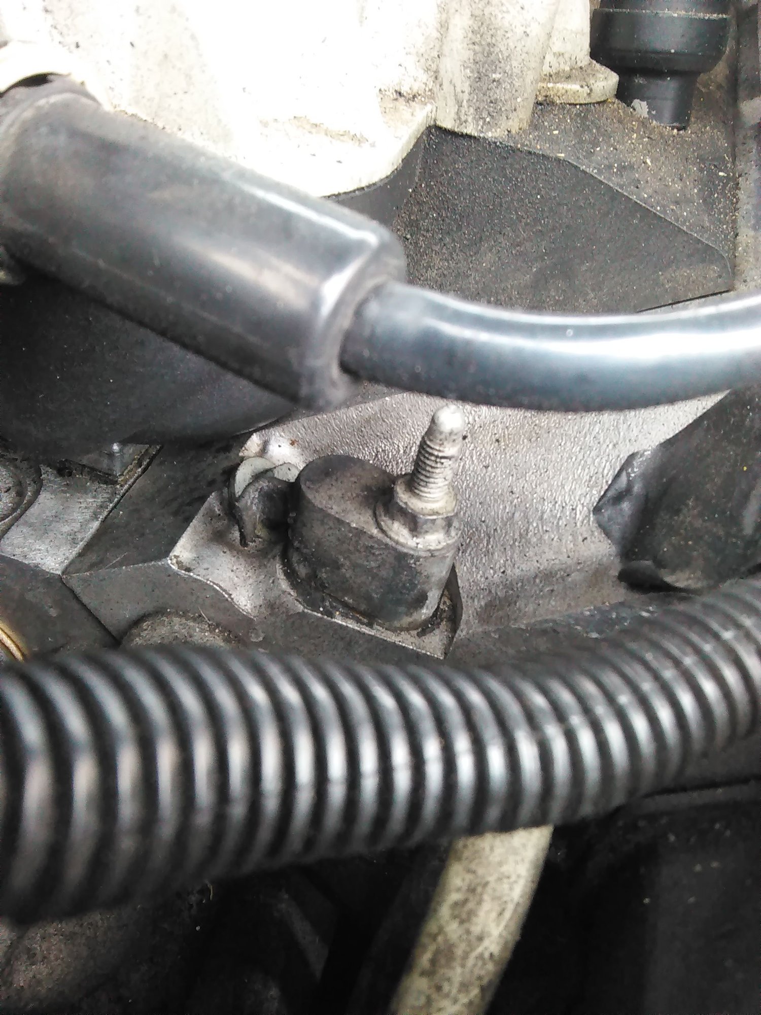

Originally Posted by Fullblast
I know this is not the steam port, but on the throttle body on passenger side there is a red cap and an open tube. Also on the valve cover there's an open vent. Are these supposed to be connected to anything?
Those connections are for your PCV - positive crankcase ventilation. Do you know if you have the LS6 valley cover?
This is the steam vent. This hose connects to the bottom port under the radiator cap.
Old Dec 30, 2015 | 11:57 AM
Darth_V8r's Avatar
Moderator
Joined: Jul 2014
Posts: 10,451
Likes: 1,873
If you have the ls6 valley cover it will have a port under the intake manifold on the passenger side coming out of the valley cover:
It's dead center in this pic. If you have this port, loop a small vacuum line to the red capped port in your last post. If you don't, you'll have the old style PCV, which means routing hoses to all those ports on the valve covers.
He has no ls6 valley cover.... and his steam ports are block off . I cant believe you guys missed that SMH...
Old Dec 30, 2015 | 02:37 PM
soloman369's Avatar
Joined: Nov 2006
Posts: 544
Likes: 12
From: League city, Tx
Holy shizz i just realized he's using stock valley cover bolts that fast is prob cracked...
Old Dec 30, 2015 | 07:13 PM
Fullblast's Avatar
iTrader: (17)
Joined: Nov 2015
Posts: 402
From: Houston
Why would the intake be cracked? Are the stock bolts longer? How would I check for a crack? Spray.starter fluid around the intake and see if it revs up?
Tomorrow I will hook up the steam vent. Couldn't get to.it today. Going to put antifreeze in also.
Old Dec 30, 2015 | 10:12 PM
soloman369's Avatar
Joined: Nov 2006
Posts: 544
Likes: 12
Your not going to find the steam port there blocked off. I can tell in the picture. Only way to check is to take the intake off.
Old Dec 30, 2015 | 10:39 PM
Fullblast's Avatar
iTrader: (17)
Joined: Nov 2015
Posts: 402
From: Houston
Yeah, I looked around and didn't find anything.
Why would the intake be possibly cracked?
Is it necessary to have the pcv equipment hooked up? Should I cap off that open tube on the valve cover and throttle body?
Old Dec 30, 2015 | 10:49 PM
soloman369's Avatar
Joined: Nov 2006
Posts: 544
Likes: 12
The stock valley cover bolts are to tall with every fast they need to be changed out to button style head bolts. The pvc stuff is there for a reason i would hook it all back up. If you have the stuff . If not search the forums for a diy.I'm amazed the tuner didn't catch it ither. I would get the ls6 cross over steam vent and get it installed . I know the temp gauge sensor is on the heads on the driver side . You got quite of work ahead of you. I recommend not driving it still these issues get sorted out. Before you hurt something .
