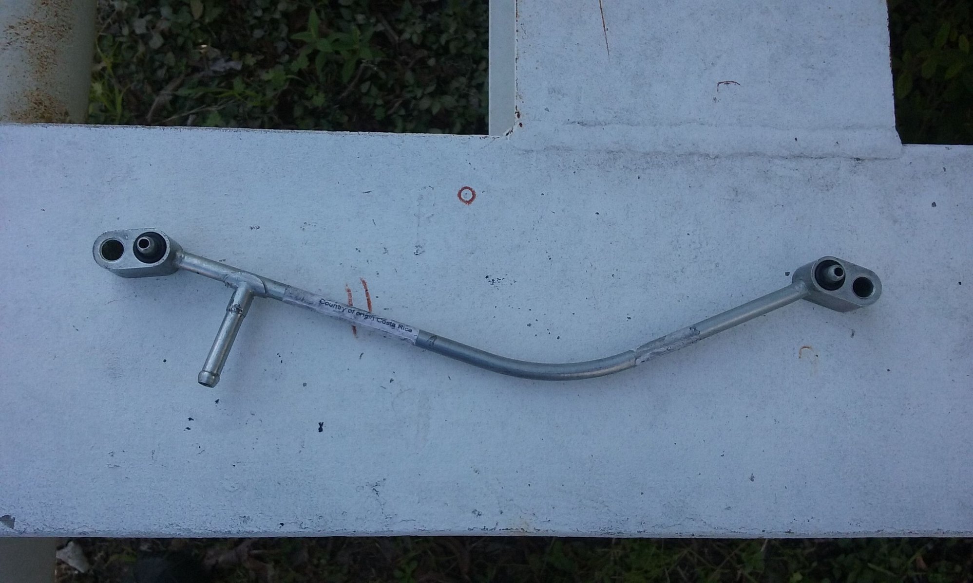

I recieved my steam vent kit. It was supposed to work with a fast 102 intake, but itvwont fit with the intake in place.
Will it be ok if I cut it in half and joined it with the 4" rubber hose it came with, so that it can bend around the bottom of the intake? I dont think it should be a problem, as I dont think it is a high pressure line. Any thoughts?.

It's not a high pressure line so you can do it. If you do, rent a double flaring tool. It will put a bulge on the pipe where you cut it so when you clamp the hose you get a positive seal behind the flare.
I actually bent mine into place but your solution is probably better.

Haha. My old man said just to bend it too. He also suggested cutting and attaching the hose if i didnt bend it.
I doubt anybody sells this steam vent that will go around the intake. C& R racing has a steam vent kit you plumb yourself, but its like $130 or something like that. Not worth the money to me.
When you bent it did it get any kinks in it ?

Nope. I installed with the intake off, set the intak down, made small bends until the intake dropped into place. All with the throttle still bolted to the intake.
