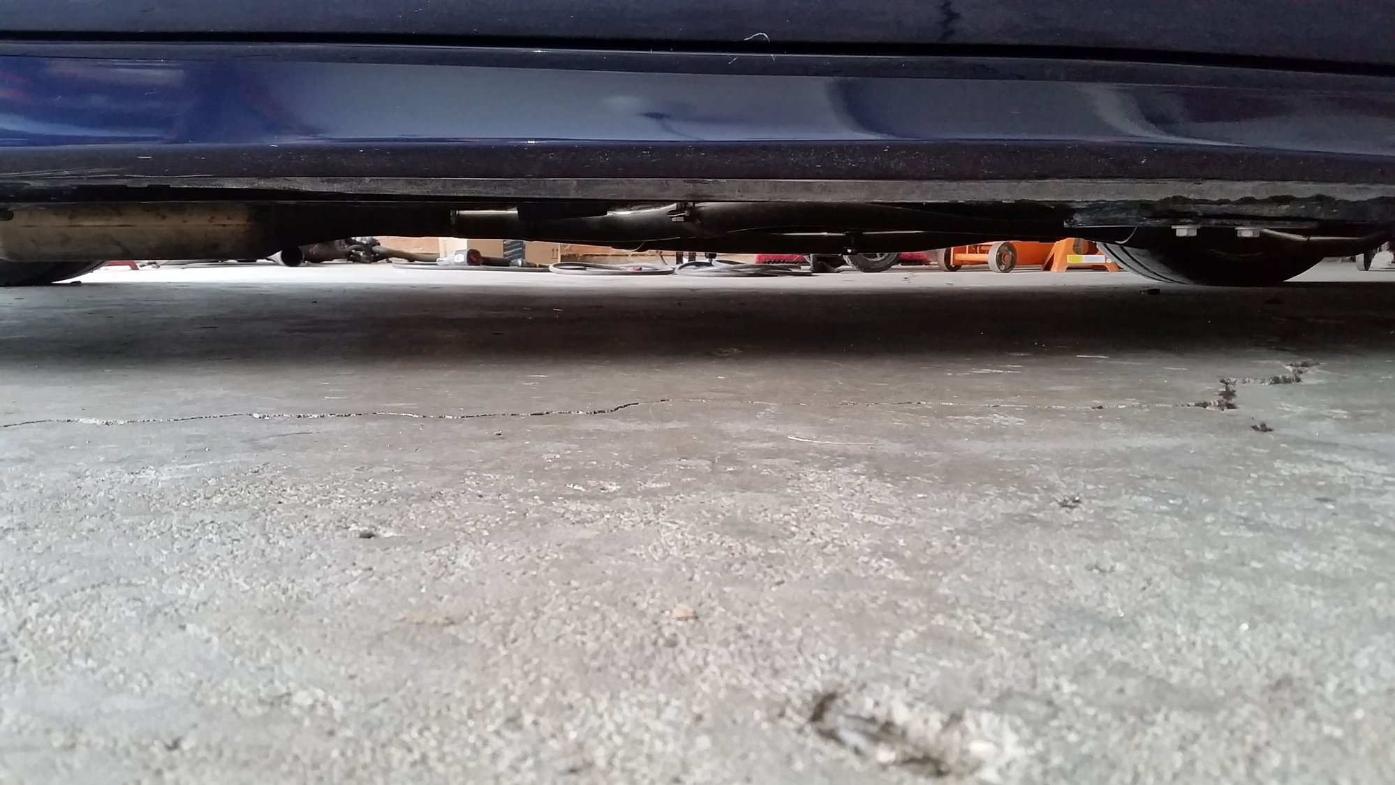

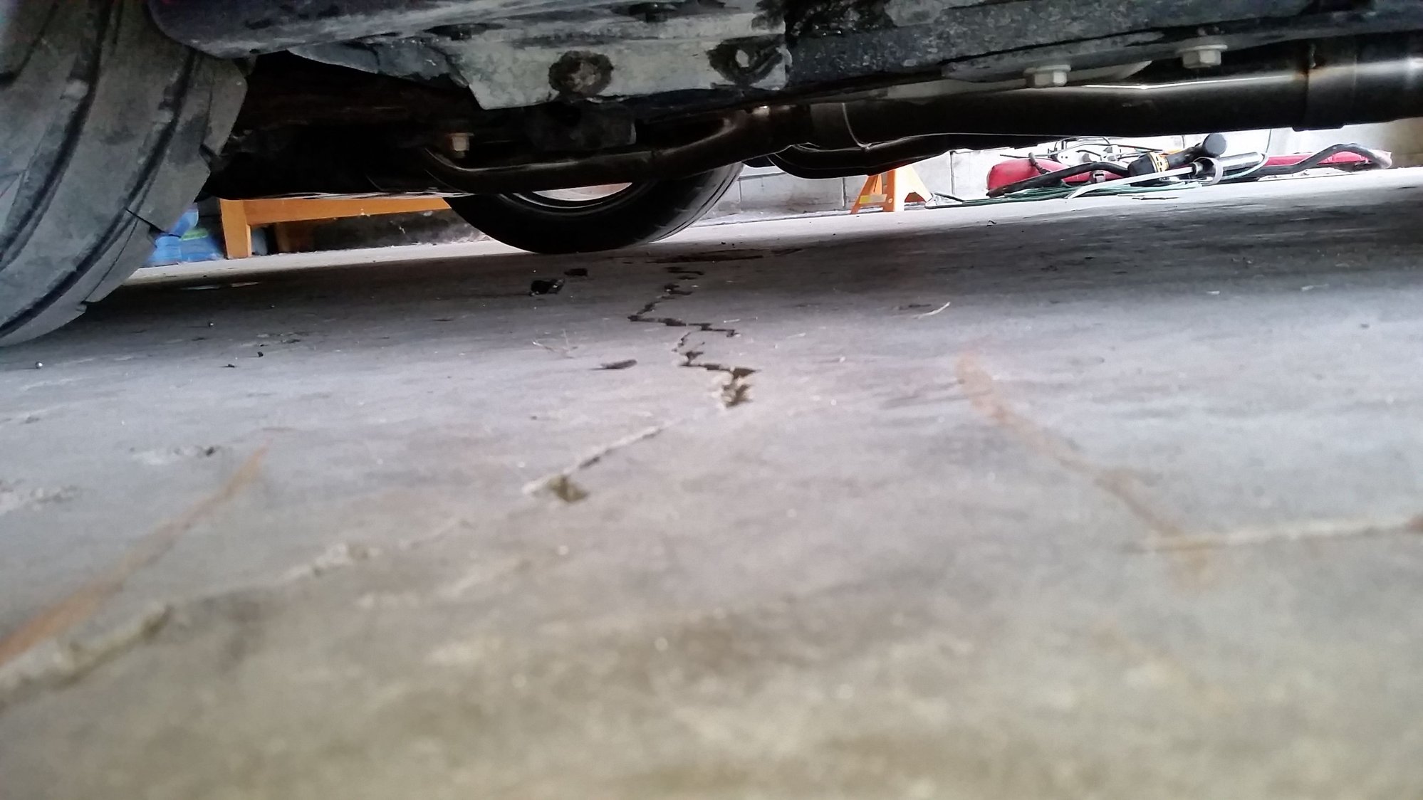

You will have plenty of ground clearance with 1 7/8" unless you are lowered... I'm lowered 2" and haven't scraped mine yet.. if you are wanting a sleeper and no cam in the future, I'd do the 1 7/8" with cats and and LS6 intake.. you could pull both mods for close to $1000.. then do a frost mail order tune for $150
