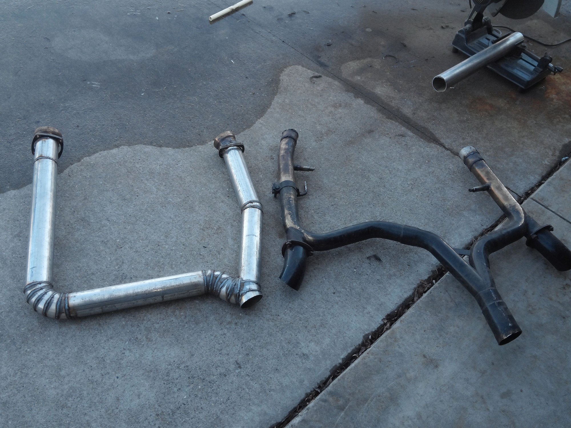

The one on the right was my old 2.5 set up that I added the dumps right at the bends an it sounded nasty! Nascar nasty lol an seems that it would Rev out harder! No dyno sheet but it worked well.. but got flicked so had to change it lol

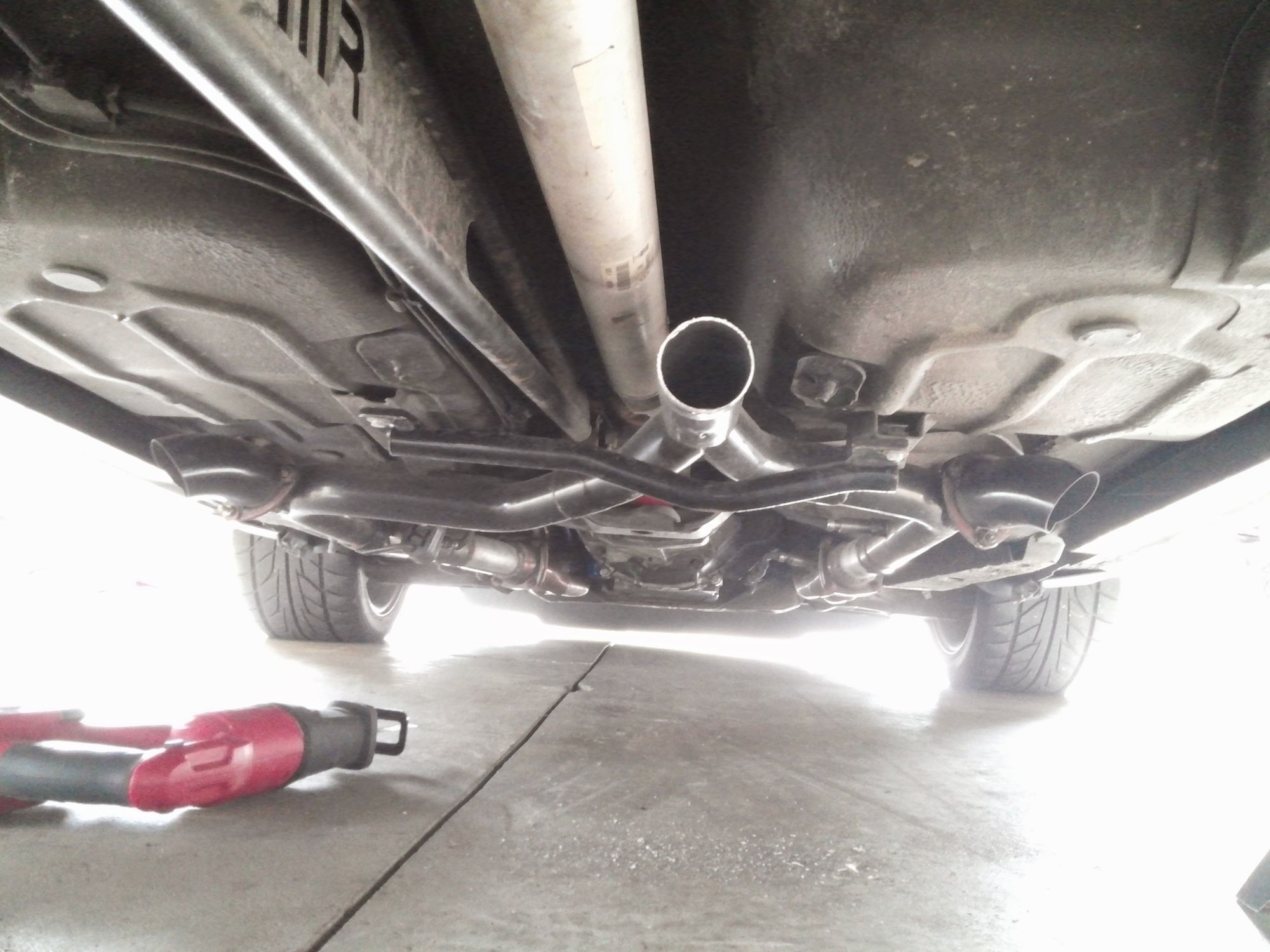

What it looked like under the car when I started cutting it off..

Why did you go with another setup man? Got tired of the sound or what?
I'm just hoping I can get the most out of my motor my old 1 3/4 headers and stock exhuast was killing my top end on the dyno and got some depressing *** numbers
Just put in 1 7/8 and about to do the cutouts
Old Mar 20, 2016 | 06:48 PM
Riddle0288's Avatar
Joined: Jan 2014
Posts: 107
From: Richmond, Mi
Well at the time my car only had 37k on it an i just did a cam, slp intake, 1-7\8 headers and it already had the 2.5 y pipe on it as it dynoed 396..always wanted to brake the magical number of 400 hp to the wheels "cam only"! So I did the manual dumps but when I got pulled over with a $140 ticket I debited an then just went with a full 3" y pipe and a slp2 an dump before the axel but got pulled over less then a week ago so got to change again :-( but never dynoed it after the full 3" inch but I'm pretty sure the 2.5 with the cutouts flowed a lil better then my 3" set up lol
