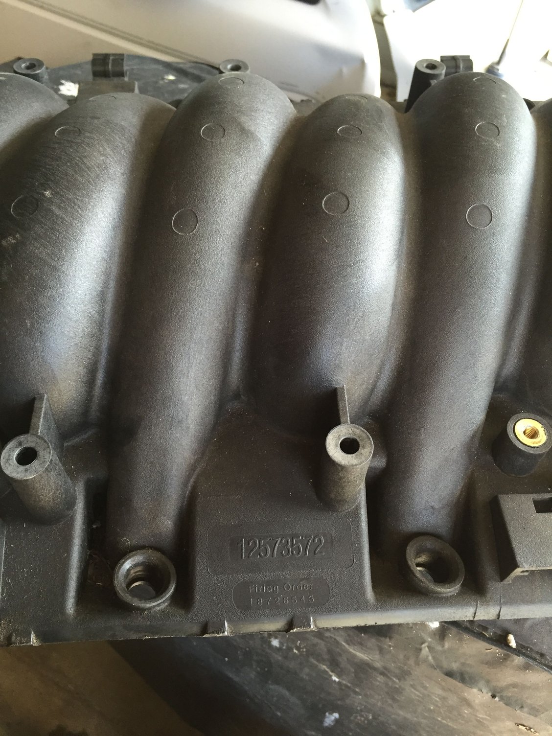

I have what I think is an ls6 intake with a massive hole for what must be egr. Does anyone know of a company that makes a screw on cap to plug this? If I've misidentified can you help out? I read somewhere there were some ls6 intakes that had holes for egr.

I've never seen an EGR like that. I could be wrong but it looks to me like someone rigged that up themselves to maybe pass smog on an EGR car? Most LS6 intakes didn't come with EGR. i actually think that none of them had EGR except the aftermarket SLP ones or something like that. I would go to Home D po and get a metal screw on fitting for it. You should b able to plug that right up and be on your way.

My ls6 intake had the same exact provision for egr as yours does. It's actually an easy fix. After you remove that brass fitting, get a freeze plug and put in there. I'll look at mine in a bit and tell you the exact size. I'll also attach a picture of it for reference.

That most likely is a slp ls6 intake . My slp has that I used a swagelok cap to plug it many years ago . Believe it is a 3/4 size you need. https://www.swagelok.com/en/catalog/...?part=B-1210-P

Here is the freeze plug, picked it up off the shelf at an auto parts store. The one I used is a 1 inch, which fit perfectly.
Installed:

I had the same SLP ls6 intake and I use the swagelock nut to cap it just be sure to put a little thread sealer on it.
