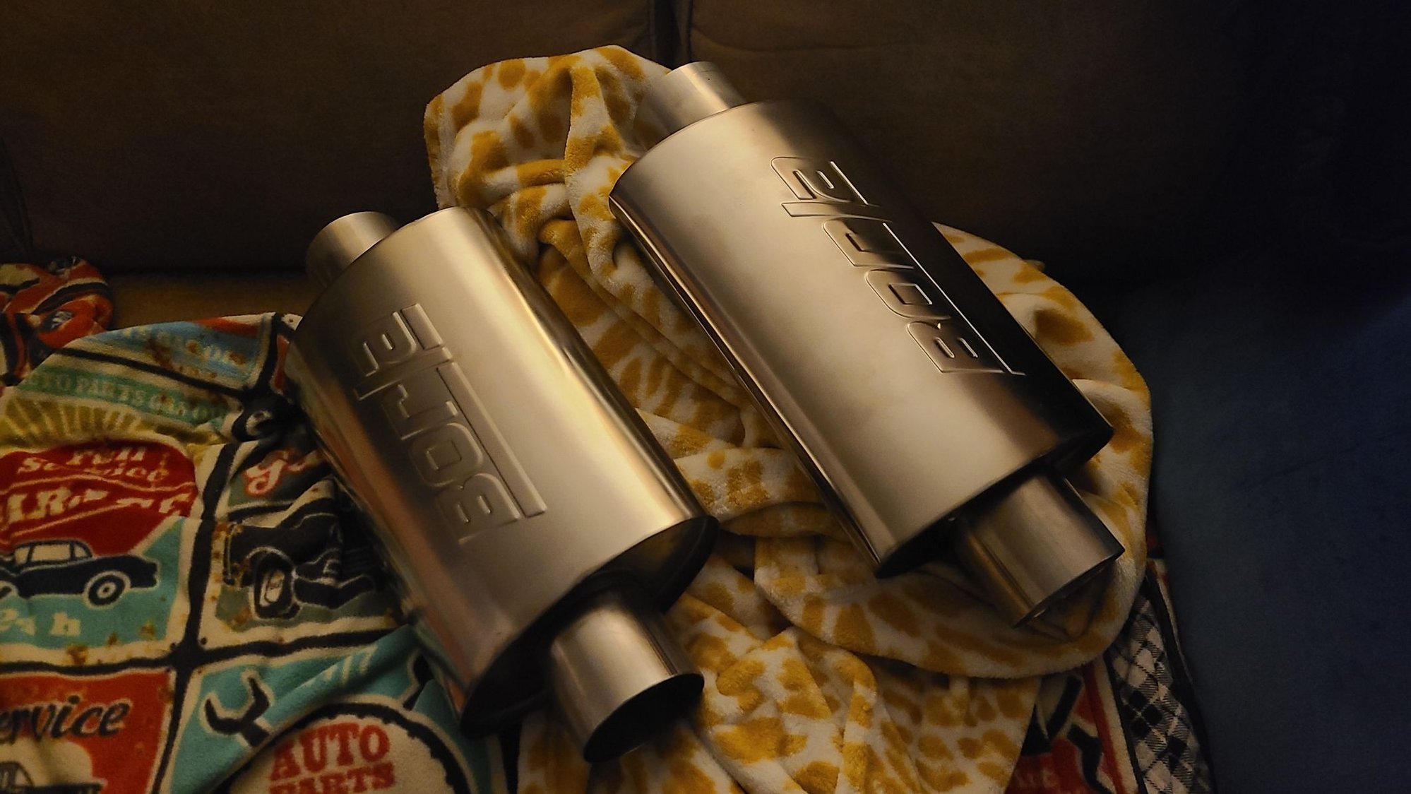

My son got the new Borlas in the house. Literally. lol
You can literally scream into them. They muffle
I'll try and get them welded in sometime in the next week or two and then more sound clips.

They are the 40943s and even though they look massive the body is literally the same length as the SE bullet muffler case.

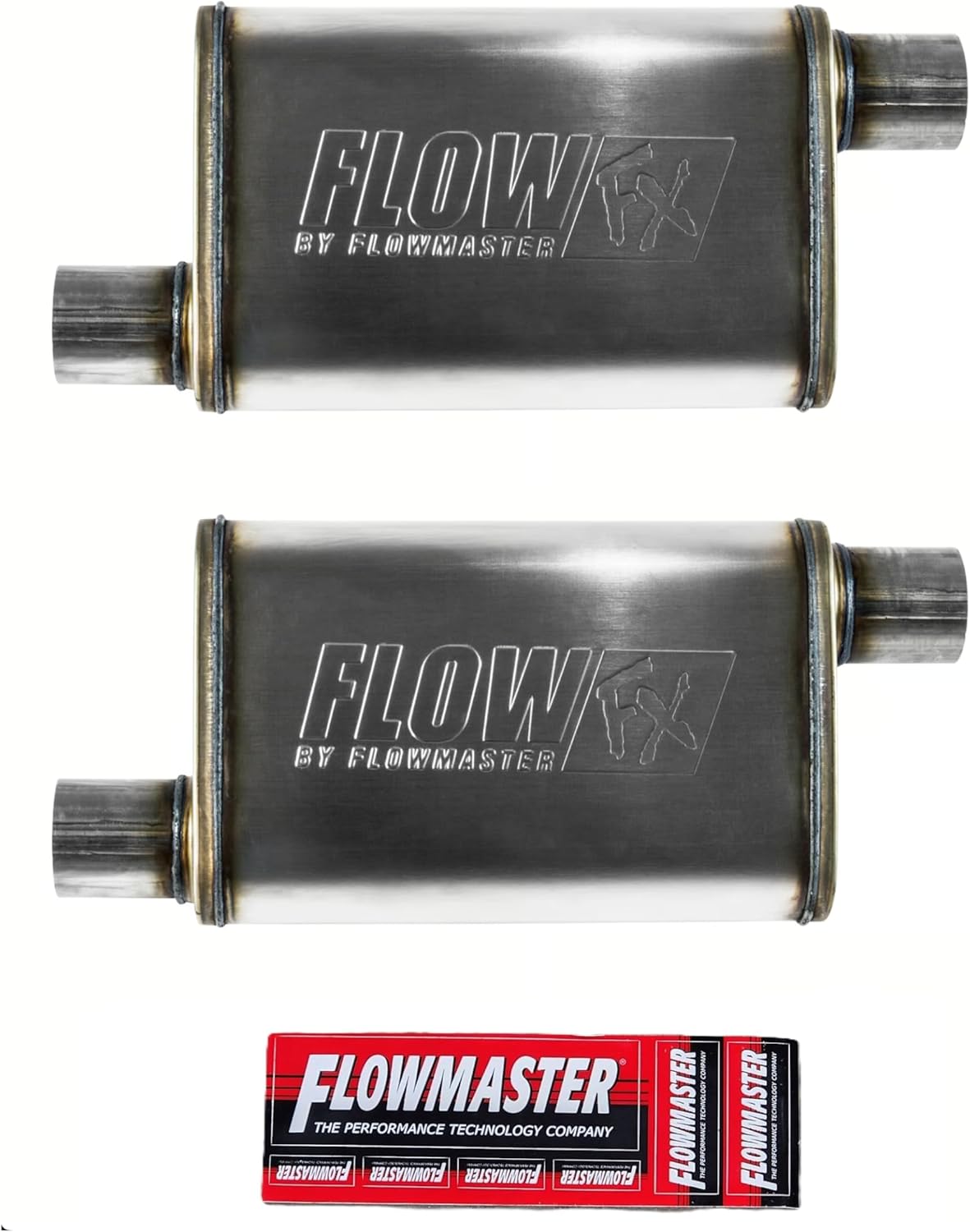

Totally different application, but I put a single Borla 40944 on my Tbss. It has a touch of rasp to it but sounds pretty bad-***.
I came up with a cammed Rcsb that had a couple of Flowmaster Super 10's dumped in front of the axle. It was obnoxiously loud with the typical poppy sound most chamber mufflers have. the resonance boomed in the cab under decel when I swapped in a t56, so they had to go
I ended up picking up a pair of their FlowFx which is really a magnaflow design (about $100 cheaper for a pair) that I love. Really deep tone, no rasp, no popping
Flowmaster 71236:

I've used Flow FXs before. They are excellent mufflers. Very good magnaflow substitute.
