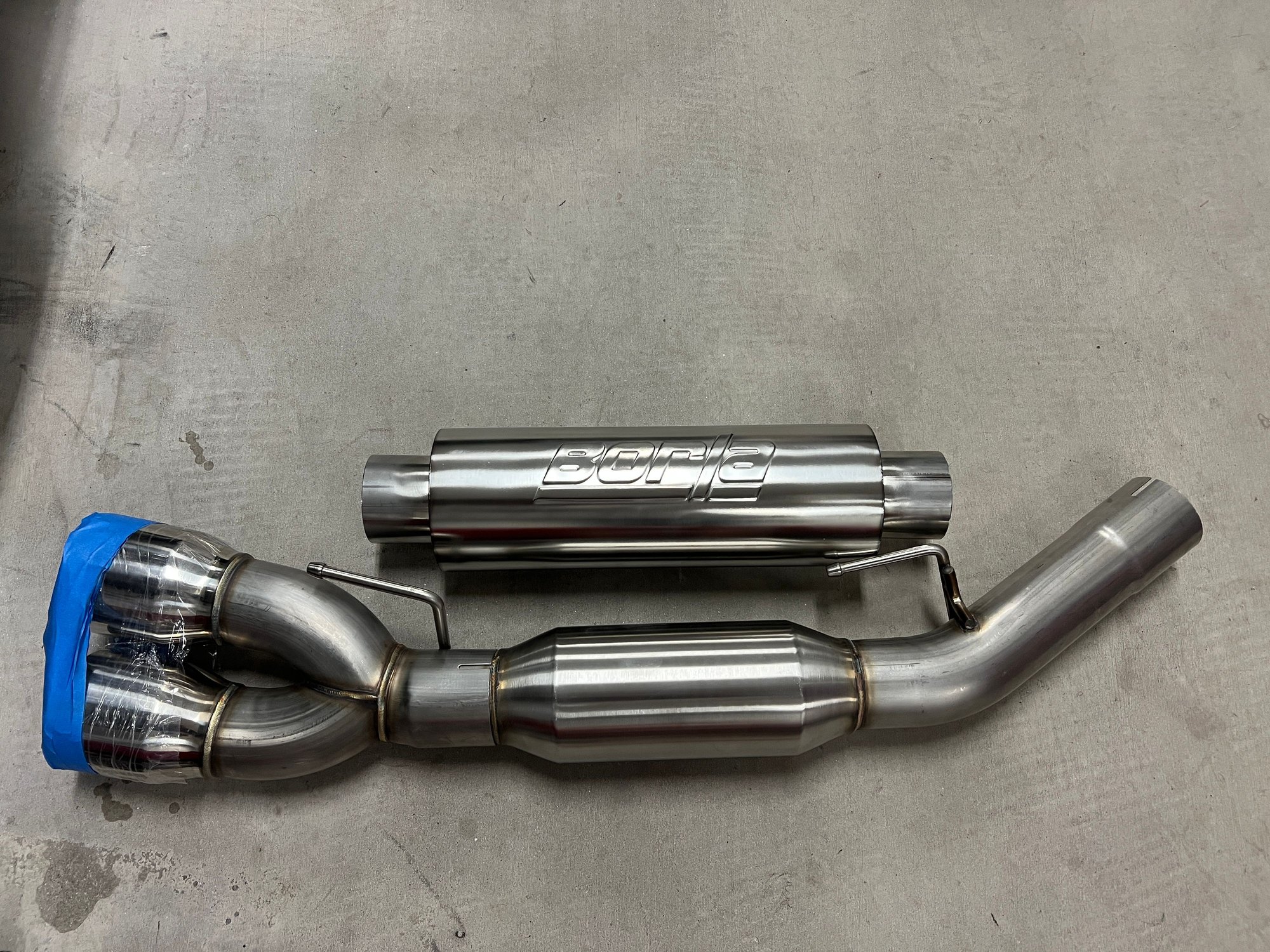

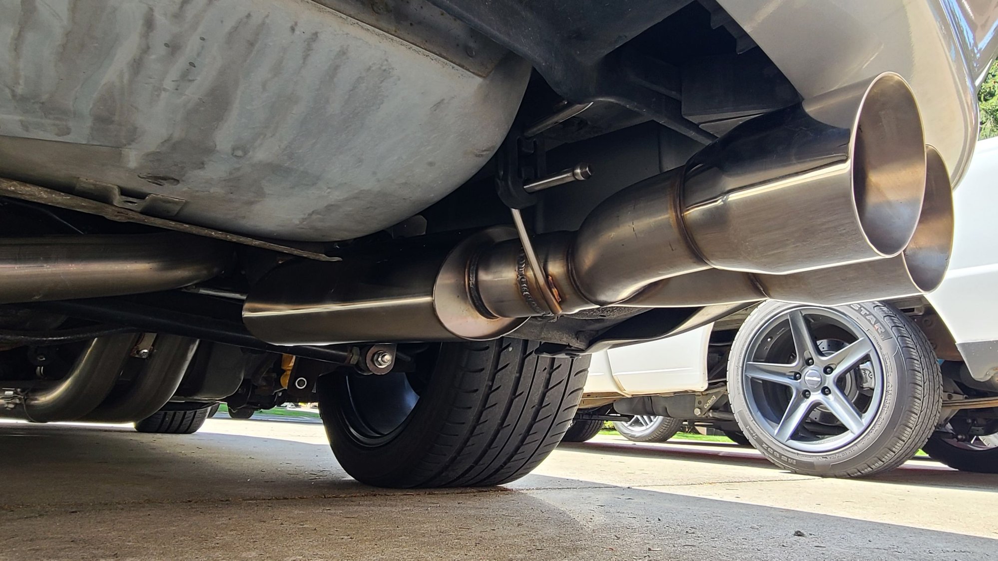

Originally Posted by gjohnsonws6
@Kingc8r Thank you for checking back in. I went with the 40085 but haven’t installed them yet. Now I’m wondering how you got them in there, definitely a tight fit. Waiting on Mr. Black to see how the ovals fit before I move forward any further with this.
@gjohnsonws6
You’ll need to trim the inlet/outlet pipe as well as the inlet side of the tips.

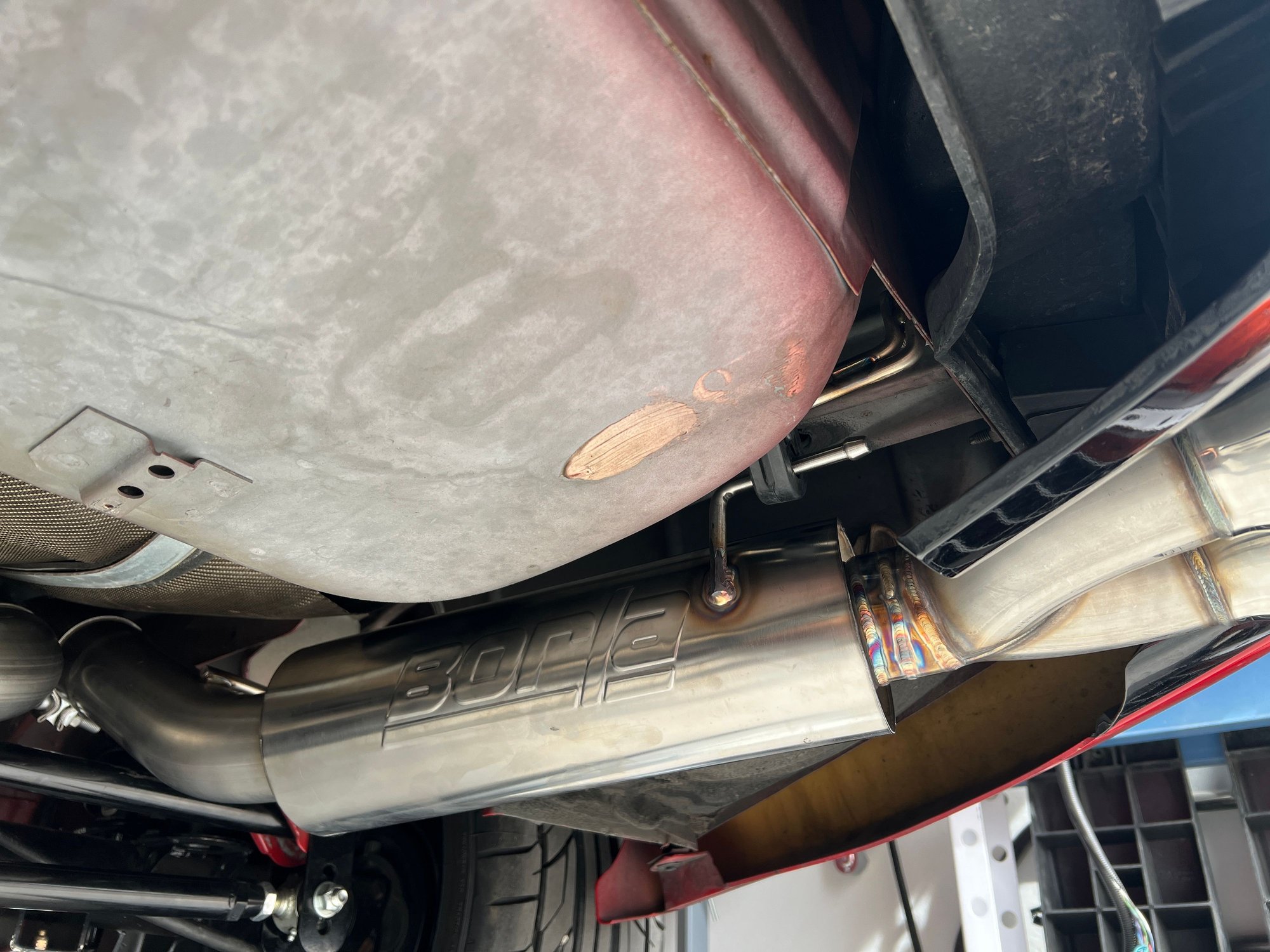

Originally Posted by Kingc8r
@gjohnsonws6
@Kingc8r
Thank you so much for the pic and advice! Normally I would tackle this on my own however I might sub it out this time around. I did get my system installed today and it is surprisingly quiet. I have not driven it yet so I can’t tell if there’s any drone. Currently have a heads cam L76 at the moment and a 427 is waiting to be installed that will certainly change everything sound wise.

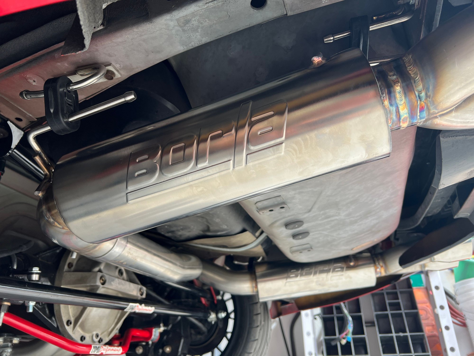

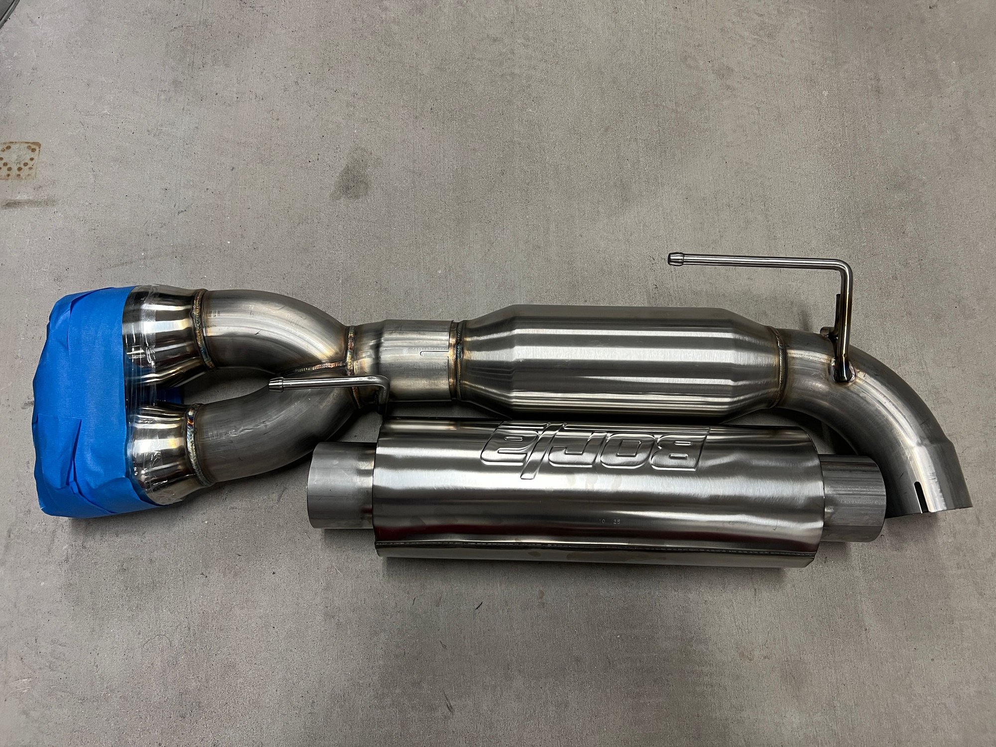

System is in, drove it around for a bit with the original mufflers. Wasn’t as bad as I thought it would be and I contemplated leaving them in however I did move forward with the Borla 40085 mufflers. I left this job in the hands of a very talented fabricator and he didn’t disappoint.
He switched things up a little on the drivers side pipe with a bend and pie cut. The passenger side rear hanger was also placed on the muffler to make install easier. It is quieter at idle, has a good tone and no drone cruising. Will get loud if you smash the pedal which is perfect.
No sound clip??

@gjohnsonws6 came out nice, glad it worked out. I think depending on engine and cam setup will decide how loud the system sounds. I loved how it sounded at idle and wot. Living where I live it was way too and would make the car a cop magnet.

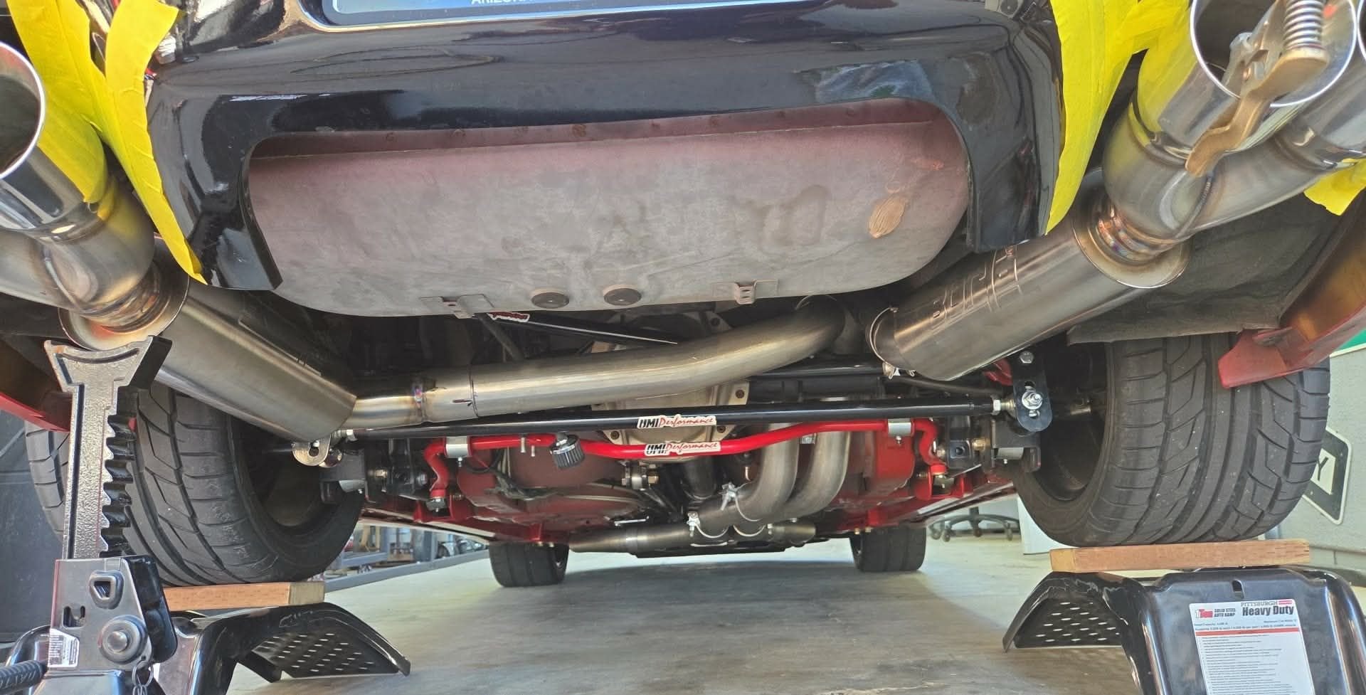

We finally got her done!
It is absolutely perfect! It is still hotrod loud on the outside but you can actually have a conversation on the inside.
I have really perfected my stainless steel exhaust tubing MIG booger welding! ****'s actually presentable.
Still pictures for now. May take another week or so for video presentation.
The oval bodies fit better than I thought they would!
