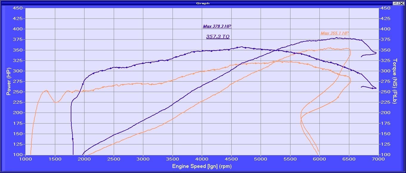

I had the breather on the PS side valve cover and my car was down in power. Felt like it was running fine but after I hooked up the PCV like it should along with a catch can I gained HUGE. Don't go the breather route. Trust me.
Here is before and after. Before having a breather on the oil cap and passenger side VC vent blocked off.<br/>After: Hooked up PCV properly along with a catch can.

What are you assuming caused the 24hp increase? AFR? Fuel trims different?

That's pretty crazy power difference. I am no longer running a pcv setup. I have tried 1 can, 2 cans, multiple routings, multiple pcv valves, multiple valley covers, all hooked up with a vented can, breathers on both covers, breather on 1 cover and all have yeilded oil coated intakes on a stock 5.7, heads / cam 5.7, and new 408.
I am now running both valve covers and valley cover to a vented catch can and blocking all tb ports. It will be interesting to see what the dyno says, but results will be off due to also upgrading heads...
Pcv and catch can setups sem to work different with all motors for some reason. Some suck no oil through, some like mine are always coated no matter what way you try.

First pull after the changes was lean down low. We added quite a bit of fuel. No tricks lol
Edit: That's also on a dyno dynamics. I'm told it reads fairly low.
