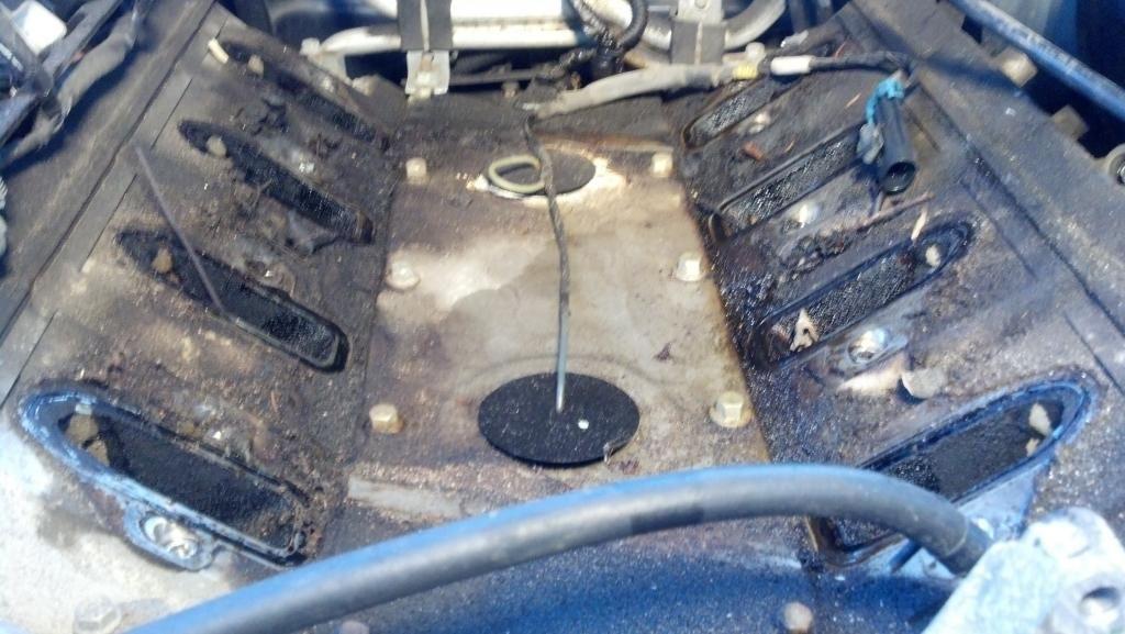

Old Aug 6, 2017 | 10:12 PM
Paul Bell's Avatar
That's MISTER MODERATOR
iTrader: (9)
Joined: Nov 2005
Posts: 7,615
Likes: 65
From: NYC
Let's hope there's no surprises when you get it off.
I'm hoping mine looks like that! It'll give me something to do lol also got an egr delete so I wanna take the intake off after 40k miles to see if there's a difference cleanliness wise. I only have 40274 miles on mine right now did the delete right at 40k
