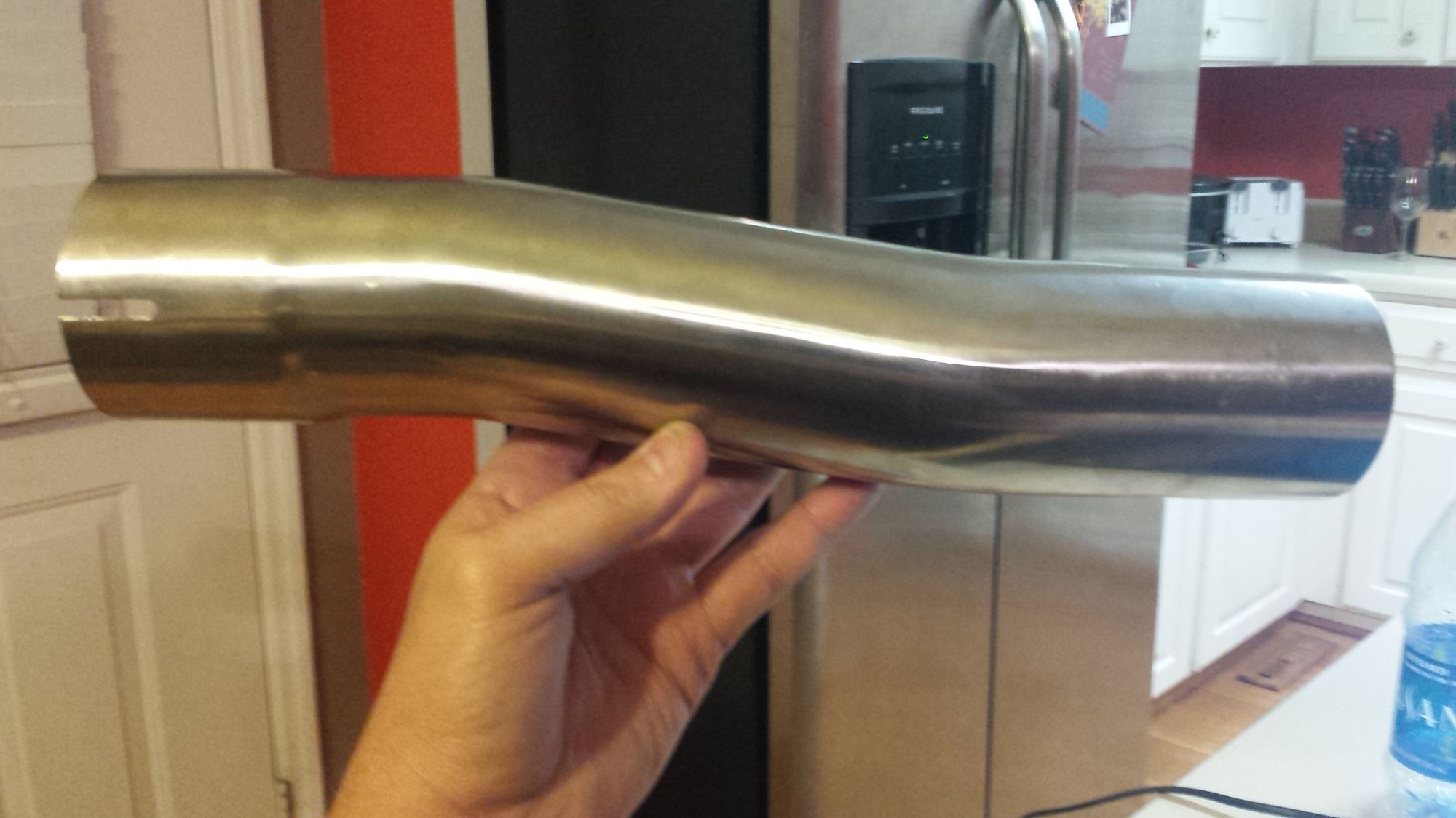

Explain to me how rotating this piece of pipe is going to position the pipe higher than the lowest part of the headers "WITHOUT" ******* up the angle of the end of the pipe that connects to the y pipe?

And notice that the end that connects to the headers I am holding straight.
TSP y pipe is not "smashed" anywhere and it doesn't dip down off the header and it doesnt hit the floor of the car. It is smoothly ovalized. So whether you wanna call it oval, smashed, clearanced, ...however you want to wordsmith it just fix it already. 3" of ground clearance is too low. Thats what a car with modest lowering springs is gonna have.

Our Y-Pipe is slip fit at every connection, and yes you can rotate the pipe up and down without affecting the rear exit location. We have installed it that way for several years now.
I am honestly not sure how the new design TSP Y-Pipe fits. I am simply referencing that we have never had any issues with our Y-Pipe fitment to our knowledge. If there was an issue we would have revised it a long time ago. We revised both truck Y-Pipes to improve fitment/clearance, but have never run across a reason to revise our LS1 Y-Pipe minus the fact that a few guys want to oval the drivers side pipe for lowered vehicles.
Thanks
Sean
I had to make a slice and bend it to make it fit/clearance correctly, right in in the middle where your are holding it.

Let me clarify something. The SE headers and y pipe are good quality. They "fit good". The ground clearance is just **** because of that spot right at my pinky finger in the above picture due to the bend further up the pipe that drops down off the header. Yes you can rotate the pipe up and down and the rear part of the pipe will move up and down but that spot at my pinky finger barely moves at all.
If you use the o2 bung on the pipe in the picture above as the reference point, the y pipe fits best when its straight or 3:00 position. If you rotate it counterclockwise to where the o2 bung is say at the 1 or 2:00 position it moves the rear of the pipe up but also moves it sideways toward the passenger side of the car because of that spot where my pinky is. You can actually get the rear of the pipe so high it hits the car but that pesky spot where my finger is will still be the Achilles heel with ground clearance.
