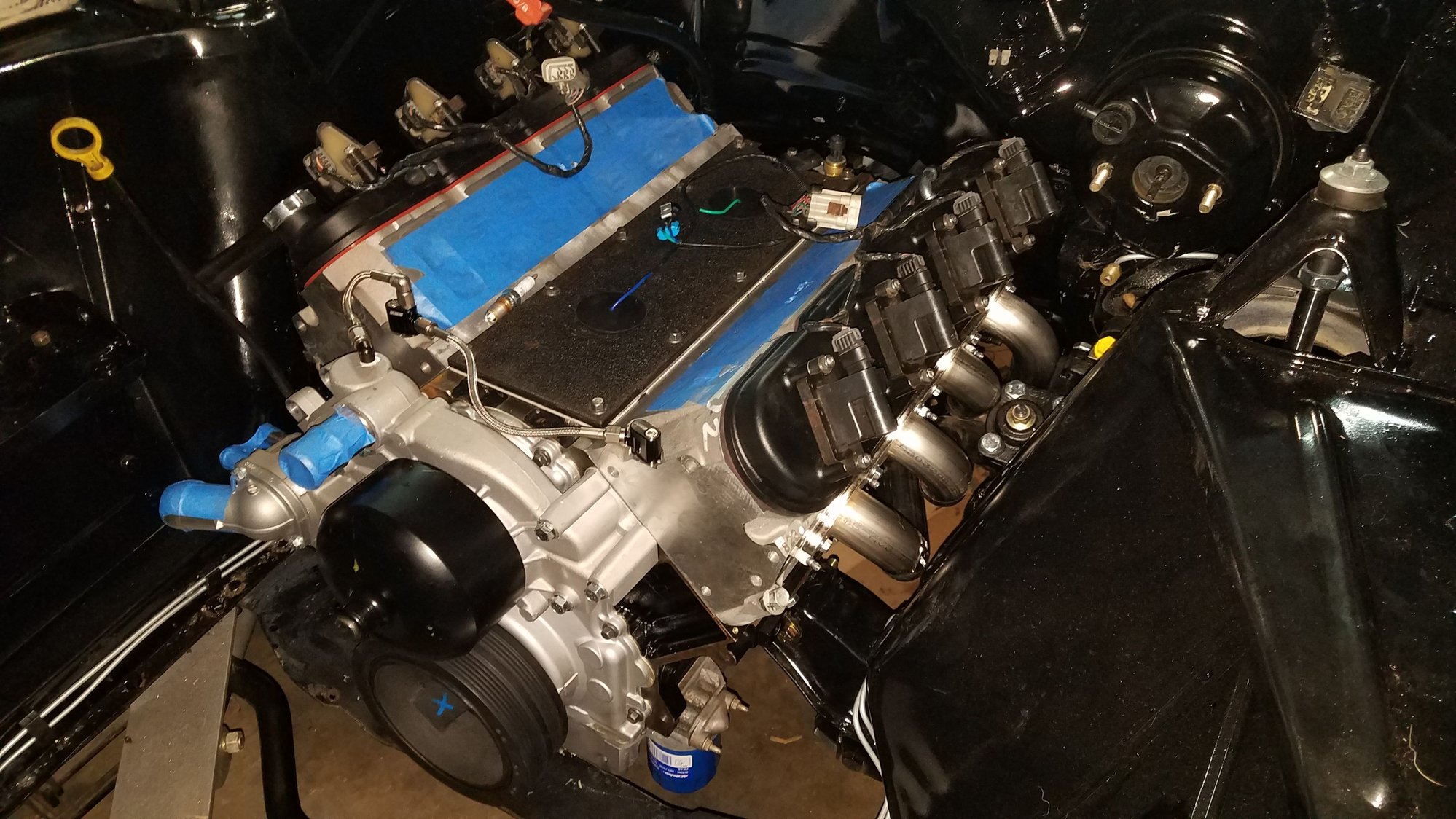

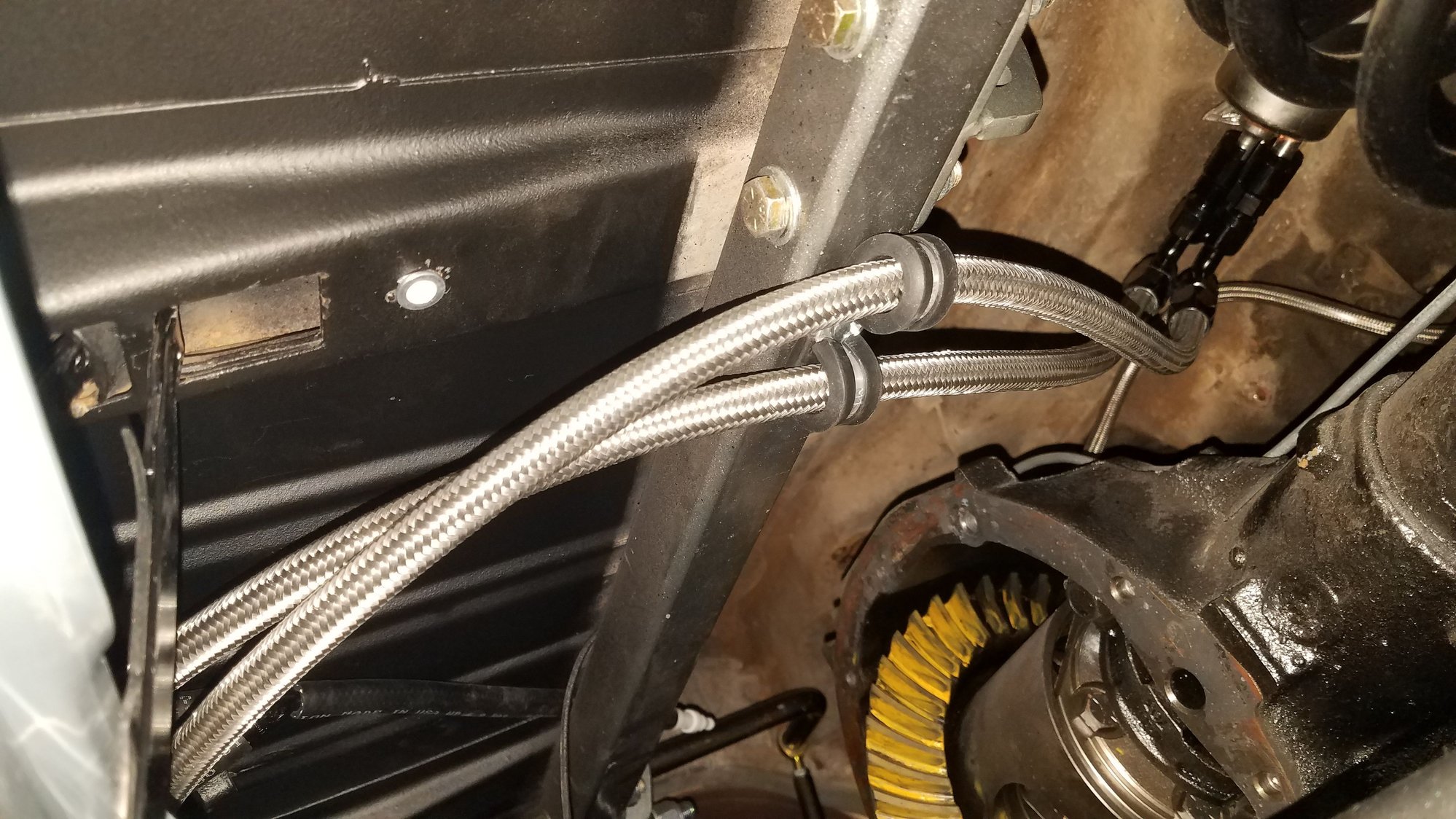

I live in sh1tty... I mean sunny California. So I won't see low temps, but higher temps are the norm in summer. I'm more concerned with altitude changes... I think. We go to Reno petty often, which makes carbs tough.
I just got the engine in. I'm plumbing the fuel system today and want to wire it soon. Should be ready to fire in a few weeks if all goes well. The goal is to get it drivable for Hot August Nights this year. The wife had never been and it would be much more enjoyable with a car there.
