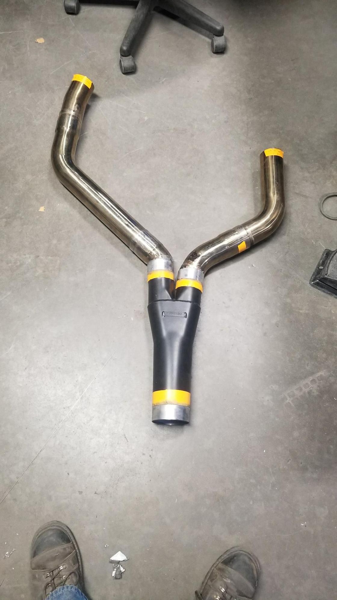

Here is a picture of the merger welded in
Thanks for the pic!!!! Man that looks much better.
