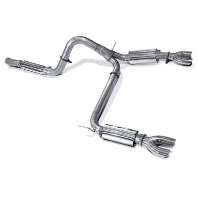

I have an SLP Loudmouth 2 I'm ready to bolt on, but I know it will be too loud after a H/C install. Has anyone found any exhaust inserts that actually quiet down the exhaust? I don't care if I lose a bit of power from it, but it would be great to drop a few db for cruising.

To loud? What will the rest of the exhaust be?

Long tubes, no cats, mid 230s exhaust cam on a 112 LSA. Loud is happening no matter what, I just want to be able to take this on weekend road trips without going deaf.

You could sell that SLP bullet and try a Magnaflow bullet. Still loud but a bit less raspy and a bit deeper

This is a solid idea. Not sure I'd add inserts in fear of losing too much flow. Replacing the SLP resonator with the Magnaflow or Borla bullet style muffler would be my choice. Google Borlamouth or Magnamouth to see what we're talking about.

I just put a flopro twister 41227 on my car after doing long tube headers and had a lm2, got the twister put on where the lm2 muffler was and it made it great to live with. The problem is that it now drones again, with the LT and LM2 it didnt drone but it was just stupid loud, i feel like trying the magnaflow.

I am tossing some very short bullets into the back of the car to tone the exhaust, and replacing the LM2 with a cutout. I was hoping I could install some kind of pipe insert to help reduce the volume a bit, since I'm not super concerned about flow behind the cutout.
Also I've seen the borlamouth, and that would be my preference, but if I use a bullet, there won't be any room for my cutout

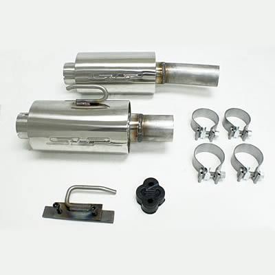

It's not cheap but the best sounding and performing option is the SLP Powerflo conversion that attaches to your existing system.
I have used the moroso spiral flow and flopro twister mufflers before and they sound great but rob the hell out of power.

I already have the system, and will be modifying the mufflers. I'm more interested in anyone's experience with muffler inserts and how quiet they can make the exhaust

I had a loudmouth 2 on my car. When I put a cam in it, omg it was loud. Even with high flow cats. Honestly the mufflers (if you wanna call them that) flow like ****. If you look inside them you will see why. There’s no smooth flow path, it’s like a chamber with a tube and the exhaust has to fight to get out of it. My advice is ditch them and find some better mufflers that fit. Anything would likely be better. There’s no muffling to that “muffler”.
The flopro robbed power? According to them it flows 20cfm less then a straight pipe...thats why I put mine on. Maybe I need a cut out for the track.
