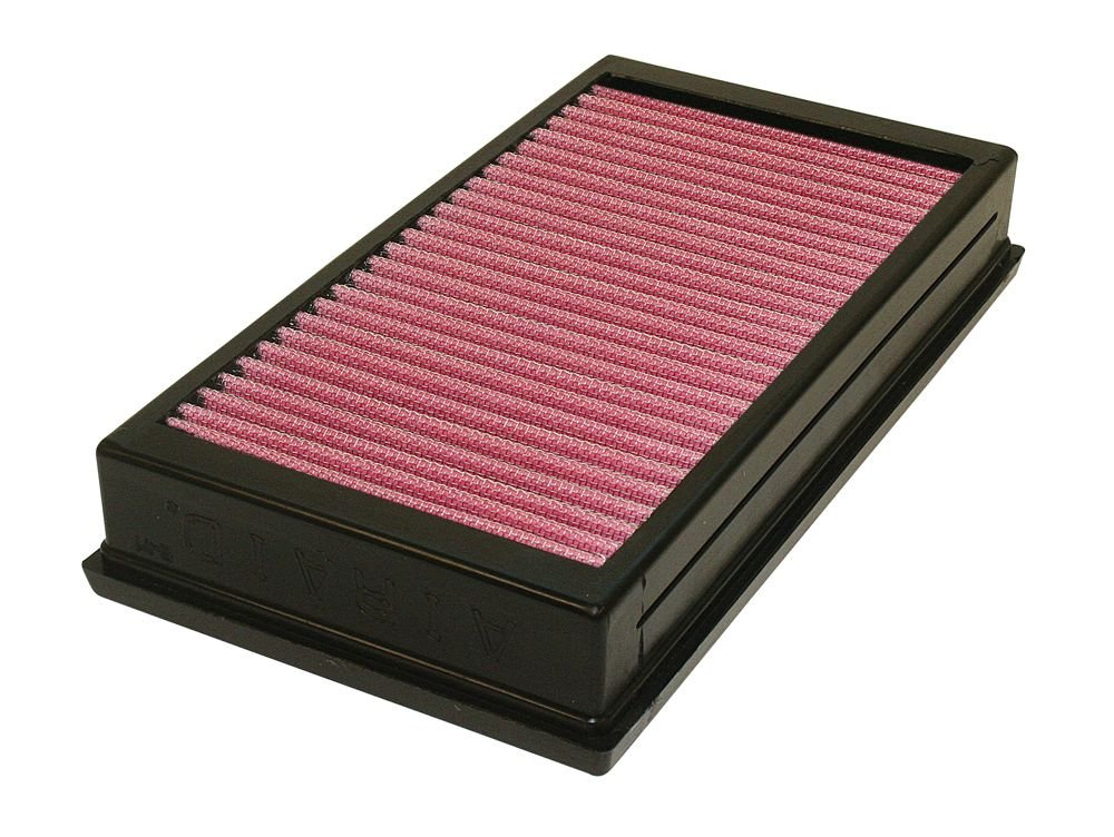

Not cheap but I think AIRAID is making some of the best filters on the market now. You can get them in oiled or dry versions. I got dry.
As soon as you take it out of the box you can tell its something special. The filter assembly or whatever you wanna call it is much more superior to the K&N.
I was sold when I watched the guys at engine masters test a handful of the AIRAID filters on aa 750+HP LS motor that was forced induction. They were sure when they stuck the filter on it was going to make less boost and kill power. It lost 1 hp and gained 3 torque. Within margin of error, so the engine didnt care if the filter was on it or not. They said the star of the show was those damn AIRAID filters. They just couldn't believe the engine made the same power with or without it.
Gonna set you back nearly 100 bucks after shipping
