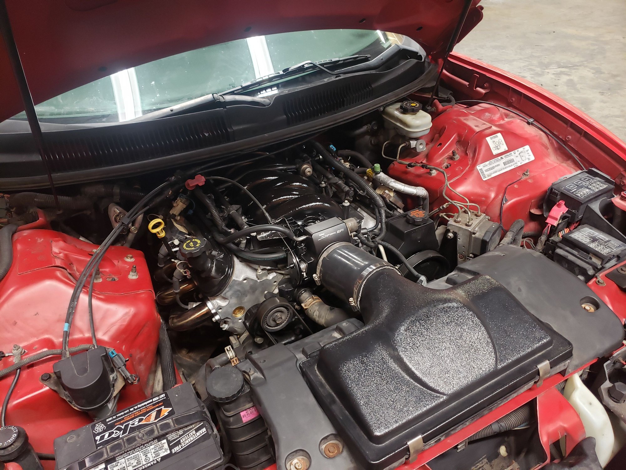

it looks like your coupler between the lid and MAF takes a little downward jog....but not so much it cant handle
is that MAF shorter ?
and the cooler leaks coolant into the P/S system contaminating everything....not a question of if...but when.....so be proactive and take it out....plenty of threads about it here.....that turn 1 pump is to $$$$ to ruin ( i have one too )
looked up that MAF.....looks like the one SLP used to sell
I guess I can't give exact measurements as I don't have another one to compare. Just from the picture it does look a little shorter though.
Hey thanks for that word on the cooler. Never had a problem & guess just never came across it. I will def take it out now. To remove even the chance of the fluids mixing. Thanks again & hope you get your induction squared away good.

Fast 92/92 to ftp 105mm lid

looks like the FTP lids are the hot ticket.........
